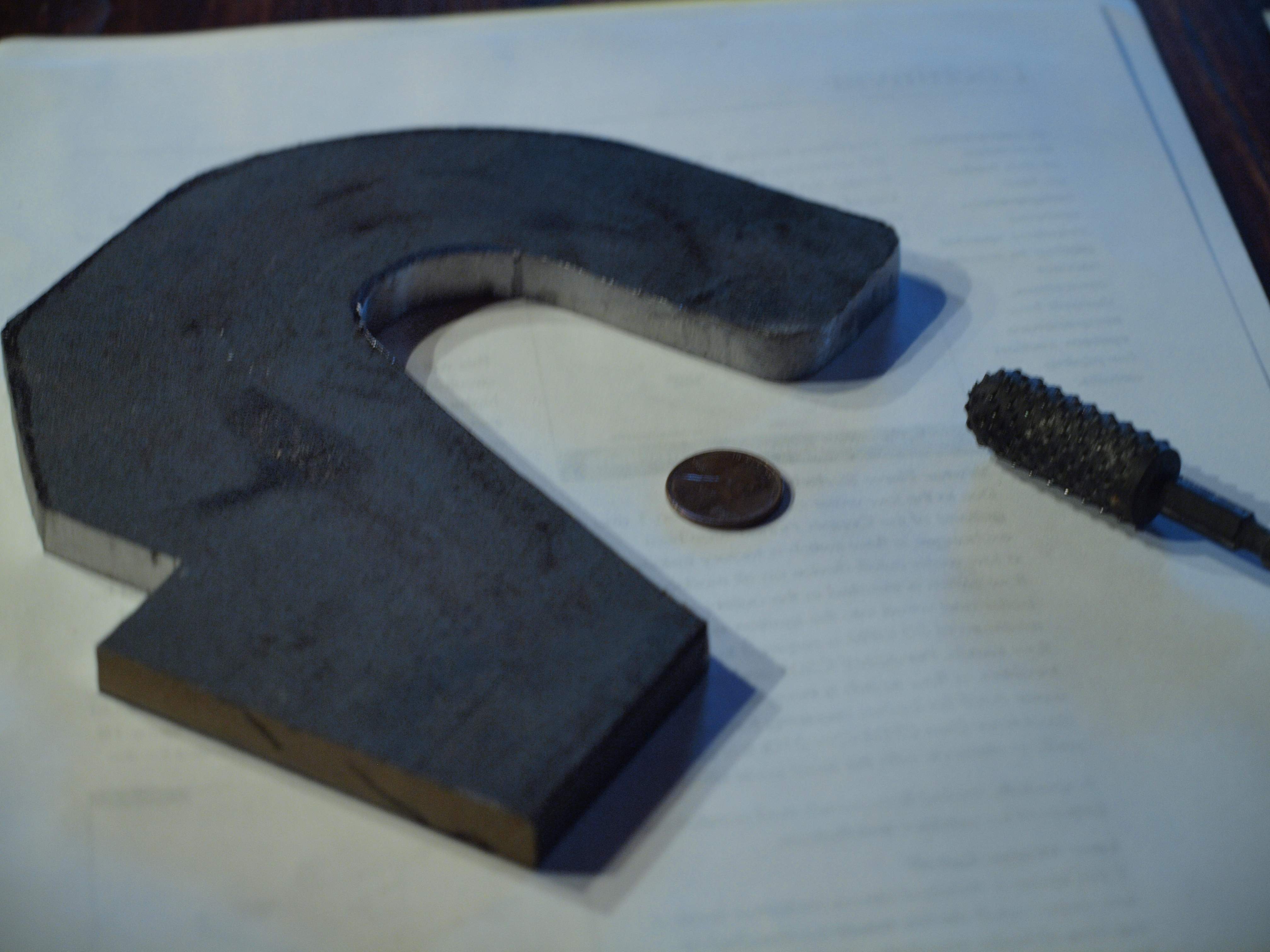

What is a good tool to smooth out a 1 1/8" inside radius cuts made with a torch in 3/8 metal plate? Hand filing is getting old rather quickly. Do not have a drill press able to handle this diameter.
/ radius cut smoothing #3
I agree with the roto Carbide burr. Double cut. Next would be a flap wheel on the die grinder.
Went to Lowes and picked up this Kobalt tool as it was the only rotary tool I could find there. It worked best at slow speed in a variable speed drill. Took about 5 minutes so its slow but gets the job done. As they are only about 4 bucks, I could by several to finish th job. They also work plastics and wood of course.
Thanks for your advise.
Five minutes doesn't seem slow to me, for what you're grinding there. What are you making, a quick-hitch?
5 minutes was to finish up the hack job I did with the file which did most of the rough work. (over a half hour) They are brackets to go on top of a loader bucket to hold bar type forks. This way I can load and unload the forks w/o getting off the tractor as I have only a pin type mount for the bucket. The torch was used only for the radius as I could not get in there with the sabre saw. The right drill press would have eliminated this problem all together.

A holesaw? They have that for metal this thick? When at Lowes, I did see this drill attachment that had 4 carbide teeth welded to a collar. Didn't know what it was for but it looks as if a good drill press was needed.

The best tool for that is a high speed die grinder with a carbide burring tool. I have several of different configurations and diameters that I use with my high speed drills since I burned up my die grinder and havent replaced it yet. They work best at high speeds and light pressure rather than the low and medium speed with likely lots of pressure as you were using on the drill. Since my die grinder burned up, I havent found enough instances of needing it to replace it. Maybe Harbor Freight will have one on sale soon.
