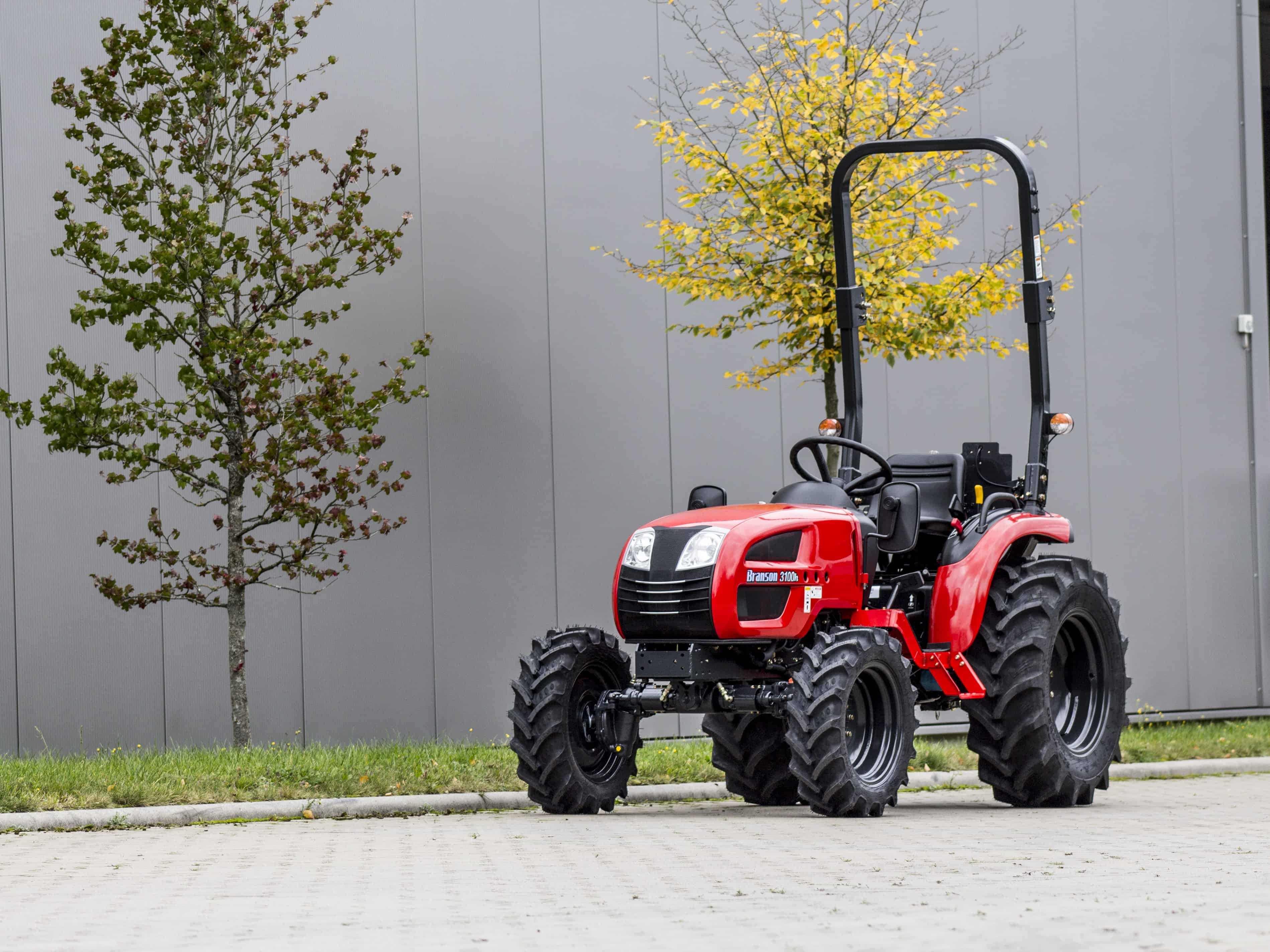

If there ever was a question, I have proven it on my 2400. Bought it with R4s, replaced with R3s, and now have R1s on the rear and traction is night and day and I removed a pair (had 2 pair now only 1) of rear weights I used on the 1s and 3s. Other thing is that I can run 10 psi (for a softer ride) with the R1s and the 3s and 4s would slip on the rim at that air pressure.

Well that's simple enough. Going by main use, it's Ag R1's for traction in the field, Turf R3s for the lawn, and Industrial R4s for a compromise.
So is it best traction? Least damage? Or compromise? At least we get a choice.
As for use on slopes, well.... I prefer not to be there at all. Though if I have to go there I'll go with R3 turf tires. Not because turfs are so wonderful on slopes, but because both the other choices are worse - being narrower, higher, and with less side resistance.
BTW, I run 8 to 12 lbs pressure in the rears, work them hard, and never have had a tire slip on a rim.
