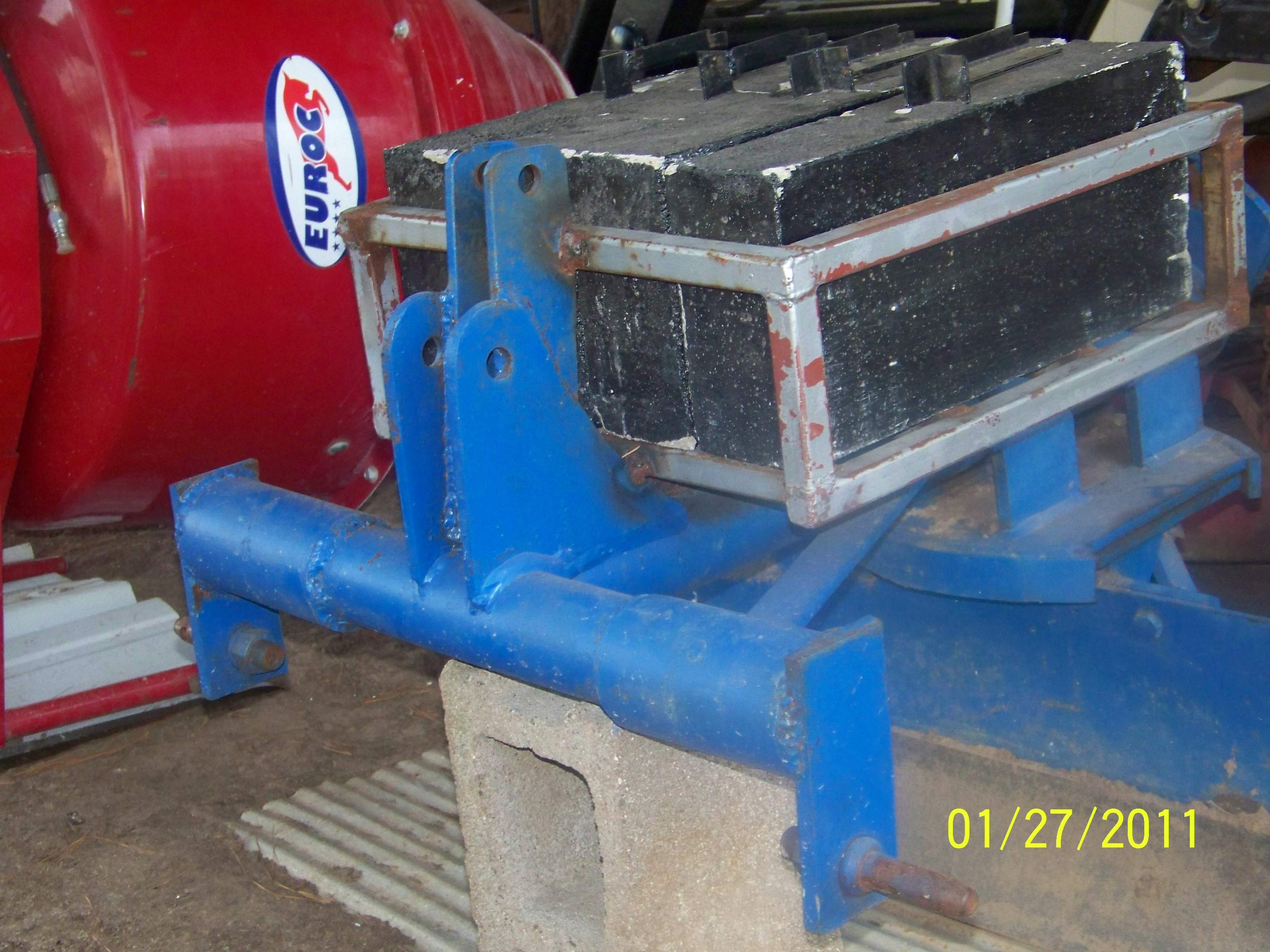

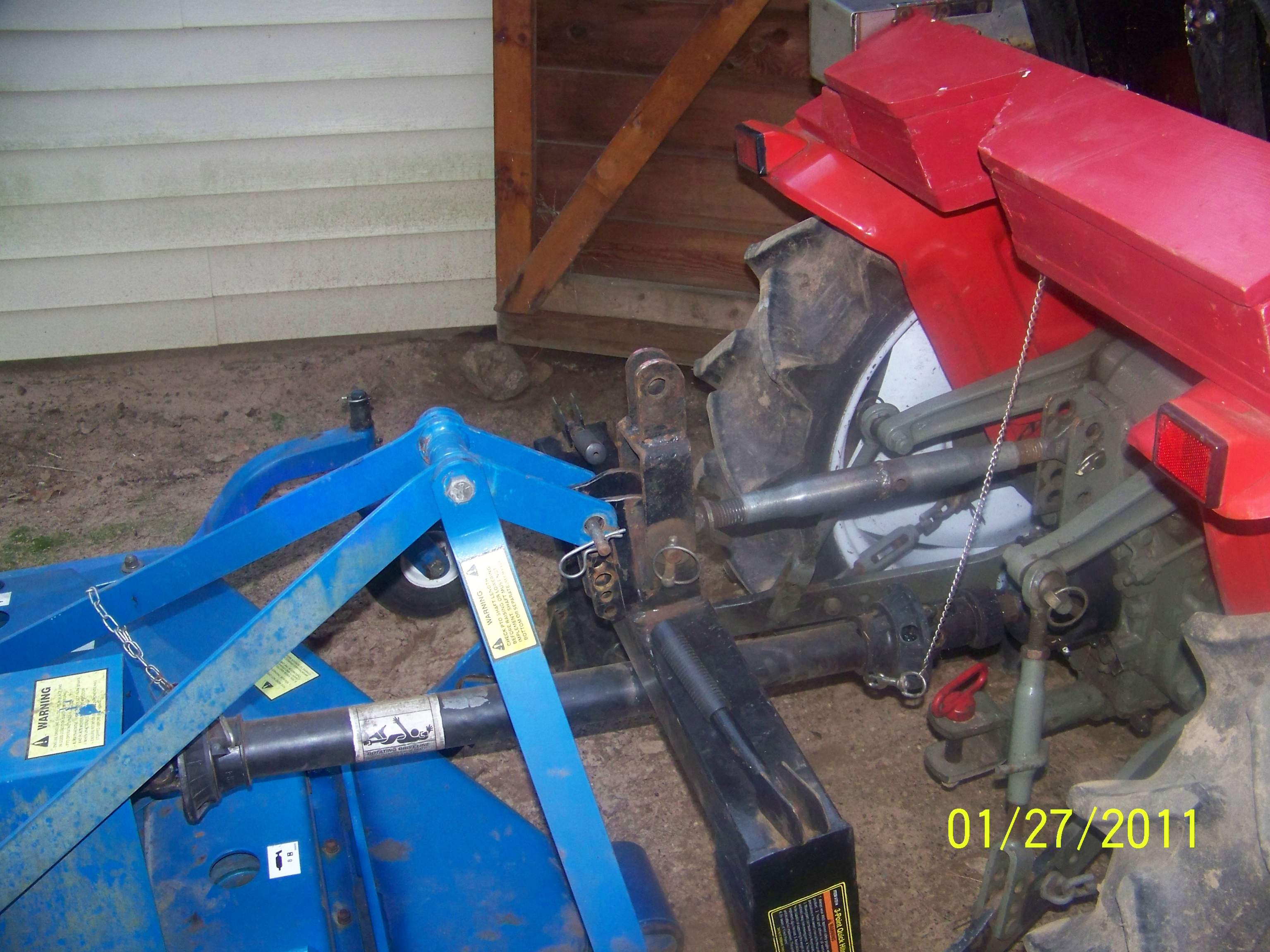

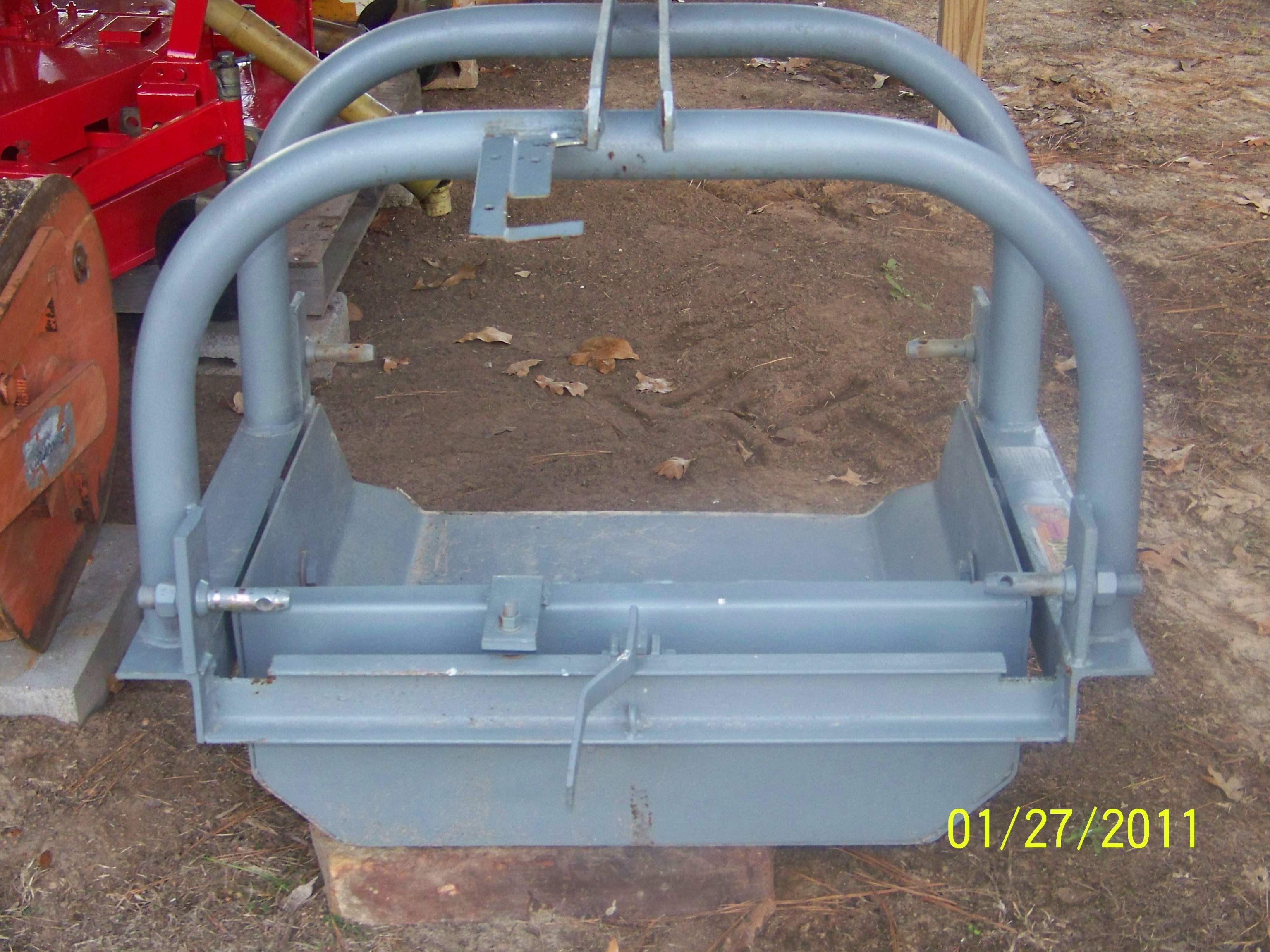

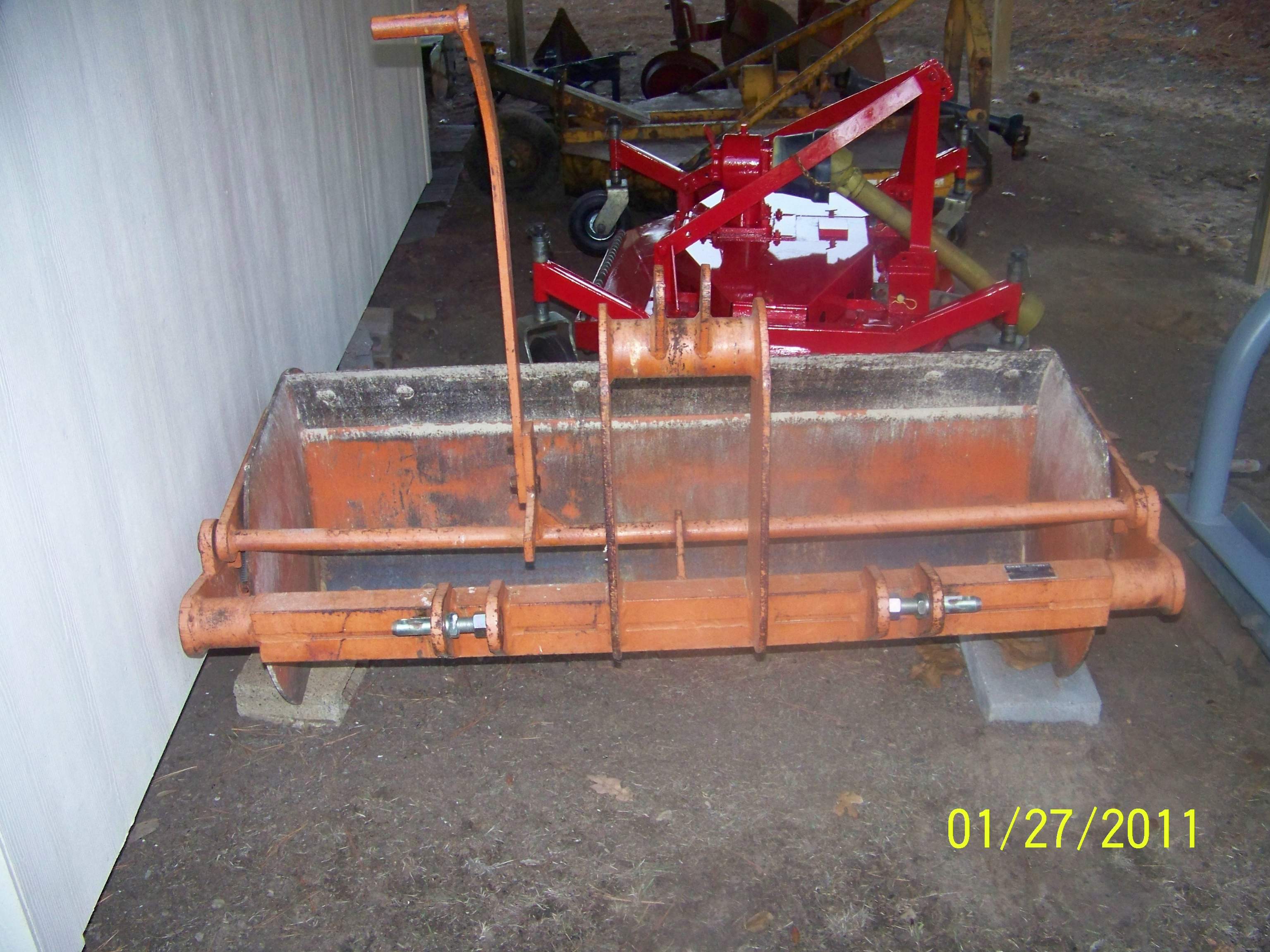

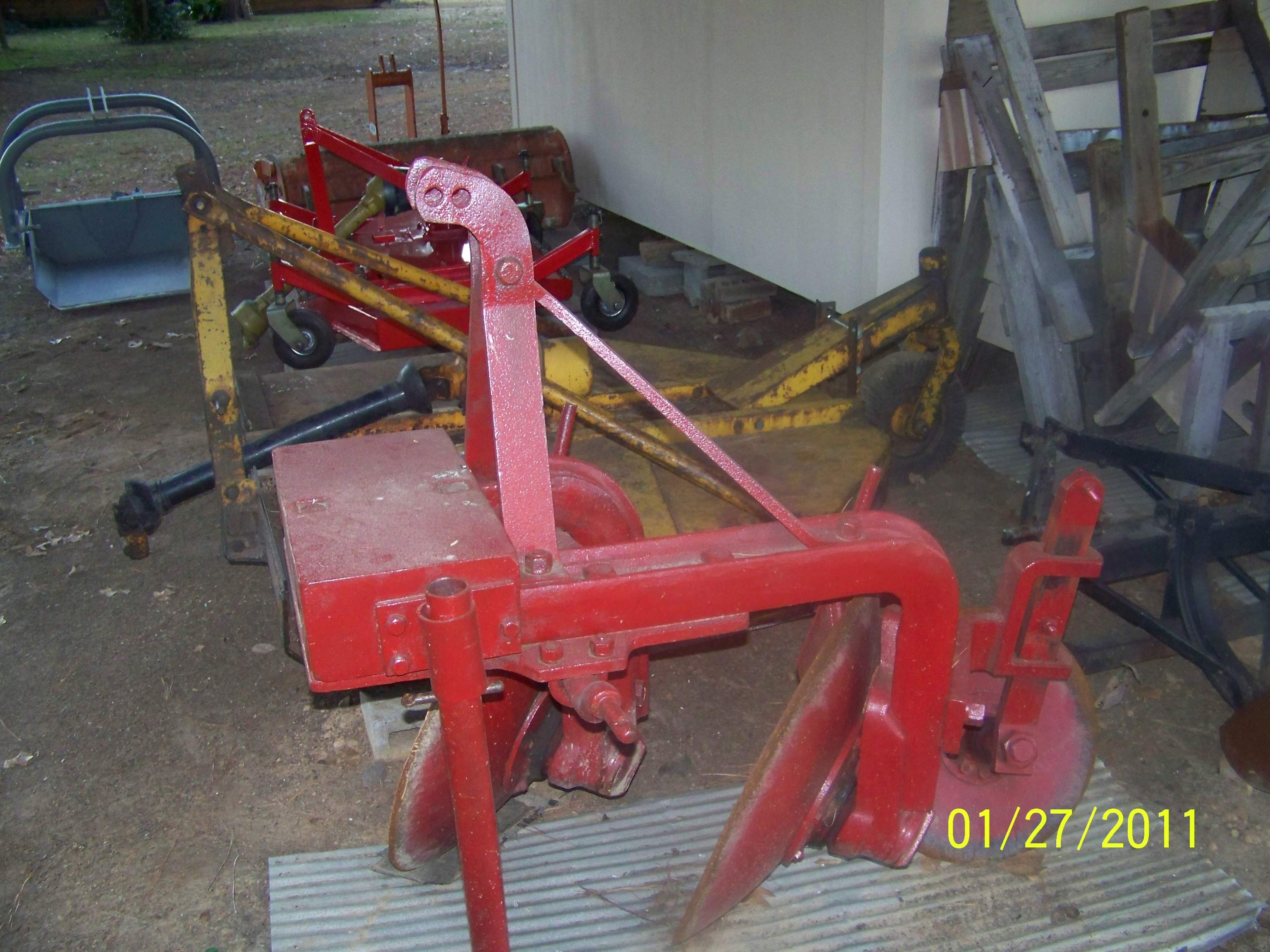

At California's suggestion I'll start a new thread on an old subject. A few pictures and explanations of modifications to make my Harbor Freight quick hitch work for me. First is the swivel adapter I fabricated, Harbor Freight sells them, their sight is down so I can't post a picture of theirs. It is standing straight up and not used with this mower. Next is a picture of my Gannon box blade and pins extended out to achieve proper width. Also, in the background is a red finish mower that has had the top swivel shortened and re drilled to accommodate the home made swivel. Next is a picture of my little 4' scraper blade. It was a category 0 so I had to make radical changes to make it work. It is heavy made and has the rollover feature and was cheap. That is why I have it. Next is my old Dearborn turning plow. I put a pin hole closer to the end of top link connection to accommodate the swivel adapter. Actually did this on several implements. Last is my dirt scoop. I had to notch out a little of the channel iron right below the pins to allow the quick hitch to go under the pins. The only implement I have that I cannot use with the quick hitch is my Yanmar RS1300 tiller. I do not use the top hook that came with the quick hitch.

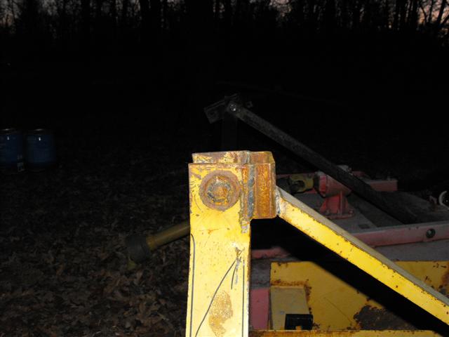

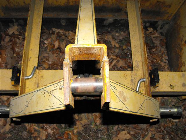

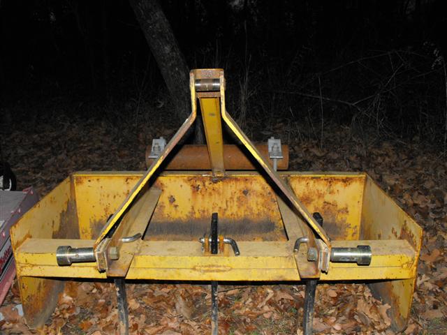

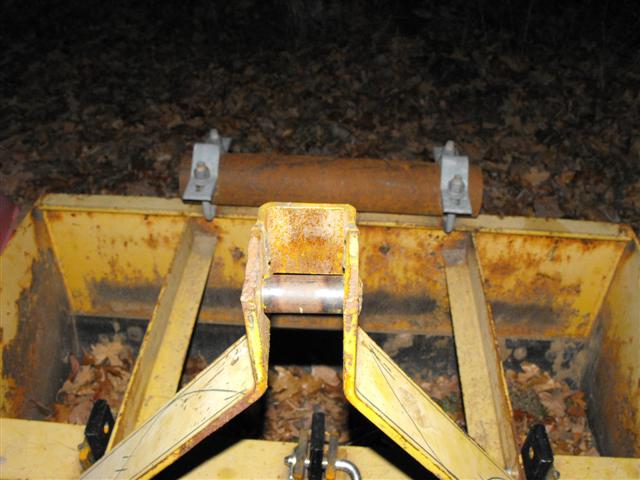

Here's what I did for the box blade. The brace bar was originally welded in between the upright bars and a bolt in the top for the top link. This worked well and now I don't have to touch anything to hook it up. I made the top pin and welded it in place.

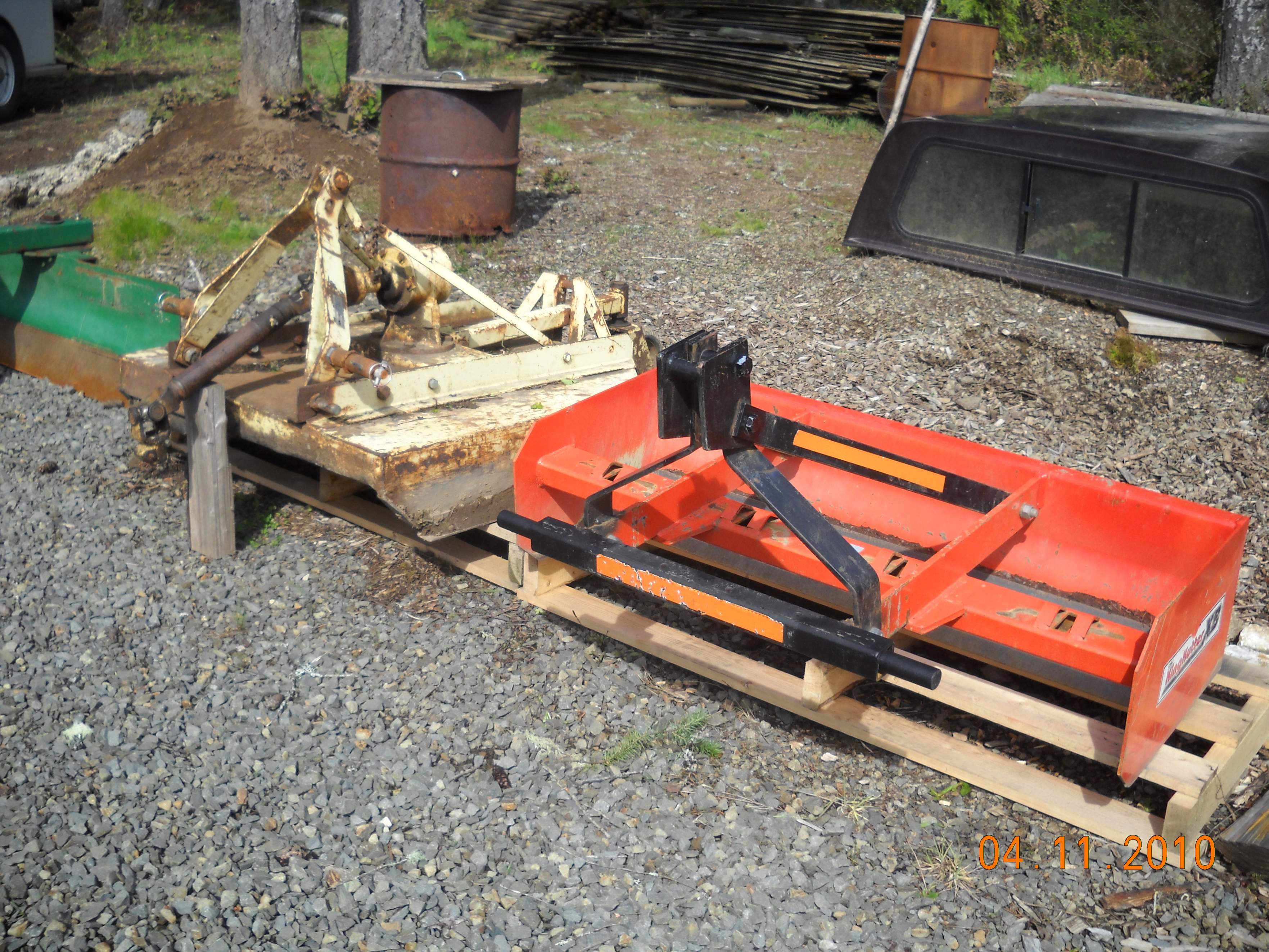

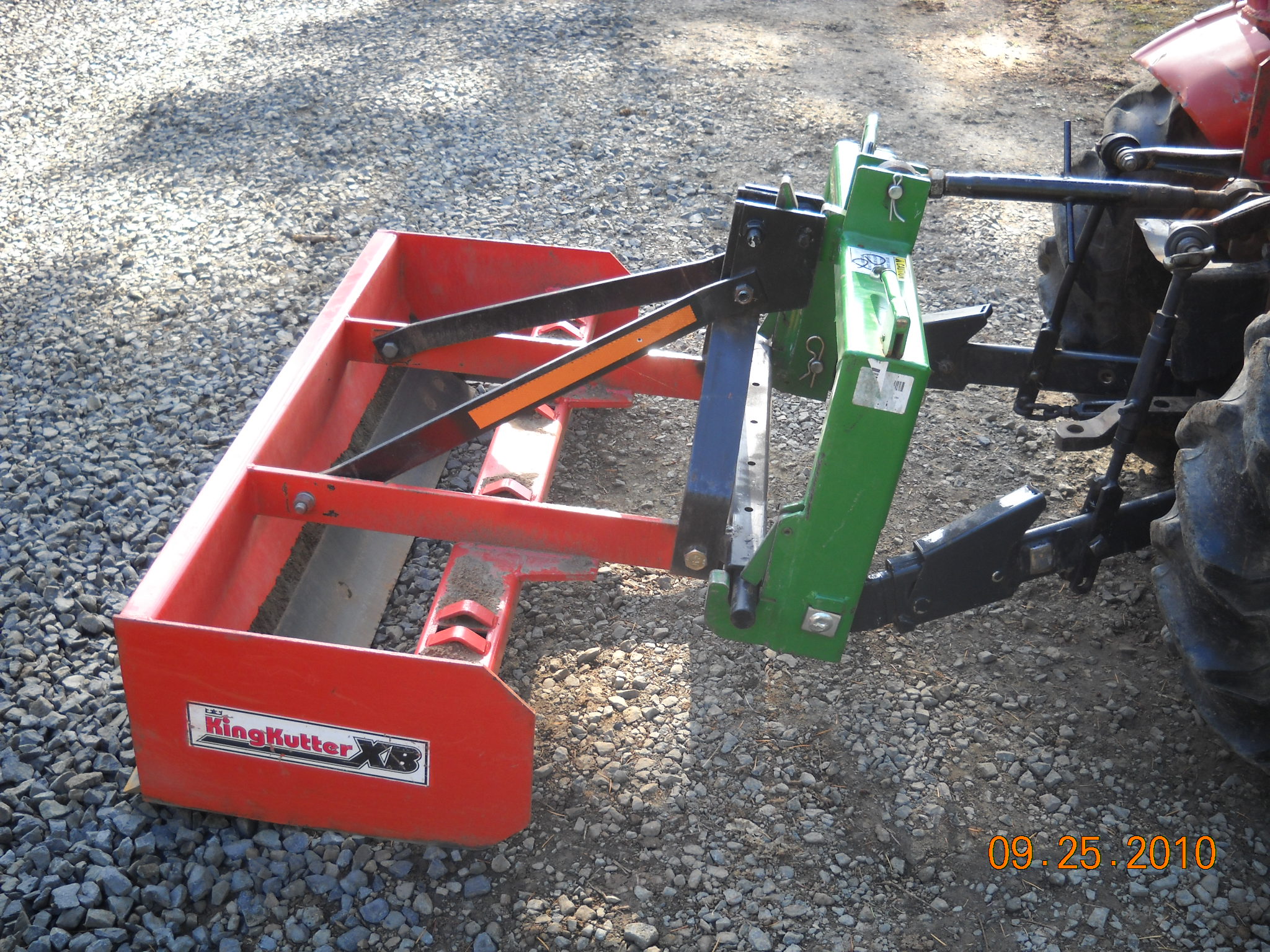

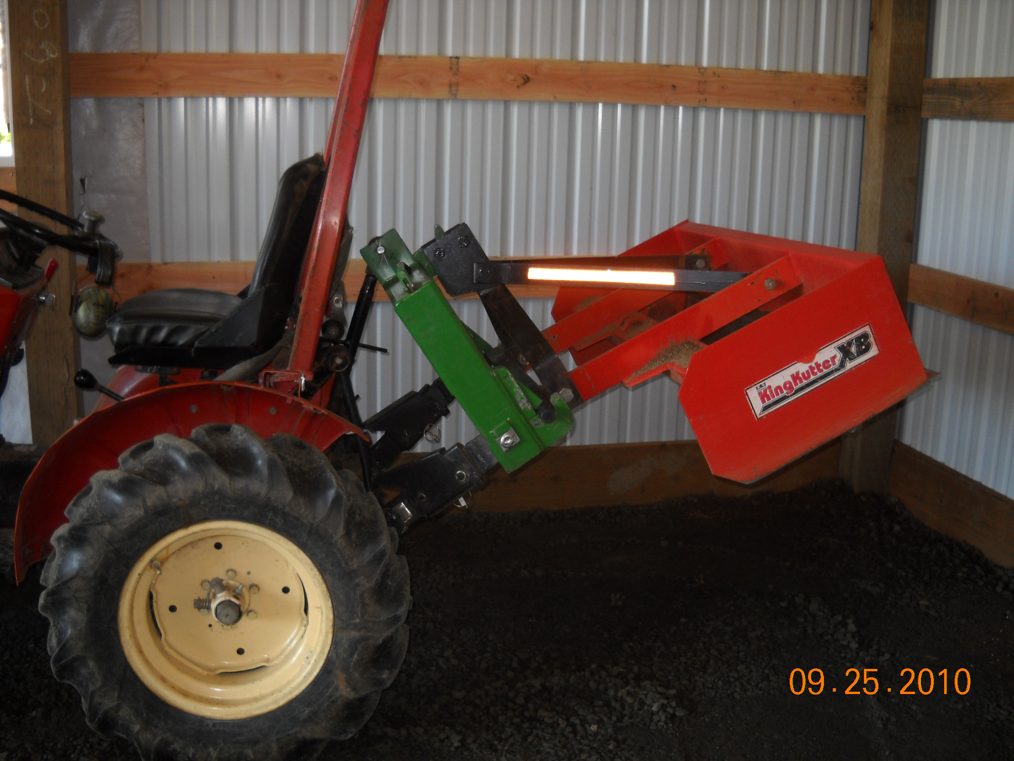

I have only had to modify 3 of my implements to fit my imatch quick hitch. My box blade is only imatch compatible due to the modifications but I will always have a quick hitch so its no big deal. My brush hog was as simple as putting another set of thicker pins with welded on bushings and my harrow was as simple as adding a new top link slot and a new pin. I also added telescopic lower links to my 169D for my post hole digger, that's how I lifted my box blade so high, having that extra few inches is great, i just need to fine tune the sway chains so that when i lift stuff all the way up the lift arms wont rub the walls of my tires.
