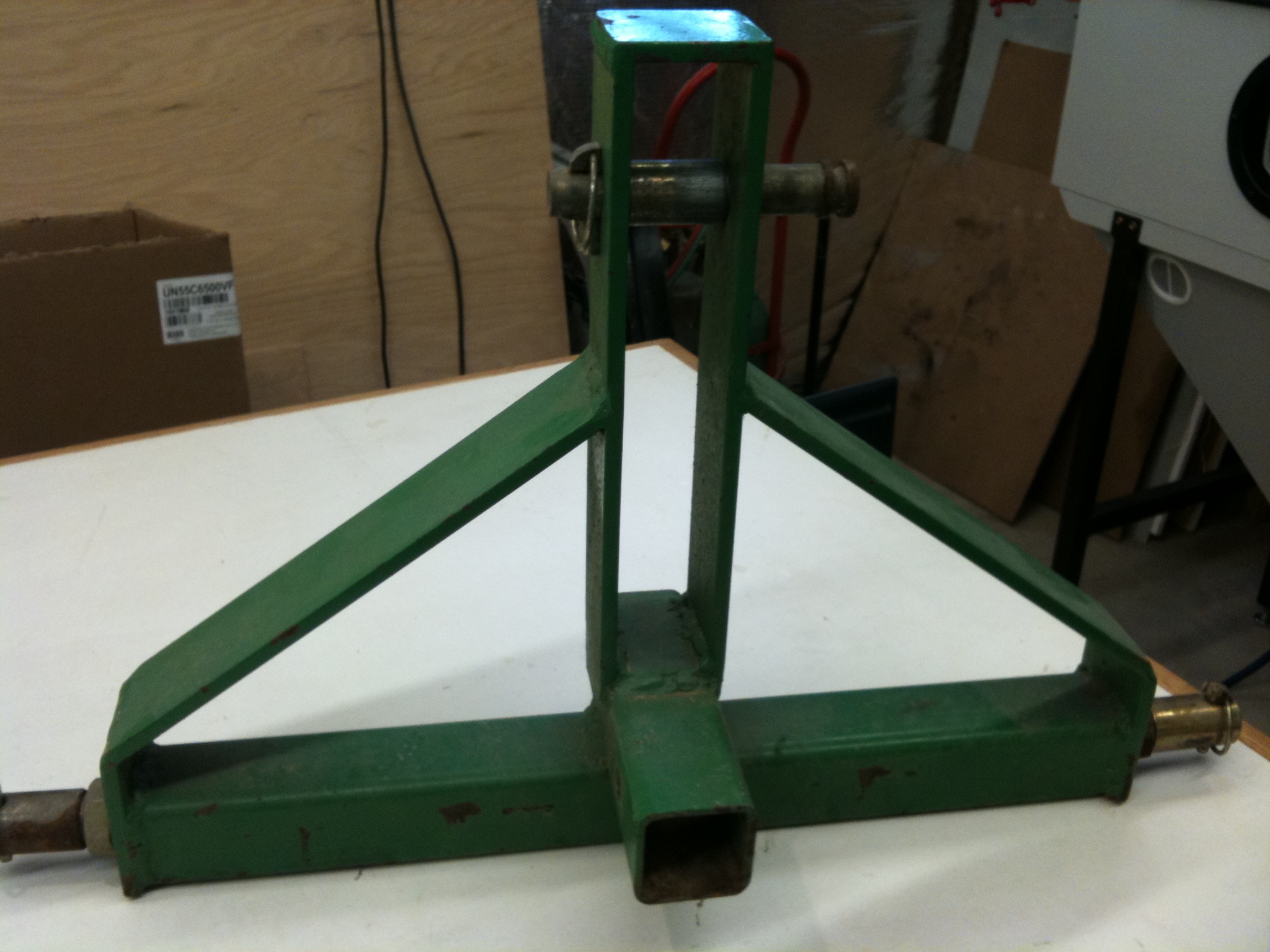

/ Quick Hitch to trailer adaptor? #7
I made a couple of these using a pre-made receiver, drawbar from TSC and a couple of pieces of angle iron.

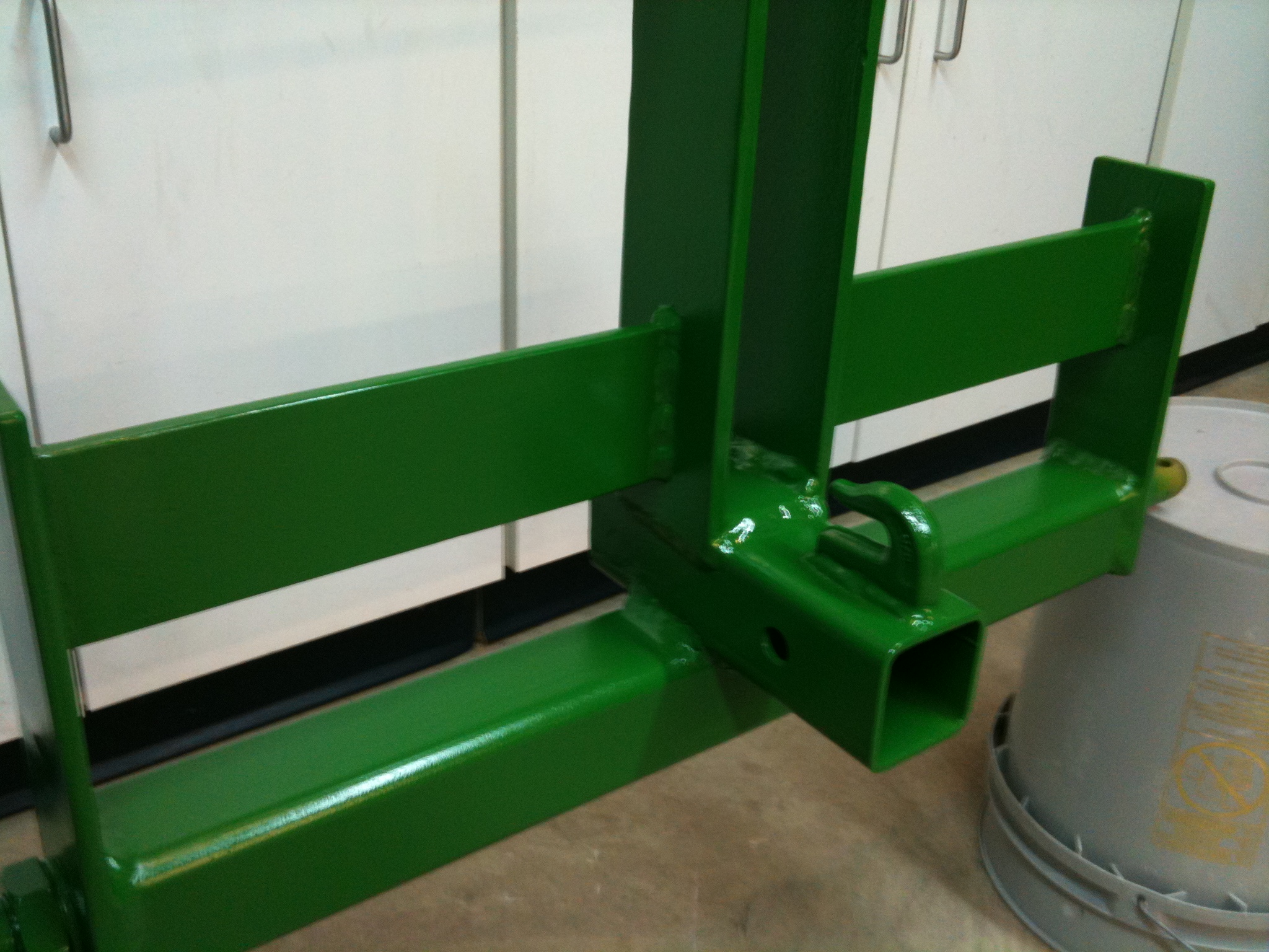

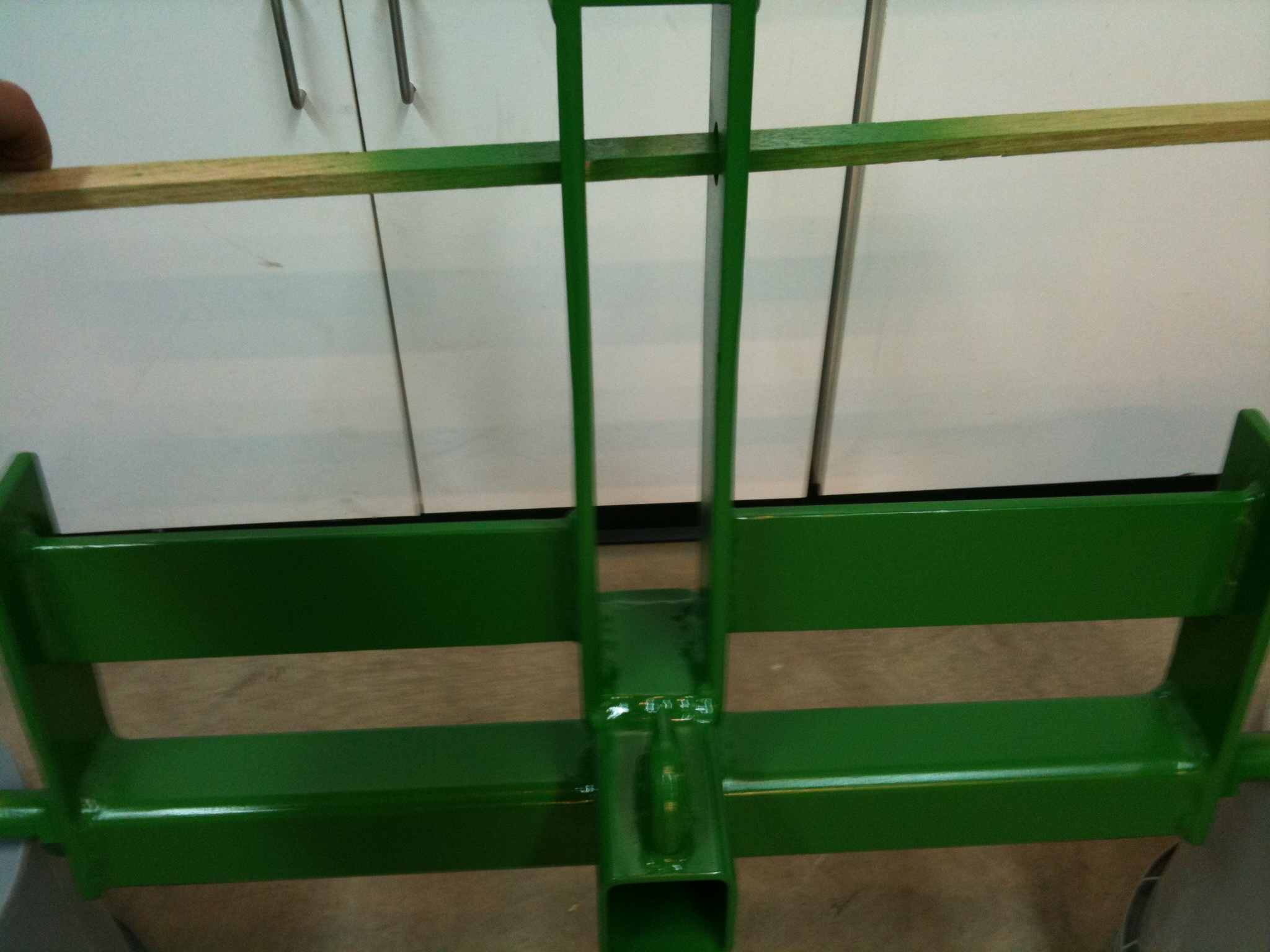

/ Quick Hitch to trailer adaptor? #8
I have no "plans", I just eyeballed everything. The first picture is how I built it the first time, the second and third is after I re-did it to hold suitcase weights.

/ Quick Hitch to trailer adaptor? #9
"Thumbs up" on the suitcase weight holder, Kenny.
/ Quick Hitch to trailer adaptor? #11
Runner, are you using those brackets on each side for the trailer safety chain?
/ Quick Hitch to trailer adaptor? #12
Thanks, It's modeled after the Heavy Hitch
Looks good, Kenny.
What is the wall thickness of the 2" square tubing?
I assume the rest of it is made of 3/8" x 2" flat bar stock?
Thanks

/ Quick Hitch to trailer adaptor? #14
Kenny, Could you do one of those in Bobcat Orange or Charcoal so I could buy one form you. Afraid tractor would refuse to lift it if was green :laughing::laughing: Great looking hitch, I like the suitcase weight idea especially.

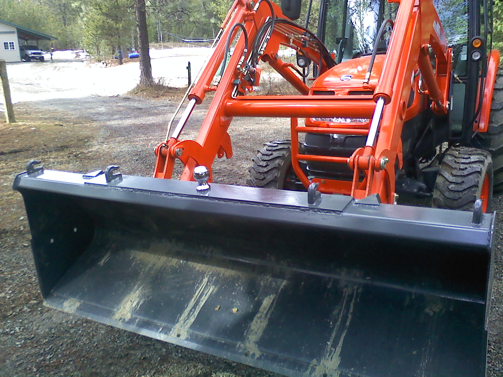

in my own humble opinion, which no one but I seam to value, i would rather go with a ball up front on the loader.
I tried the rear action, but it was harder to maneuver around obstacles.
With my loader mounted ball, i can move anything ....with amazing accuracy. I move a 29' gooseneck trailer into my 30' barn with 2" in the rear and 4" in the front and 3" on top of spare room. never get close to hitting anything.

/ Quick Hitch to trailer adaptor? #16
GRS - makes more sense to me. Having the steering axle (front) as close to the ball as possible allows you maximum maneuverability and stability. That's how tractor/trailers are designed - short tow vehicle, long trailer. There's a reason for that. Plus you get to look forward and not over your shoulder all the time...
/ Quick Hitch to trailer adaptor? #17
"Runner, are you using those brackets on each side for the trailer safety chain?"
No, those are for mounting my boom pole.

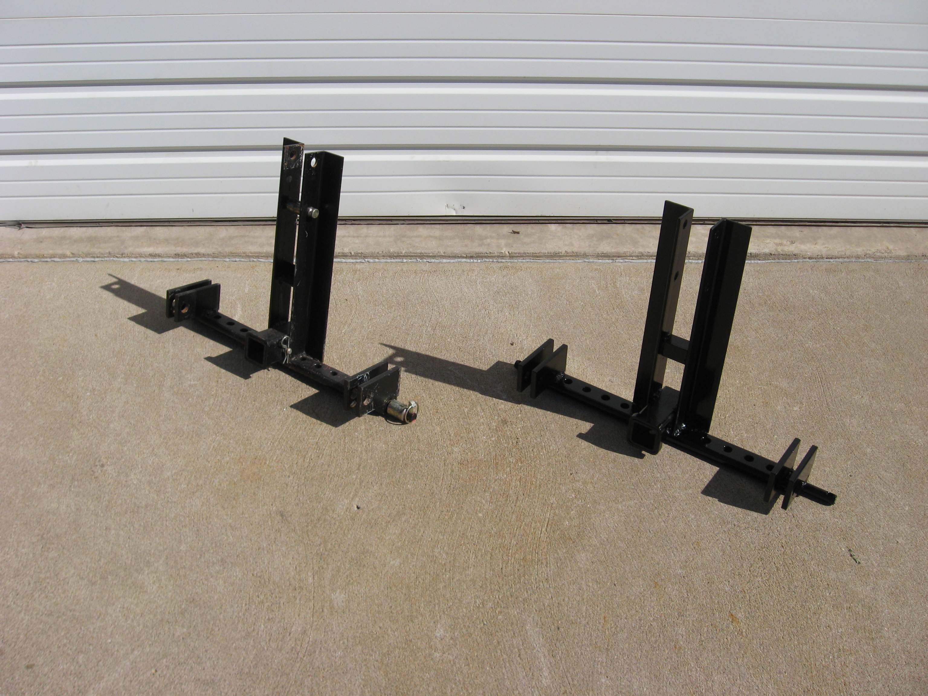

/ Quick Hitch to trailer adaptor? #18
Mine isn't pretty, but it was cheap. i bought a drawbar, welded a used receiver hitch assembly and a piece of scrap channel iron for the top link. cost was under 40 dollars. Paint would cost too much...

/ Quick Hitch to trailer adaptor? #19
Doesn't have to be pretty to work.
I may do something like that myself. :thumbsup:
/ Quick Hitch to trailer adaptor? #20
Sure, if your close!
