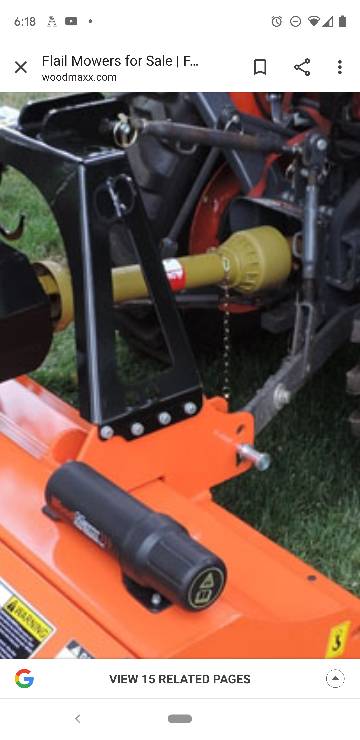

I think your solution isn't at the toplink after looking at pics on woodmax's website. It's hard to tell from a picture but if you used the upper holes on the lower arms to connect would that resolve the issue? Screenshot_20191016-061822.jpg

I’ll double check to see if that looks like mine, but I don’t believe there were multiple holes for the lowers. I don’t know that there is even enough material to drill an additional set... Good catch on the photo though!

Nope. Only one hole on mine for each lower link. Not enough steel above the holes to make additional....
I see a little bit of fabrication in my future.
