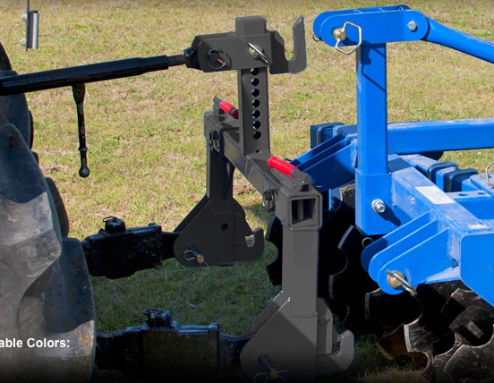

The HF quick hitch requires that all of your implements must fit its exact dimensions. Anything other than the way the hitch is built will not fit. This is a real problem with older implements. Measure the distance between lift pins to check.
Even then, the top attachment point must be exact as well. And there must not be a bar or other interference under the top link pin that might restrict access from under the attachment point.
You choices are:
>modify the implements by cutting / welding so the dimensions are exactly fit to the QH.
>take off the QH for use with non-fitting implements.
With the Pat's, just about anything will fit. Attaching the top link is a pretty minor issue IMO unless there is some physical disability involved.
Using the implements you mention, there is no reason to have to deal with the Pat's being a little bit longer than the OEM lift arms.
I have old implements made with odd dimensions and use Pat's. I tried two of the fixed style (HF) and sold them both within a week. Yes, I'm a slow learner.

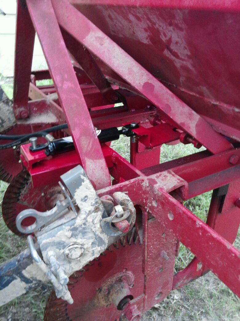

Pats and a longer Top Link- Best for different types of equipment. Easy to hook and unhook
Adds 4 inches to Lift arms

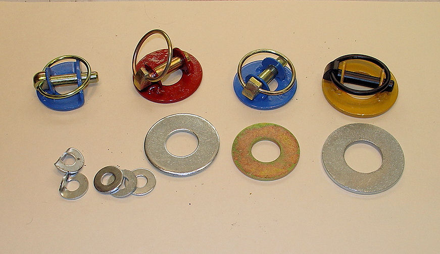

I know this will sound petty, but you might consider putting the bent part of the washer on the bottom when the lynch pin is put through the top. That way the bail can fully close. Having it slightly sprung can be asking for trouble.
Having the bent part on the bottom also allows the Pat's to come up and attach easier without hanging up on the edge of the flat washer.
You could also grind a couple of indentations on the bend to allow the bail to fully engage. And I recommend using the heavy duty lynch pins. Just watch out for your fingers!
CountyLine Lynch Pin, 7/16 in., Heavy Duty, S7913TSC - For Life Out Here
My solution was a bit more involved. These washers (below) also allow them to be left on the implement and not hang up when attaching. (A couple of OEM bent washers painted blue are shown.)
