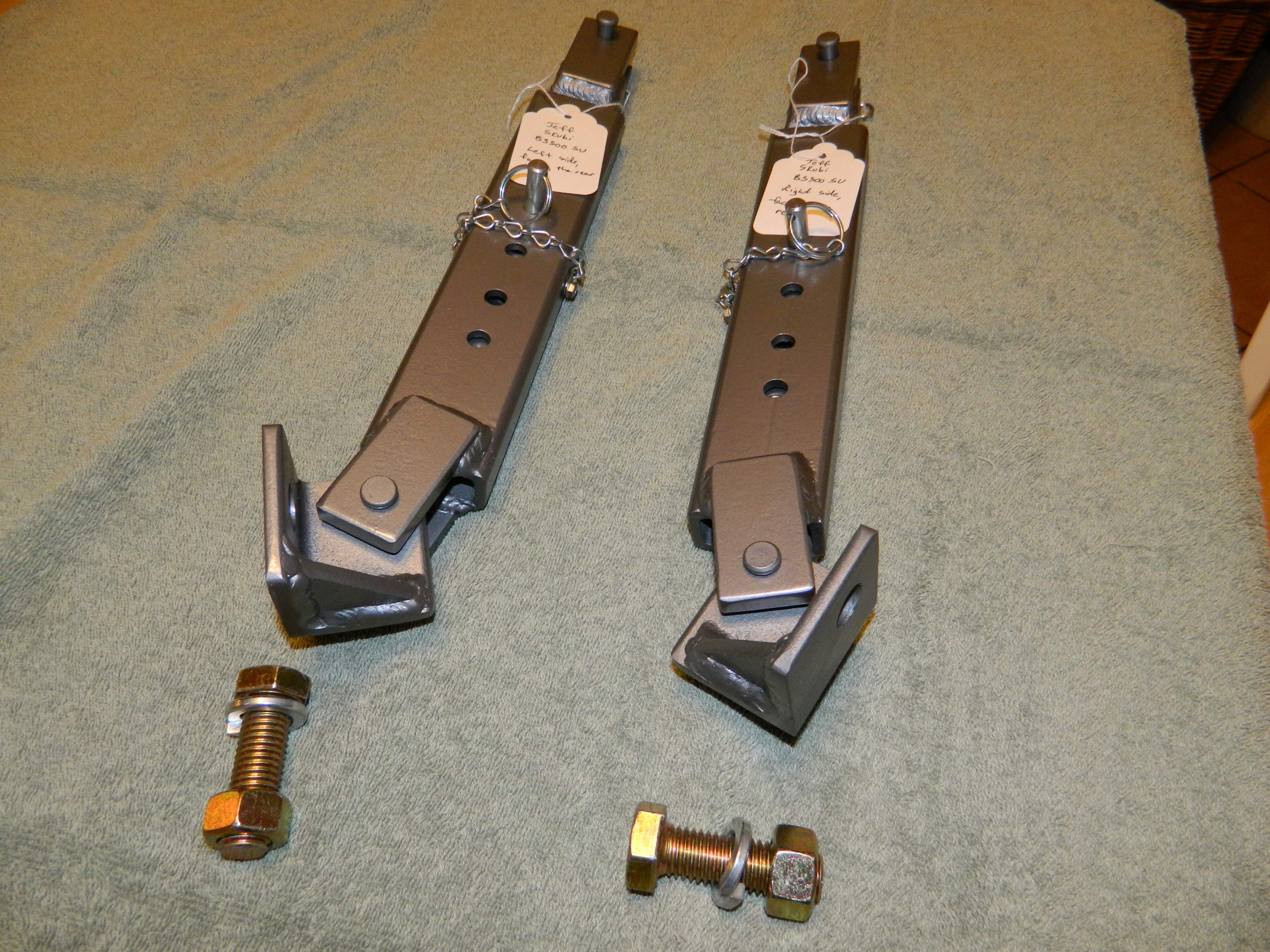

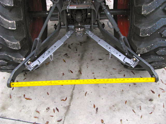

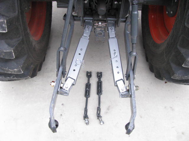

My Kubota B3300SU is near same size as your L3200. I prefer pin adjustable rigid stabilizers over Pat's.
Mine are from Stabilworks and have been excellent. <$200
Kubota tractor stabilizers Kubota [url]www.stabilworks.com - YouTube[/url]
Use the T-B-N SEARCH function keyword: Stabilworks
( DO NOT LET DEALER SHORTEN ROTARY CUTTER PTO SHAFT UNTIL YOU MAKE A DECISION ON MOUNTING OPTIONS.)
