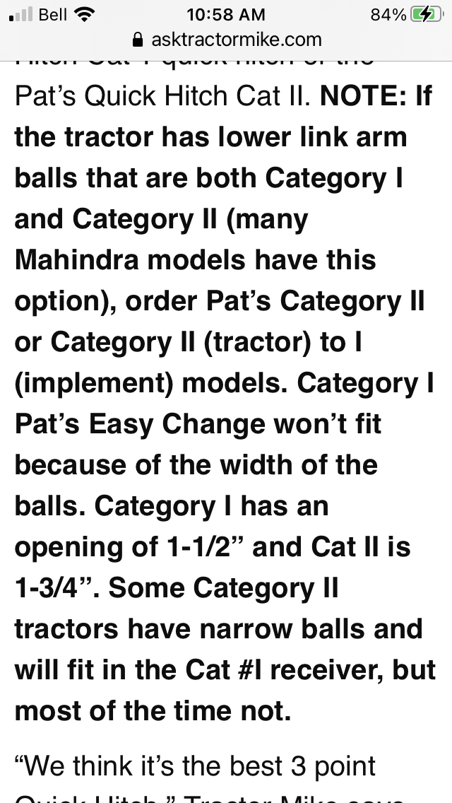

I just found this on mikes tractors. This answers the question
