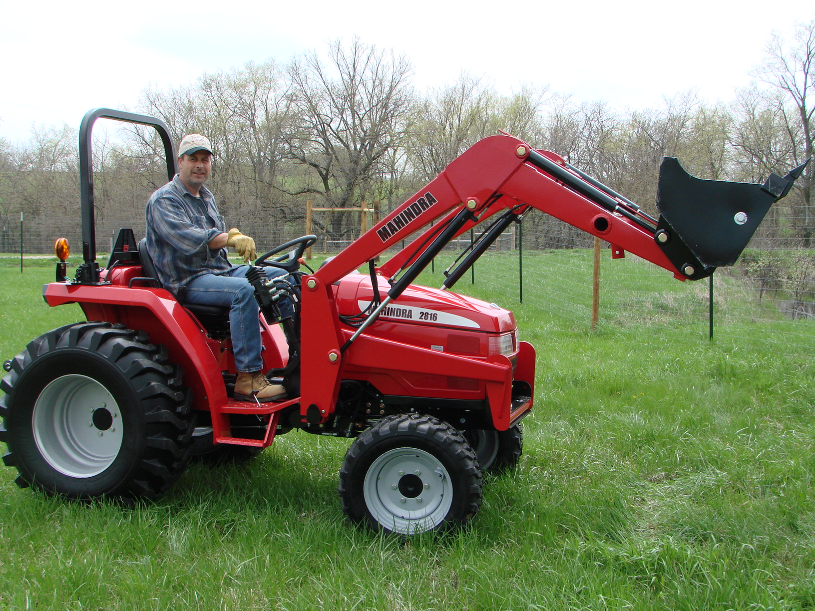

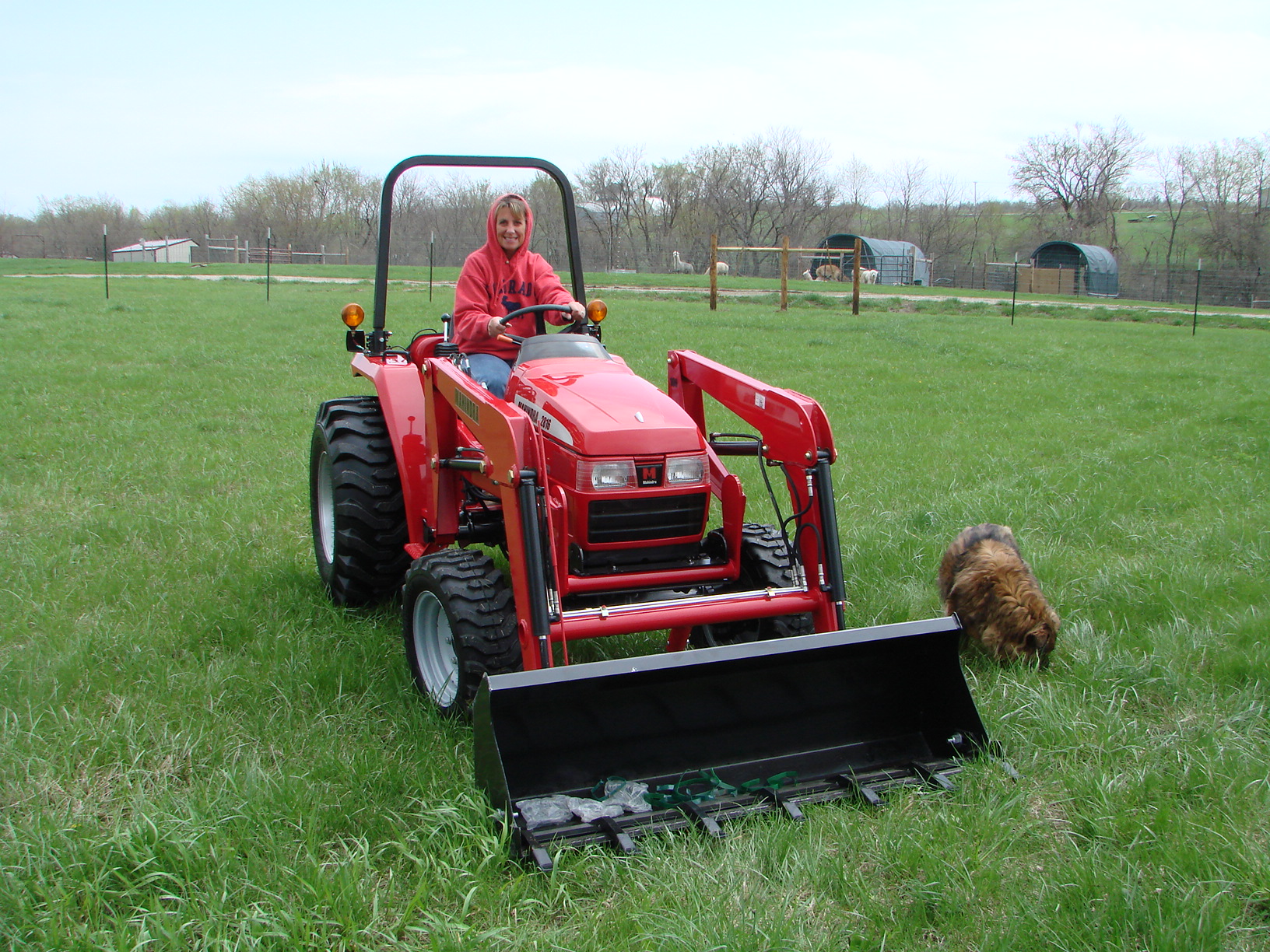

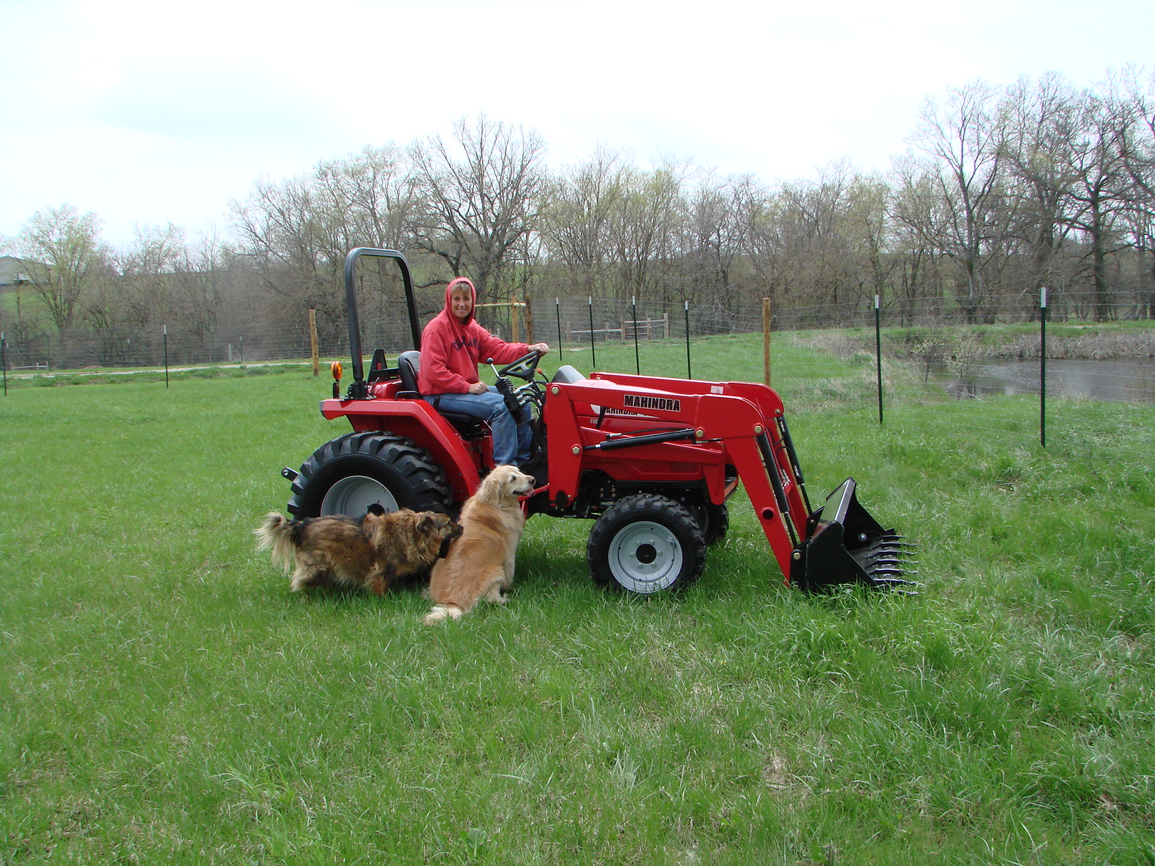

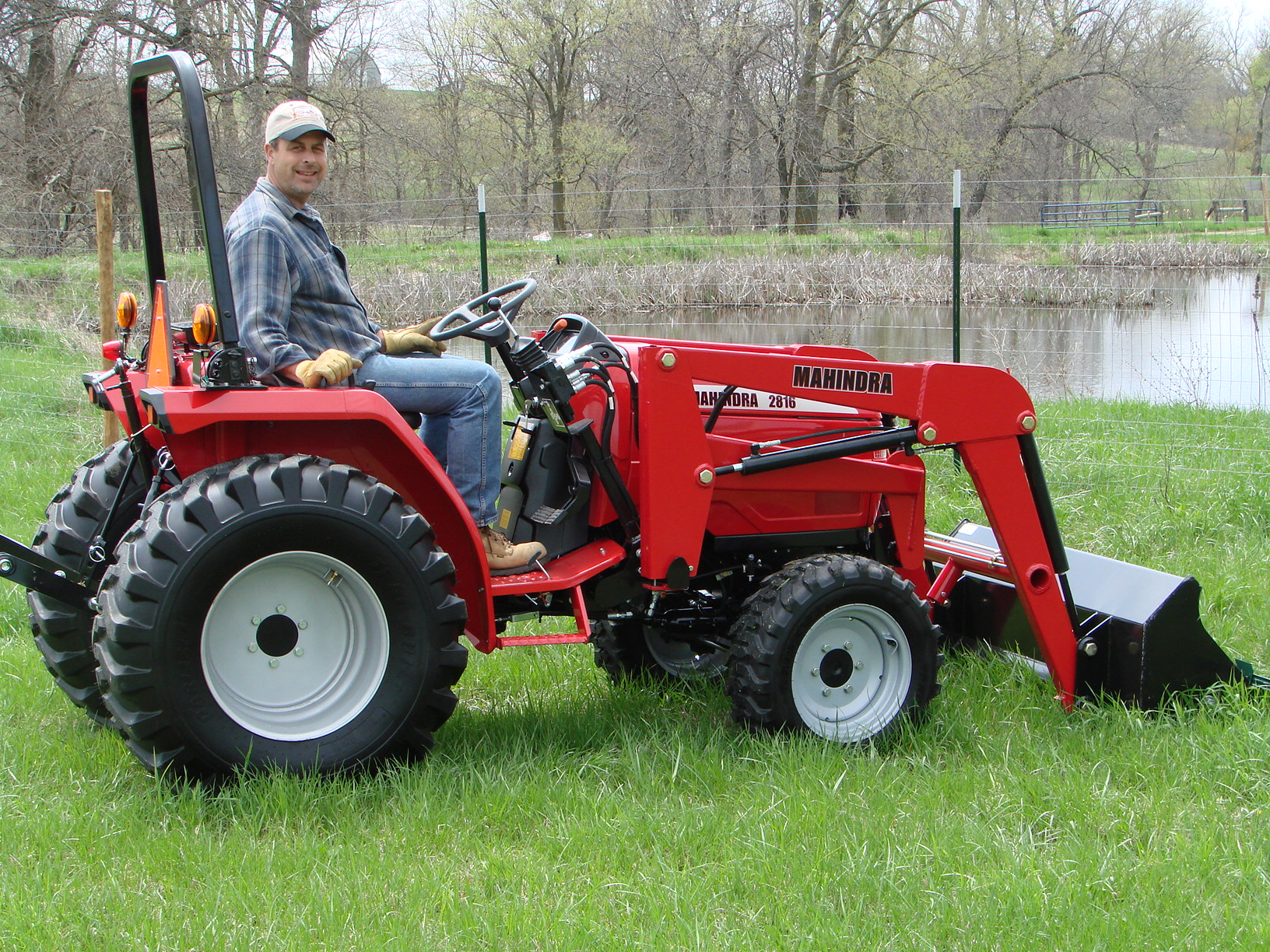

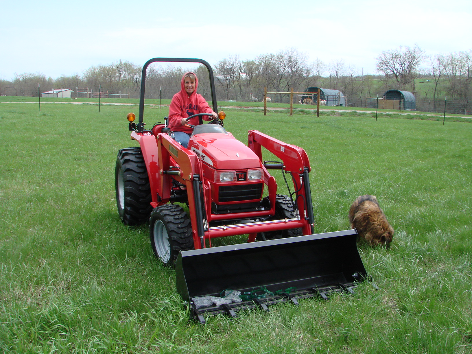

Again folks, thanks for the advice. I've taken it. I am handy with tools, but unfortunately short on time, so had the dealer install the tooth bar. They are delivering the tractor tomorrow. I am so glad to be getting rid of the old AC, and getting something where everything will work. There are so many tasks that have been put off because I didn't have the loader, I'll even have less time. :) I'll get some pics posted as soon as I can.
/ Quick FEL question - Teeth or no teeth?
Well folks, got the tractor delivered. Don't want to get it muddy, but know that will happen soon enough. Here's a couple of pictures. Really like it, and glad to be rid of the old beast.

/ Quick FEL question - Teeth or no teeth? #12
JCT-MO
nice clean tractor, but it will get dirty.
i am impressed with that joystick, and you can
get on the tractor from the right side. my tractor,
L3000DT, you cannot mount the right side, because
the joystick is in the way.
what part of missouri?
accordionman
wlbrown
wright city, mo.
