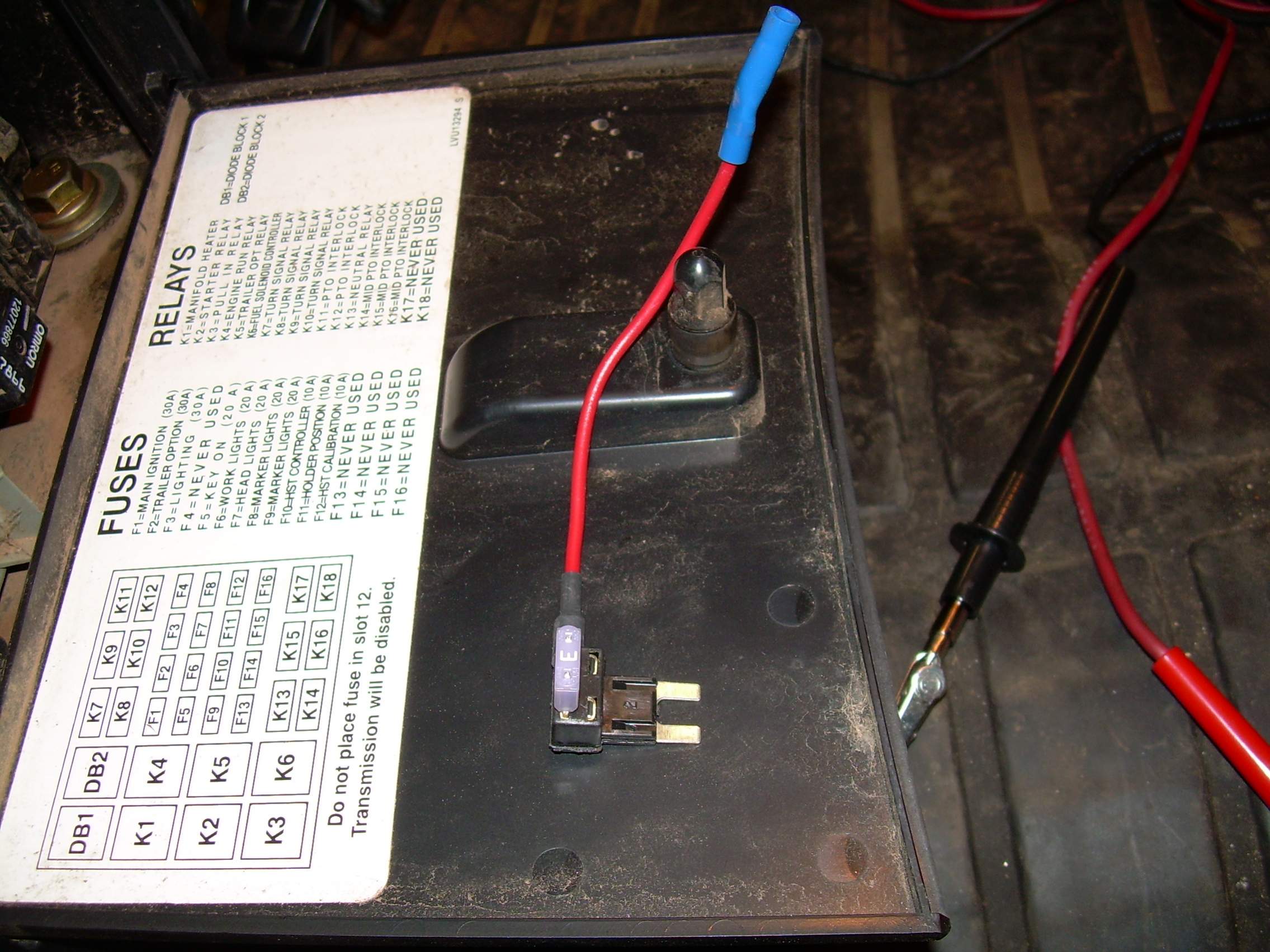

But thanks for the help, looks like I'll be all set with a 10 -15 amp fuse and 16-18 gauge wire.
I'm using a blank spot (F4) on my fuse block that says "never used" it's on the top row where all the others are 30 amp, I put one of those little piggy back fuse things in there to make it simple to wire a cigarette lighter type outlet, allows you to have 2 circuits in one slot but since it was an unused slot I just have 1 fuse in there now (normally would have 2 if you were sharing the slot) got a 10 amp in there now, this circuit is always hot regardless of key position.
JB.

Some of you guys should be working on the next manned moon mission!!! NOT lawn mowers :)
JB.

There's another thing you might want to consider when choosing wire size and that's the difference in voltage drop you will experience between two different gauges of wire. While 18 gauge might be adequate for the application, 14 gauge will have much less voltage drop and you will have higher voltage at the lights themselves, and more light as a result. For example, with the same load and distance, 18 gauge might gave a 10.97% voltage drop whereas 14 gauge would give a 4.33% voltage drop. Since it's literally pennies more per foot for 14 gauge, why not go for the heavier gauge? As for the fuse size..is there nothing else on that 10 amp circuit already? If not you might get by with a 10 amp fuse and you could probably increase it without undue risk to a 12 amp if the 10 blows. No doubt the factory would say never ever oversize the fuse and if you do, you do so at your own risk. Myself... I wouldn't hesitate to increase the fuse size to just enough to not blow when using them. Live dangerously! :D

I regularly work on electric forklifts with voltages from 12 to 72 vdc. Funny, they all run the same control circuit fuse, 14a. I install worklights on these, all with the same 55w bulb, just rated at the voltage the truck runs at. The fuse size on every one of them? 14a. Yep, 12v 55w bulb? 14amp fuse. 72v 55w bulb? 14amp fuse. Notice a pattern? In a man-up forklift, the power also runs through as much as 50' of 18 gauge wire, to and from the bulb so over 100' of 18 gauge wire. These fuses aren't sized so much to their load as they are to protect the circuit from shorts. Dead shorts. Just throw in a 15a fuse and forget about it. Don't make it more complicated than it is. Quit making mountains out of mole hills. The poor OP is going to sit there drooling on himself sifting through all this nonsense.
