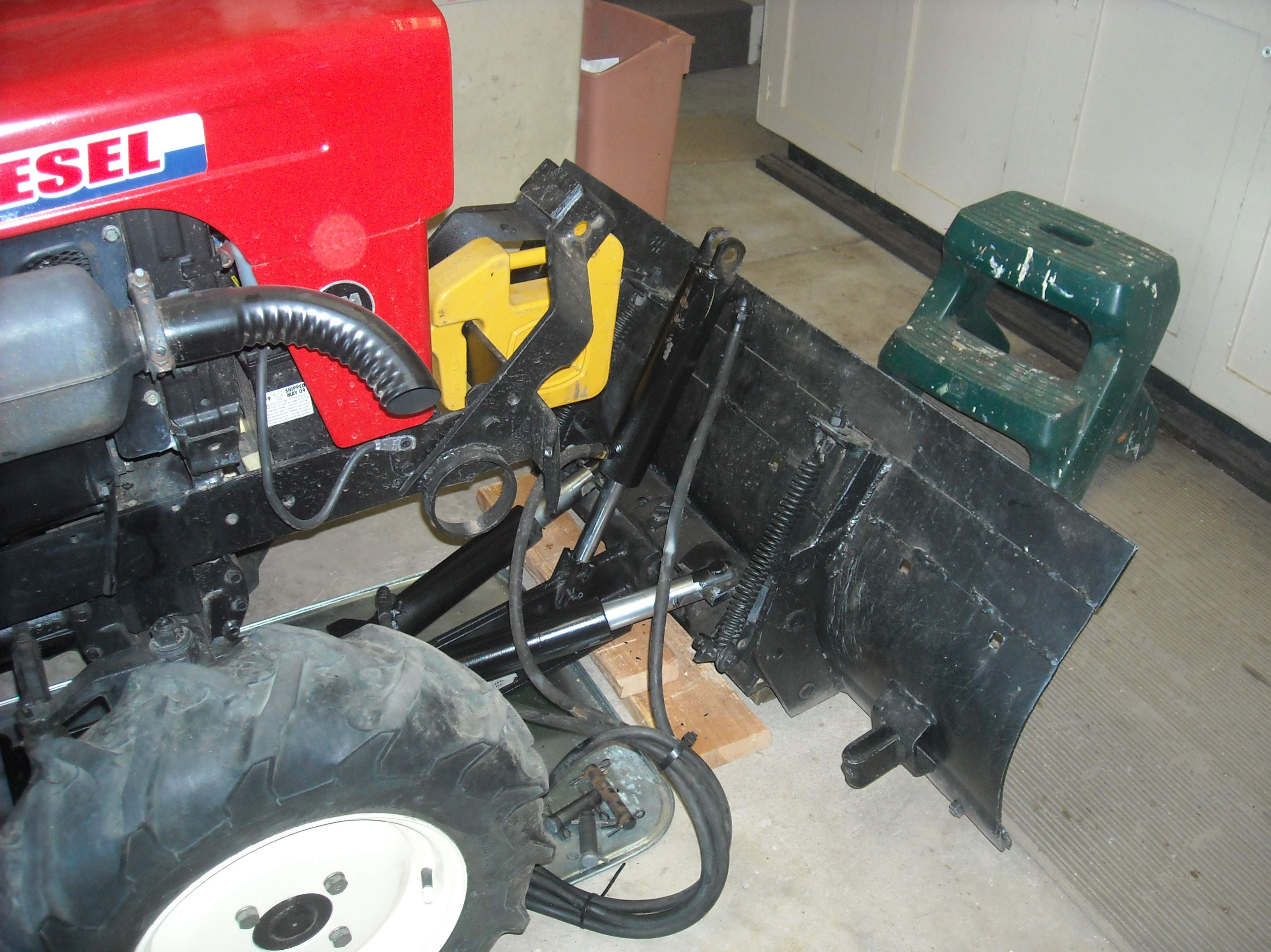

I have a ym165d ,and it has a hydraulic snow plow on the front that doesn't have quick disconnects and I would like to put 4 quick disconnects so I can drop the plow when I don't need it, but I hear about this deadheading problem on the hydraulic pump. My question is can I put these 4 disconnects inline between the control levers and the plow without deadheading the pump?

Yes, as long as the valve is not activated. Does the valve have a PRV (presure relief valve)?
/ Quick disconnects on ym165d
I'm not sure if it has a relief valve ,this was plumbed with the hyd block on the top of the tractors tranny.One line to the control valve and one line back.Then 4 quarter inch line from under the valve ,2 to the lift cylinder and one to the right swing,and one to the left swing.How could I tell if it had a relief valve Pete

Post some pictures of the valve if you can. The PRV usually looks like a screw with a jamb nut on it. You can also plump in a main PRV.

Yes it looks like I have a PRV is this what makes that squeal noise when you are at the top of the lift or far left of right on the blade swing? Pete

Yes, that's it. When it's sqealing then the PRV is working. You can safely add QD's to the work ports on your valve.

Well I'm back ,and thank you for all your info it really helped I'm working on my mounting bracket now. I will try to send picks Pete.
Well I took some pictures now lets see if I can post them. OK I hope this works so I can finally get Winston pics of snowplow/dozer.and thanks for all the help this forum is great Pete

That is a neat looking rig! What is that hitch looking thing on front and how does it work. I can't figure out how it comes down if it does.

That is where the top of the lift cylinder attaches .its kind of deceiving because the plow is dropped in that pic ,and I have a suitcase weight on the front bumper .The plow hooks to a subfram with two pins then the lift cylinder hooks with a third pin,and know the 4 quick disconnects
