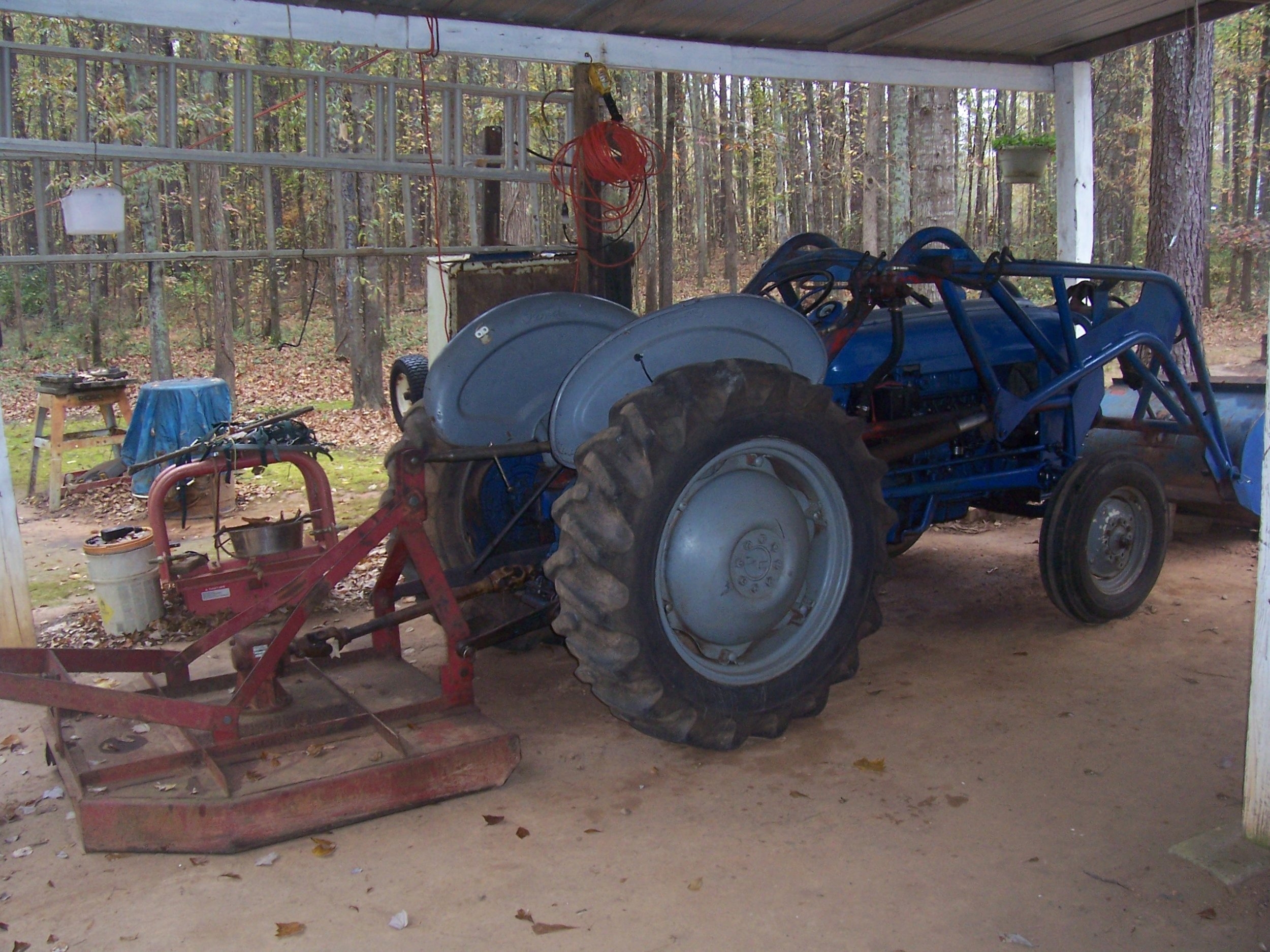

The relief sounds like the problem. Here's the valve and pin to the lift. The handle regulates the height. The further it's pushed in the Higher the 3Pt..
The spring keep tension to the lift pin. from the 3Pt adjusting handle.
I use a Old International BH. that weighs so much that when I had it on the YM2000 it would literally lift the front wheels. Moving on the driveway I have to keep it low and keep the rear wheels on the ground. 800lbs would be a good guess of the actual weight.
My power steering Asst. on the 63 F-2000. Offsets the loader and it does work. It's pretty brutal!! Was able to look up the FM I use and I don't have weight problems with it. JD> 1060 manual has it at 611lbs.. Need blades for it Agra Supply! excellent serv.. Found the Reciept Brain where I replaced them last time!!

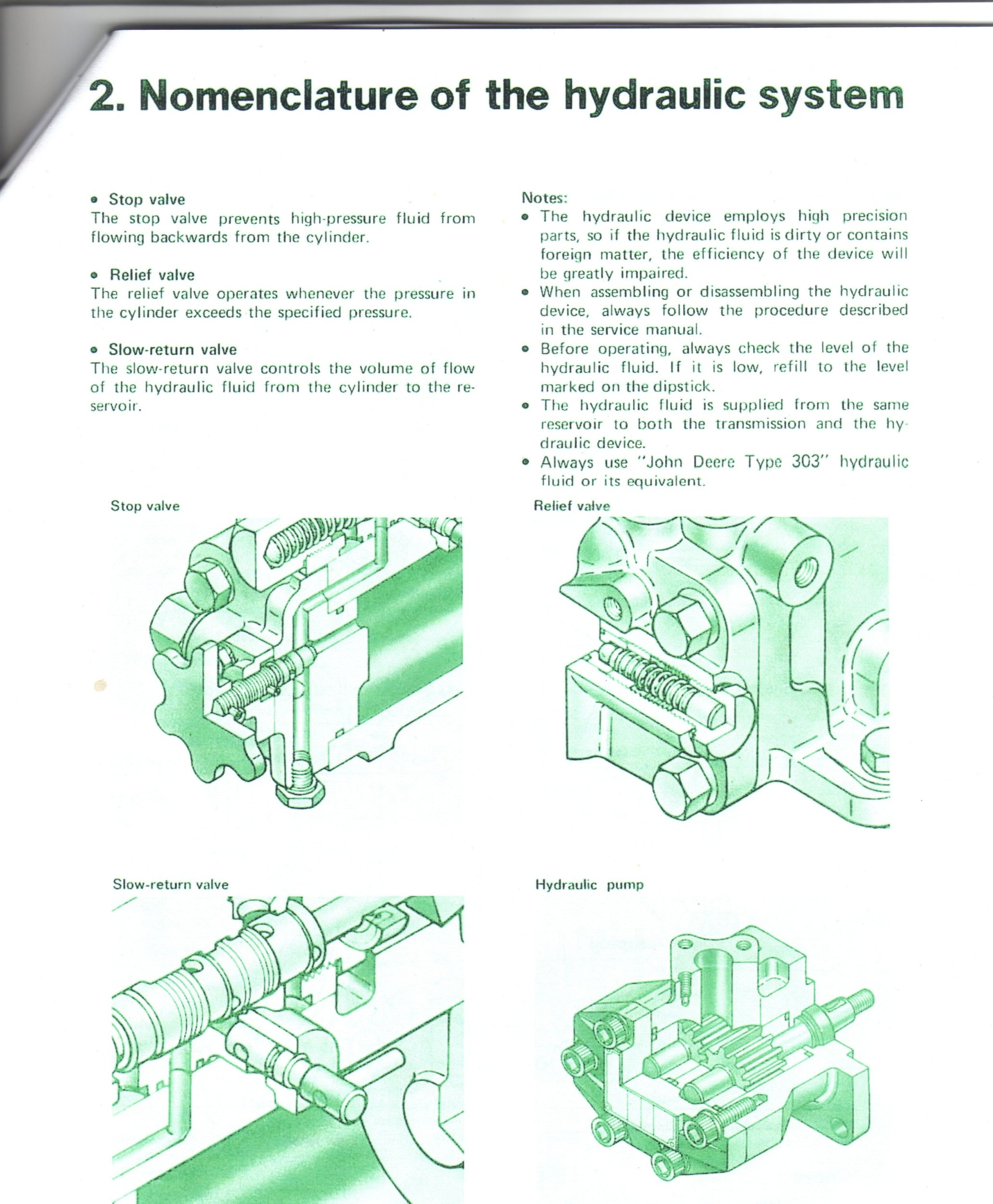

On the YM240 they call it the Relief valve. It operaters when the pressure in the Cyl. exceeds the specified pressure it's set for. I knew it may be differen but it's what my 240 Hyd. Serv. Manual shows.
Thx. I see the relief valve on a piping diagram blowup, and it also points to the ball & spring, and also says 'shim, for pressure adj'
Is there a description of how to access it to check the ball, spring, shim and/or adjust it?
/ YM240D 3-pt #15
Looking at the cross-section It appears to be spring loaded with no Adj.. So apparently it's factory set. Apparently they rate it by shock weight. Relieves the pressure when a sudden shock hits it. They make a note to take advantage of the relief valve and always leave the stop valve open when driving the Tractor with a implement mounted.
O k, but it says 'pressure adj shim'. Shims available for adjusting?
Which of these two caps would let me check the ball, spring & shim in the event of a worn ball, weak spring?
