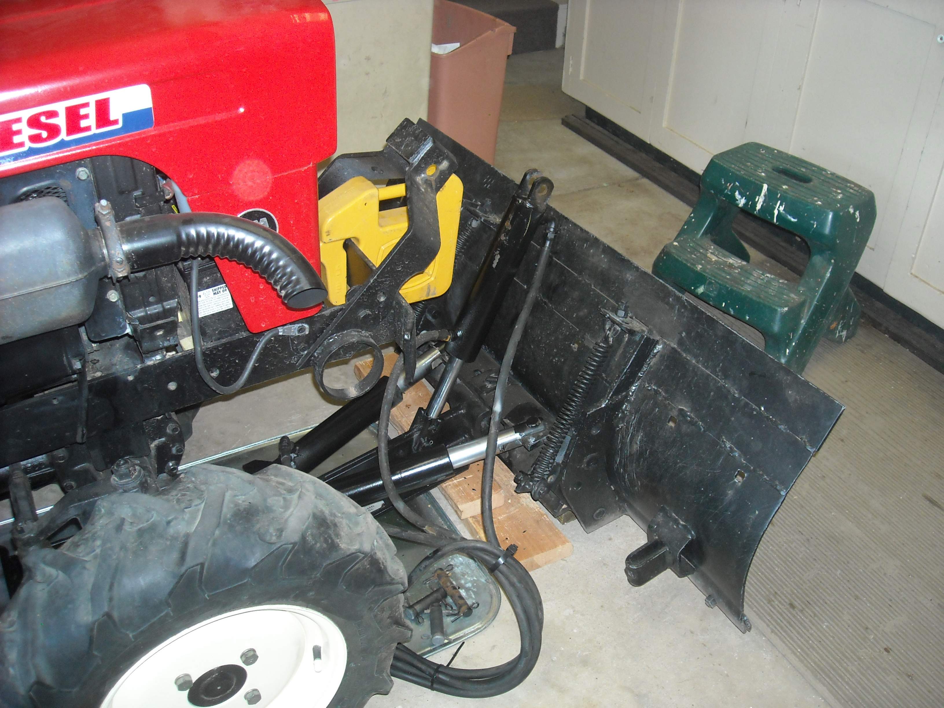

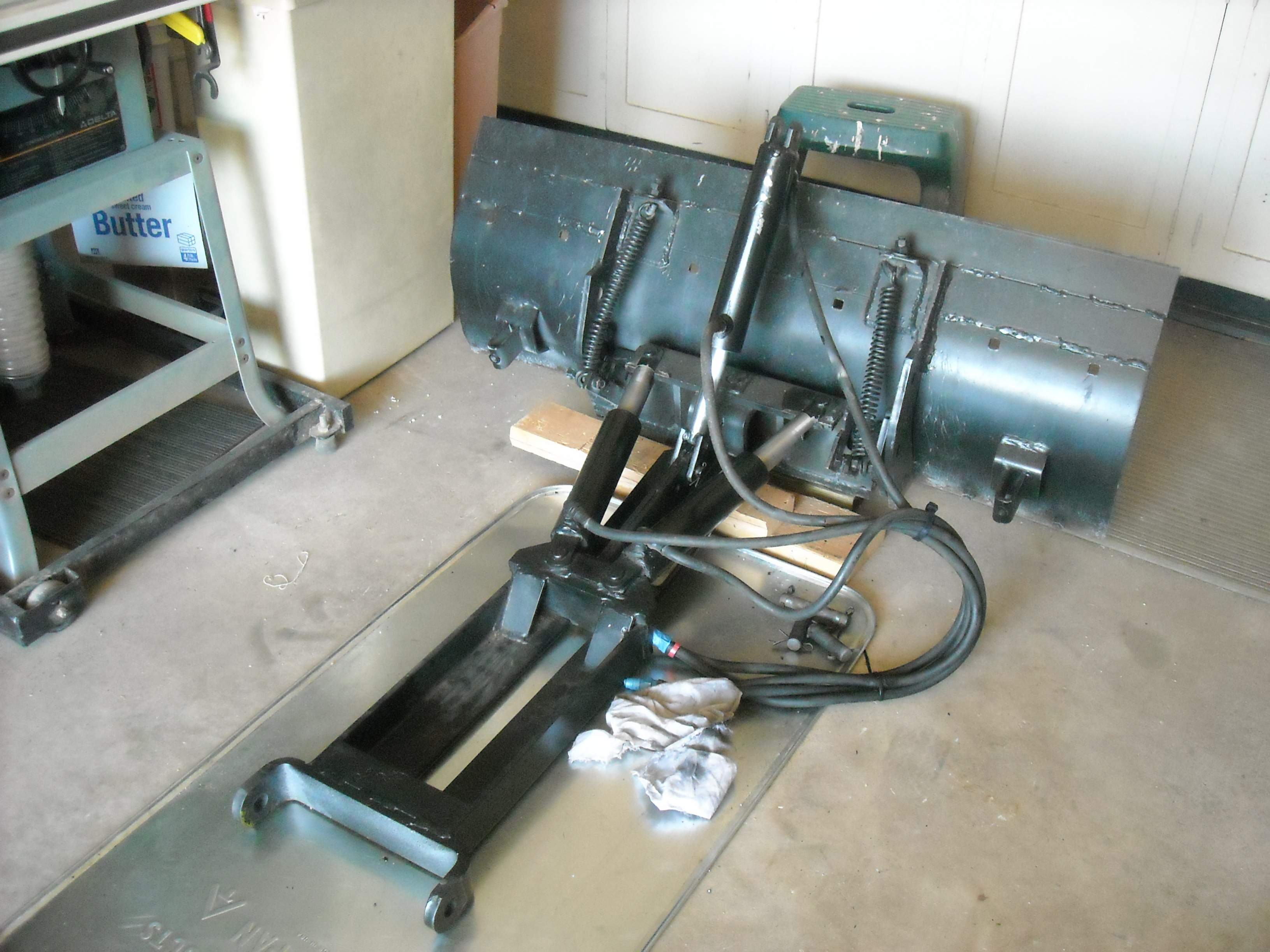

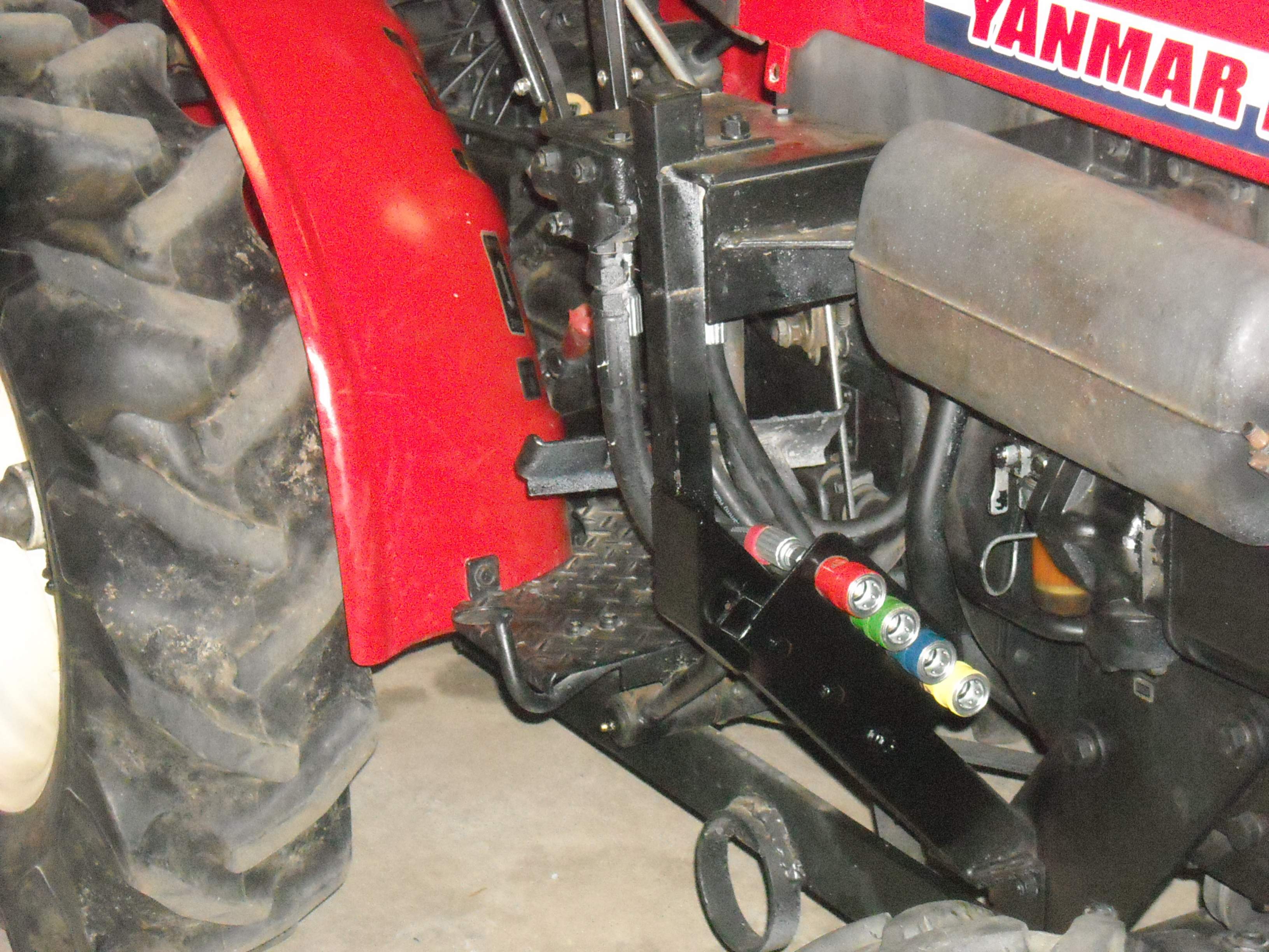

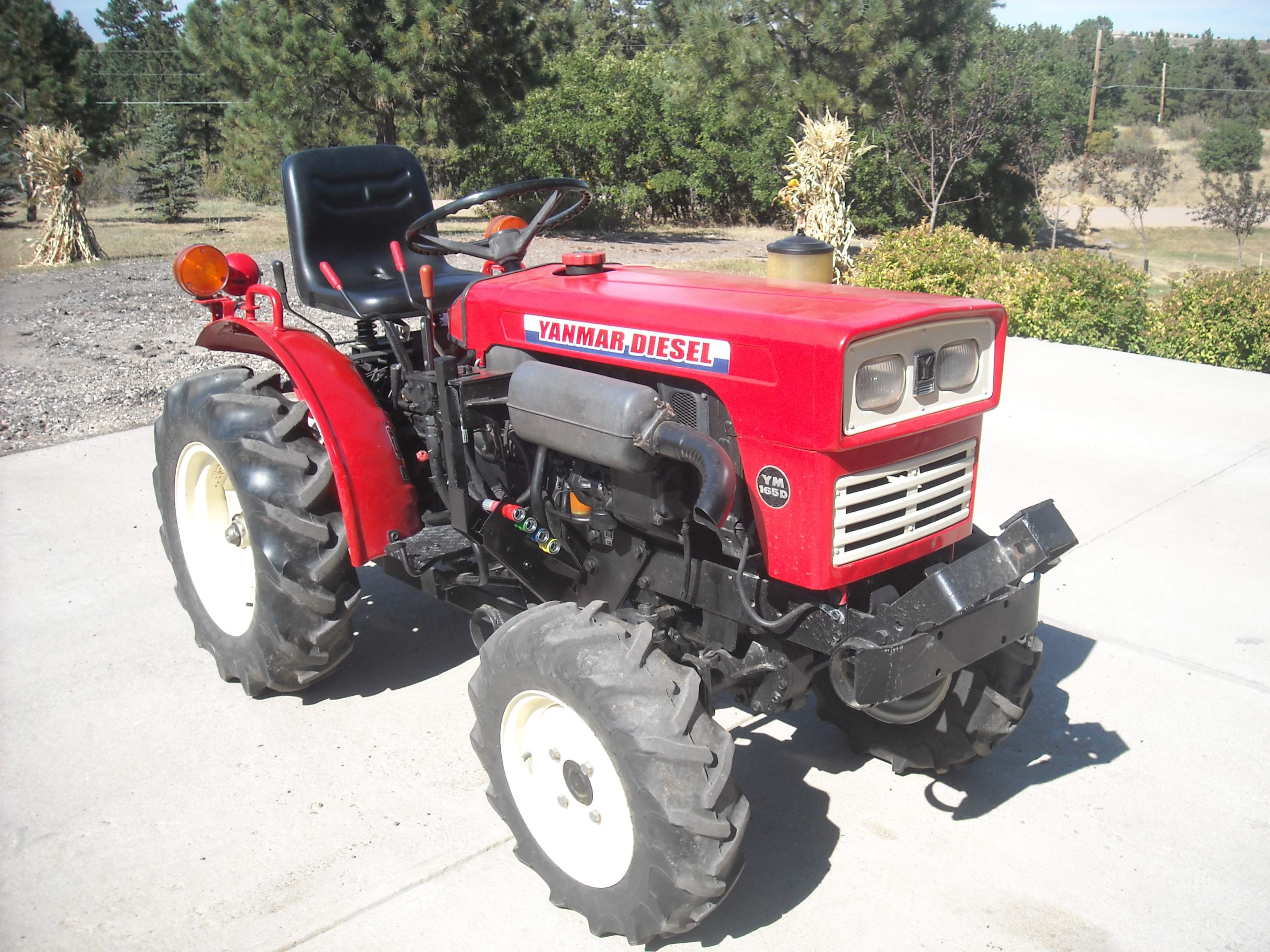

Well I took some pictures now lets see if I can post them. OK I hope this works so I can finally get Winston pics of snowplow/dozer.and thanks for all the help this forum is great Pete

/ Quick disconnects on ym165d #11
That is a neat looking rig! What is that hitch looking thing on front and how does it work. I can't figure out how it comes down if it does.
#12
That is where the top of the lift cylinder attaches .its kind of deceiving because the plow is dropped in that pic ,and I have a suitcase weight on the front bumper .The plow hooks to a subfram with two pins then the lift cylinder hooks with a third pin,and know the 4 quick disconnects

/ Quick disconnects on ym165d #13
Well sure, any dummy should be able to see that!:eek:
