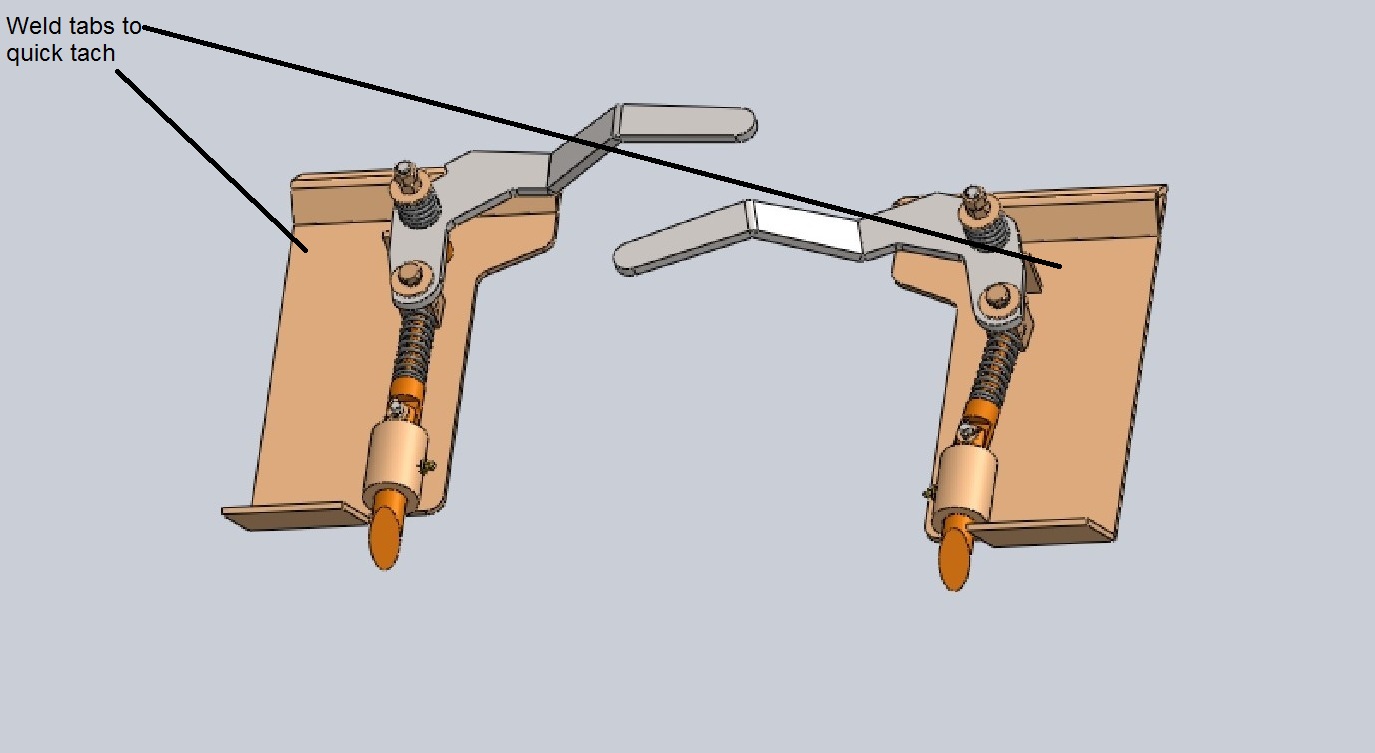

Thanks Xfaxman, but I was referring to the spring that is holding the handle down, not the one attached to the pin that secures the implement. I have not fit it to an implement yet to check the fit there.
/ Quick Attach Conversion Kit.... Need a little help #42
You don't need much spring tension on the handle. What keeps it down is the compression on the lower spring when it hits the attachment plate, and the handle keeps moving until it hits the stop, (usually adjustable) just over center. That lower spring is holding the pin tight against the QA plate.
The distance the pin goes down varies on different plates, depending on wear in the slot.
To raise the handle, you have to compress the lower spring a little as the linkage comes back over center and pulls the pin up to unlatch the attachment.
Compare this handle to yours, notice how it has been ground off to provide the over center stop when it is fully down as in their picture.

Thanks for the info, especially the part about the ground handle - I had not seen that before. I will keep that in mind when placing the stop on mine since I am not putting on ears there.

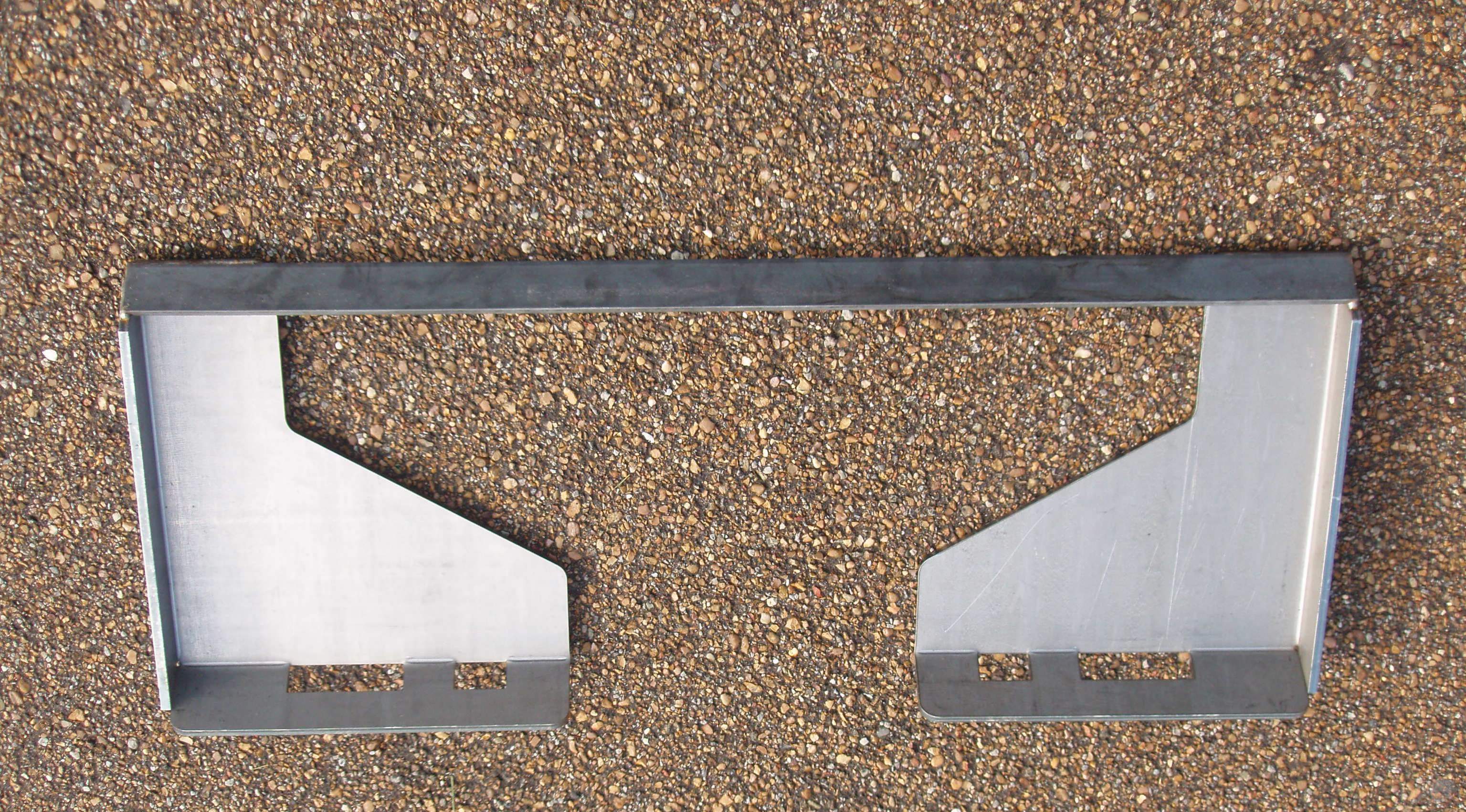

The total width is 49" and each of the plates are 7" wide and 22" tall. These plates will be wider on future editions when we run this in full production in 60-90 days.

We just finished making a new Quick Tach Conversion kit to convert pin on style loaders to the skid steer/tractor style universal quick tach hookup. The cost for the kit will be $259(free shipping) and it includes a mounting plate and both quick tach brackets.
We need step by step photos of an install of this kit for our ads. If you have the ability to cut, weld and email good photos we will sell you the kit for $100 in return for some good photos. Inbox us for details or email us at info@palletforks.com.

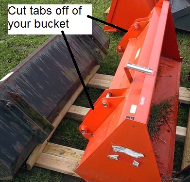

Maybe this was covered in a earlier post.
I used your latch plates for my build and they work great but you cant just cut off your brackets and weld directly to the plate like the picture in post #1 shows , even if the width allows it the kickouts where the pins latch in hit the loader arms and prevented the bucket from pivoting to full dump. Just want folks to check there clearance ahead of time when fabbing things up. I ended up with a 2" piece of square tube as a spacer under my pin boxes which was perfect.
If I was to do it over i would just cut the pin boxes "out" of the bucket and not "try" to cut them "off" of the bucket then use the 2 rectangle holes in the bucket for some extra weld on the backing plate.
