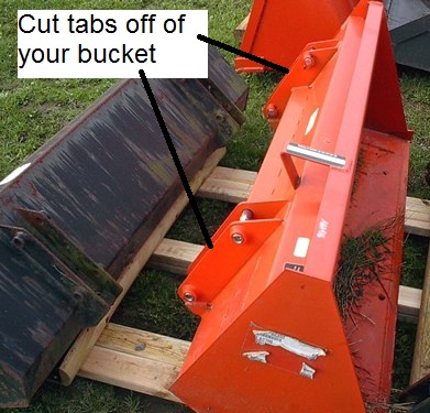

We just finished making a new Quick Tach Conversion kit to convert pin on style loaders to the skid steer/tractor style universal quick tach hookup. The cost for the kit will be $259(free shipping) and it includes a mounting plate and both quick tach brackets.
We need step by step photos of an install of this kit for our ads. If you have the ability to cut, weld and email good photos we will sell you the kit for $100 in return for some good photos. Inbox us for details or email us at info@palletforks.com.

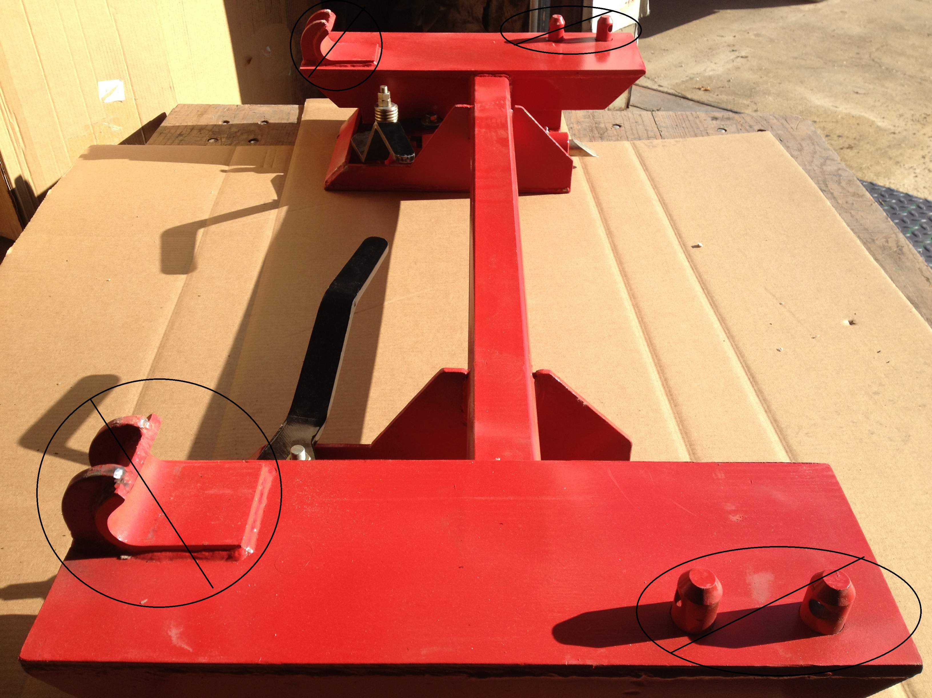

Bill, is there a component missing in your photos, like a plate that connects the ends of the cylinders, ends of the boom, and to which you welds your toggle assembly?

Theoretically any tabs or plates that are on your bucket could be welded to the quick tach plates but there are quite a few styles of loaders and we may end up including an extra spacer plate part or 3x3 square tubing if the majority of people need those parts.

Here are a few more photos of different styles of buckets and an OEM Kubota Quick Tach connected to one of our solid mount plates.

The issue I ran into and noticed alot was a compact tractors loader arms are just as wide, or wider than the SSQA plates, you would have to jog the pin mounts to get it to work properly. Obviously they do it and you can see it when you look at a fabbed one.
I think the back should be boxed in so you can move your tabs around where you'd like, maybe even extend that boxed portion outwards to accomodate the added width most tractors seem to have (loader pin center to center), after the pin mounts are mounted the rest could be just cut off as its not needed. Just an idea.
Ps- if you boxed the back of your QA plates you could also run a brace somehow from one side to the other as well all at the same time as the plates have to be tied together somehow to hookup to your SSQA plate/bucket. Obviously price will go up a little with that but 259$ is still way cheaper than i've seen other systems cost.

Great advice Puckgrinder. The more I dig into the details the more I agree with you. Our goal is to provide a high quality/low cost option for a quick tach conversion. We are close to having this one ready for the market.

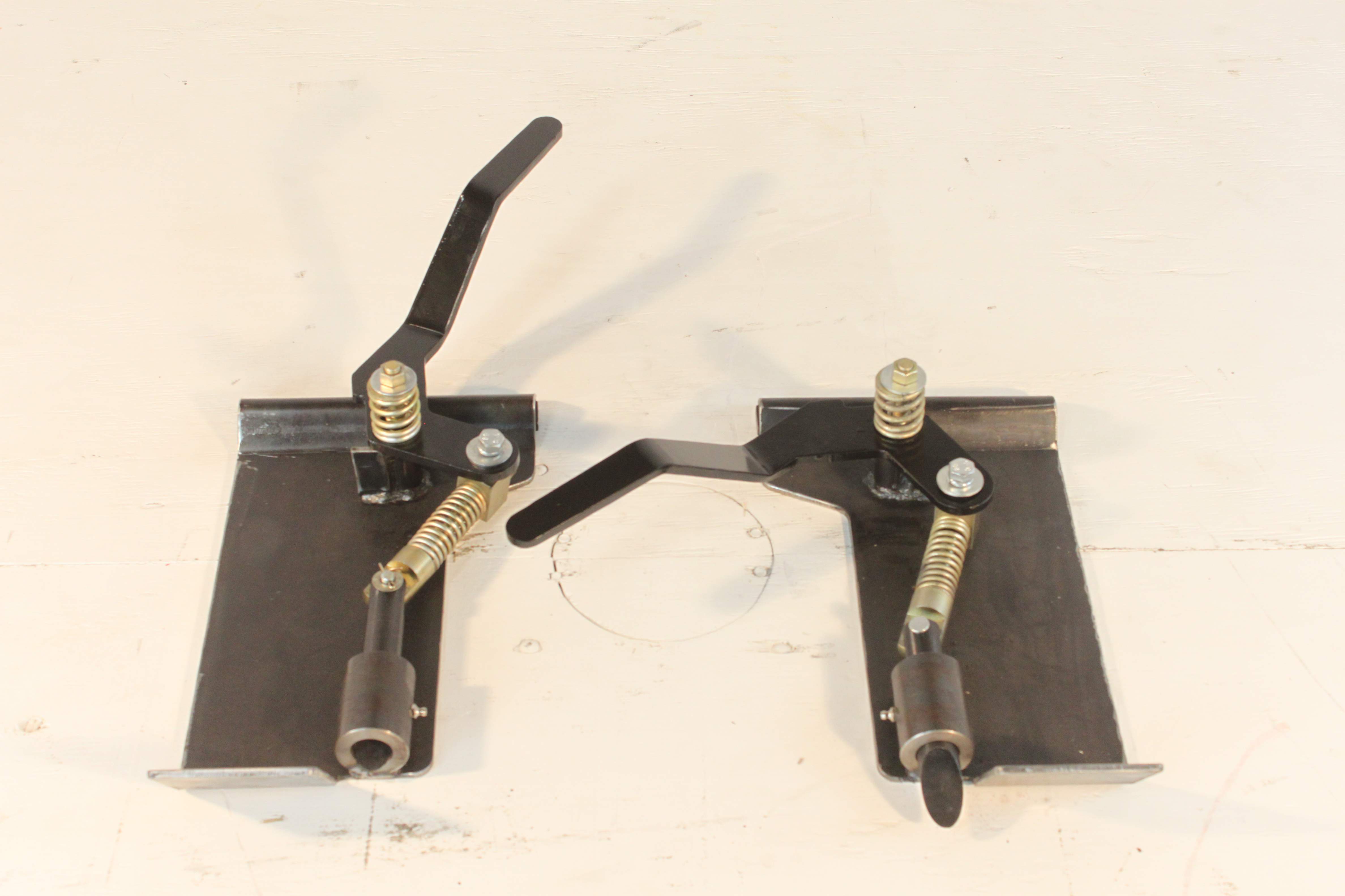

View attachment 300984View attachment 300985View attachment 300986
I would like to buy only the latches in picture two. I agree they should have back plates. I woould use them to make an adapter for my loader to S.S. attachments. I would not convert my bucket or other attachments. It would just be to be able to add S.S. attachments in the future.

I would also be interested in just the latches as I would like to build an SSQA for my mini excavator.
I don't think a back plate is needed as that would increase the cost and is something that someone with the ability to cut and weld steel should be able to do if he needs to, but really it is up to you as to how much fabrication you would like to leave up to the customer. The price point you have targeted is certainly attractive now, but every add on makes it more expensive and some may not want them in the first place - me.

Here are 3 actual photos of the quick tach plates($179). The last 3 photos will be the boxed in version($295) (minus the Deere Style tabs).

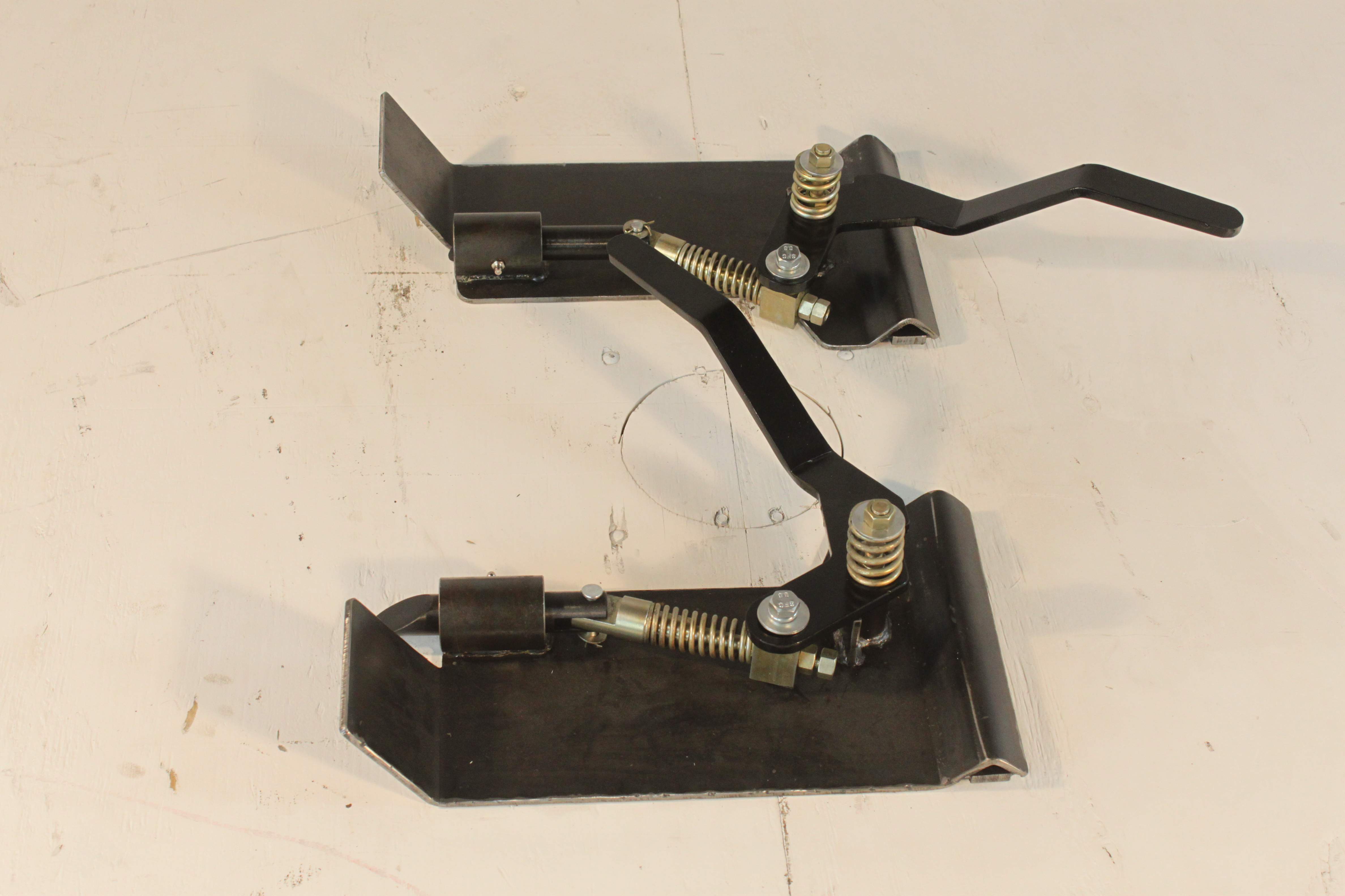

View attachment 301342View attachment 301343View attachment 301344View attachment 301345View attachment 301346View attachment 301347
Will the boxed set have the square tubing connecting them? Dimentions of the plate the JD mounts are on? Length x width x thickness.
How heavy (thickness or ga) is the metal of the latch plates?

Tagging onto the above question (for use on a Kubota B3000/LA403 FEL), does the planned (hopefully) inclusion of the cross-tube seen to strengthen against bending, or torsion. (The reason for the question is that for a given wall thickness, round tubing is stronger against torsion forces.) Just thinking out loud.
/ Quick Attach Conversion Kit.... Need a little help #17
The square tube should be more than adequate for what that piece is doing. All its there for is to hold both pin boxes together when the bucket or attachment isnt in place. After the attahment is connected the attachment itself should become the stressed member. The bar may see small forces but will be limited to only small amounts of movement. This also raises another point, dont be lifting stuff with only the quick attach mounting, people here have done it and bent that cross beam, its not made for supporting loads!

The latch plates on the Boxed assembly are 1/4" thick The gussets and boxes are 5/16". The tube wall is 1/4". It has a sturdy, solid feel.
The top (or back side plates) are 22" tall and 7" wide. (These will be wider when we get this item into full production)
The boxed in assembly weight is 137 lbs. An OEM Kubota quick tach is 106 lbs.
