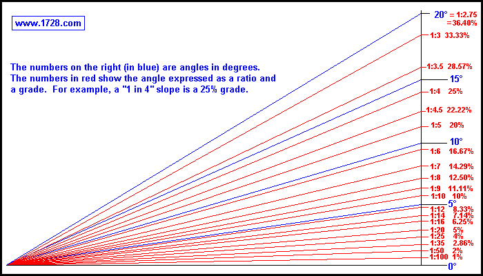

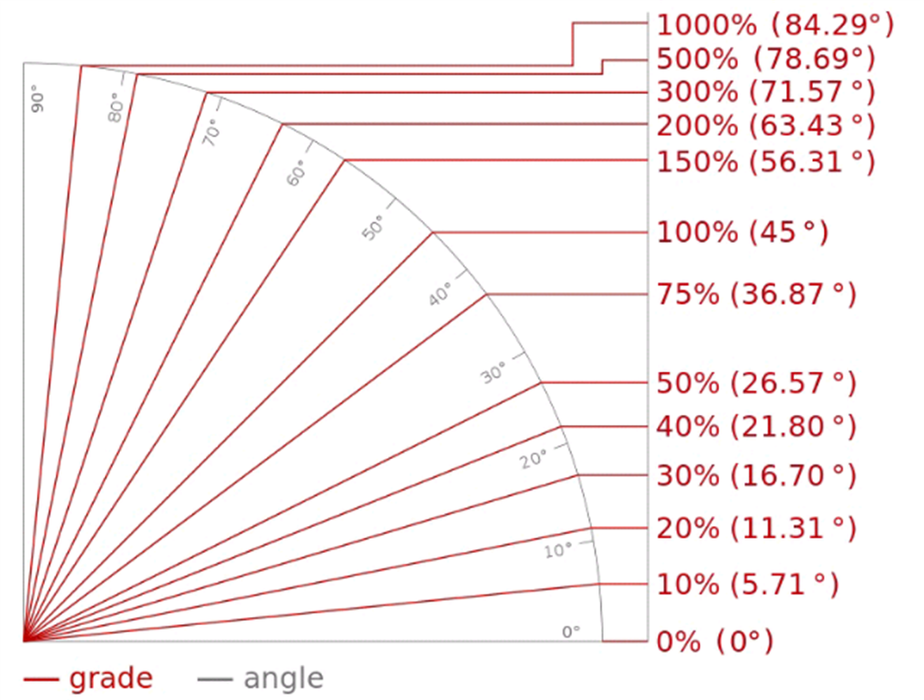

Slope charts:
attachment.php
attachment.php

Thanks for all the info folks. A lot of new information. Believe me, mowing grass is the least of my worries. We already have the Huskvee, which does the job mowing, except on the two grass slopes that are 50% (per the chart posted above). Right now I do one of them with the Huskvee (downhill only, and thank God for the new road that cuts across, making a landing/turning-around space right before the 75% drop off--some pucker factor there). The other one doesn't have a good "landing place"; it ends in tall trees. No where to turn around, can't back up, can't go forward, can't turn around..... I pay someone to mow that one now. Would like to clear a landing place/turning around place there too; but if I have to, I'll let it revert to wild :) Frankly I don't much care about grass lawns....just a little around the house is fine and I ain't that picky. This isn't a golf course. There's only so much effort I'll put into farming something I can't eat, like tall fescue. :)
