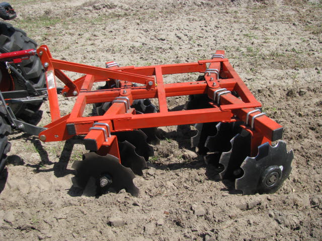

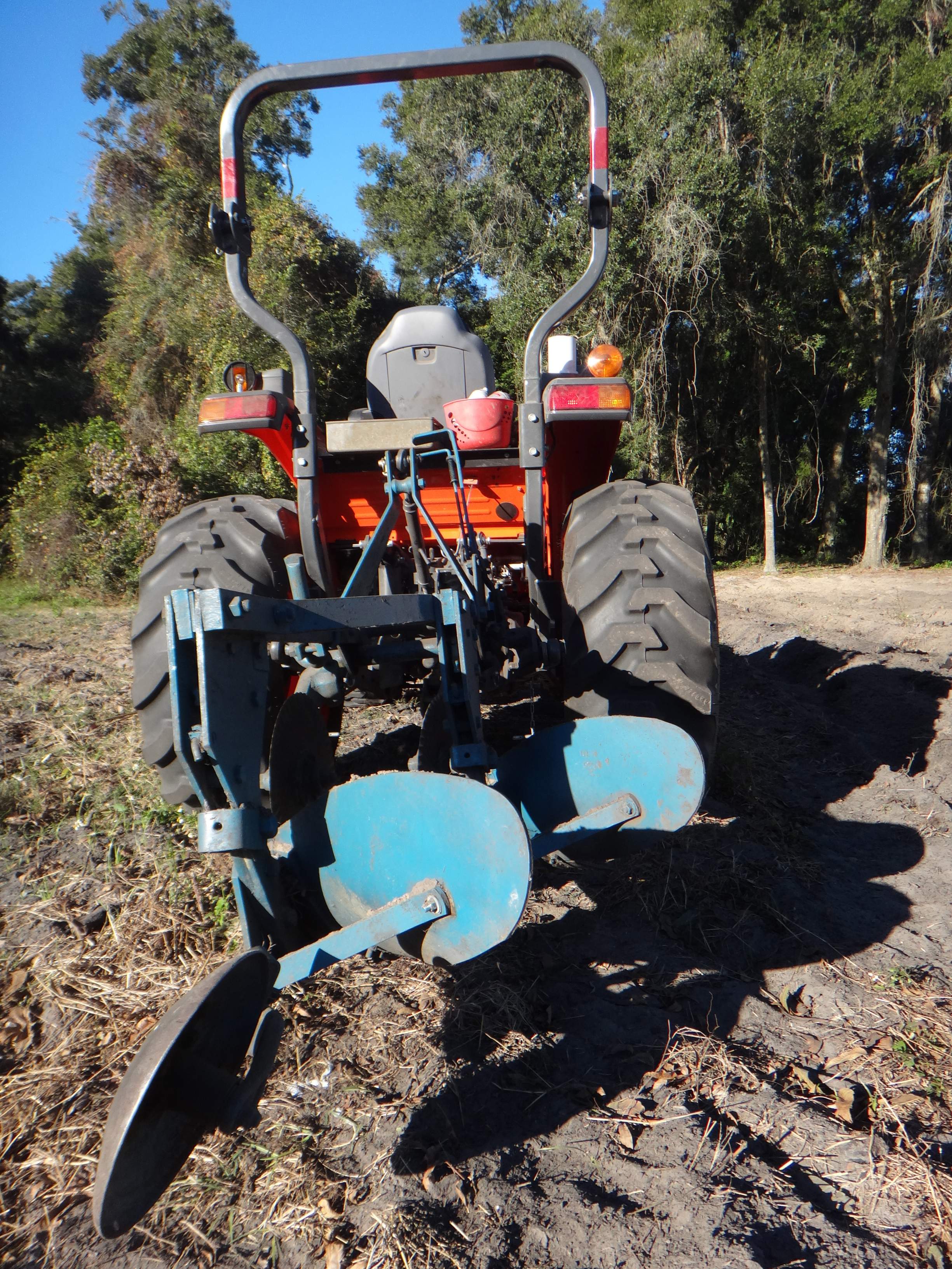

I'm looking at the following implements for L3940
2 Bottom Plow
Disc
Tiller
Snow Blower
Box Blade
Carry All
If you will be cultivating one acre or so, a Tiller will do what you need in one or two passes BY ITSELF.
If you buy a 2-12" Turning Plow, you will also need a 16/18" or 20/20" Disc Harrow to use in succession.
Generally speaking, a Turning Plow kills most grass/turf when it is pulled through the ground, turning vegetation under.
Usually grass/turf are not killed when soil surfaced is disced; grass/turf regenerates from roots the next Spring. This is especially true of deep rooted pasture grass.
