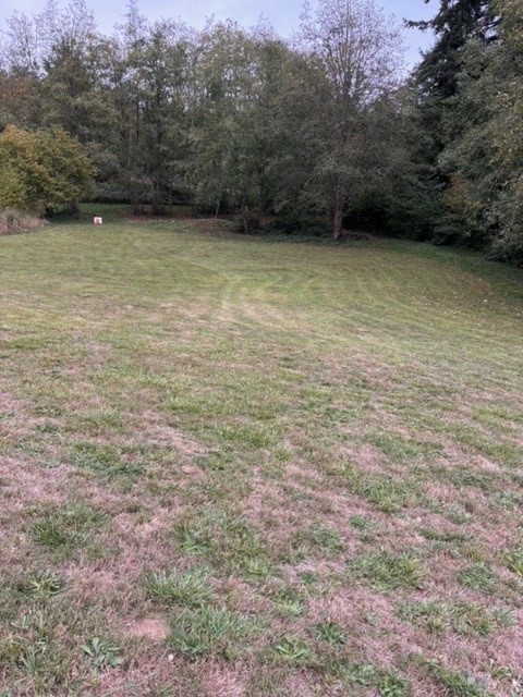

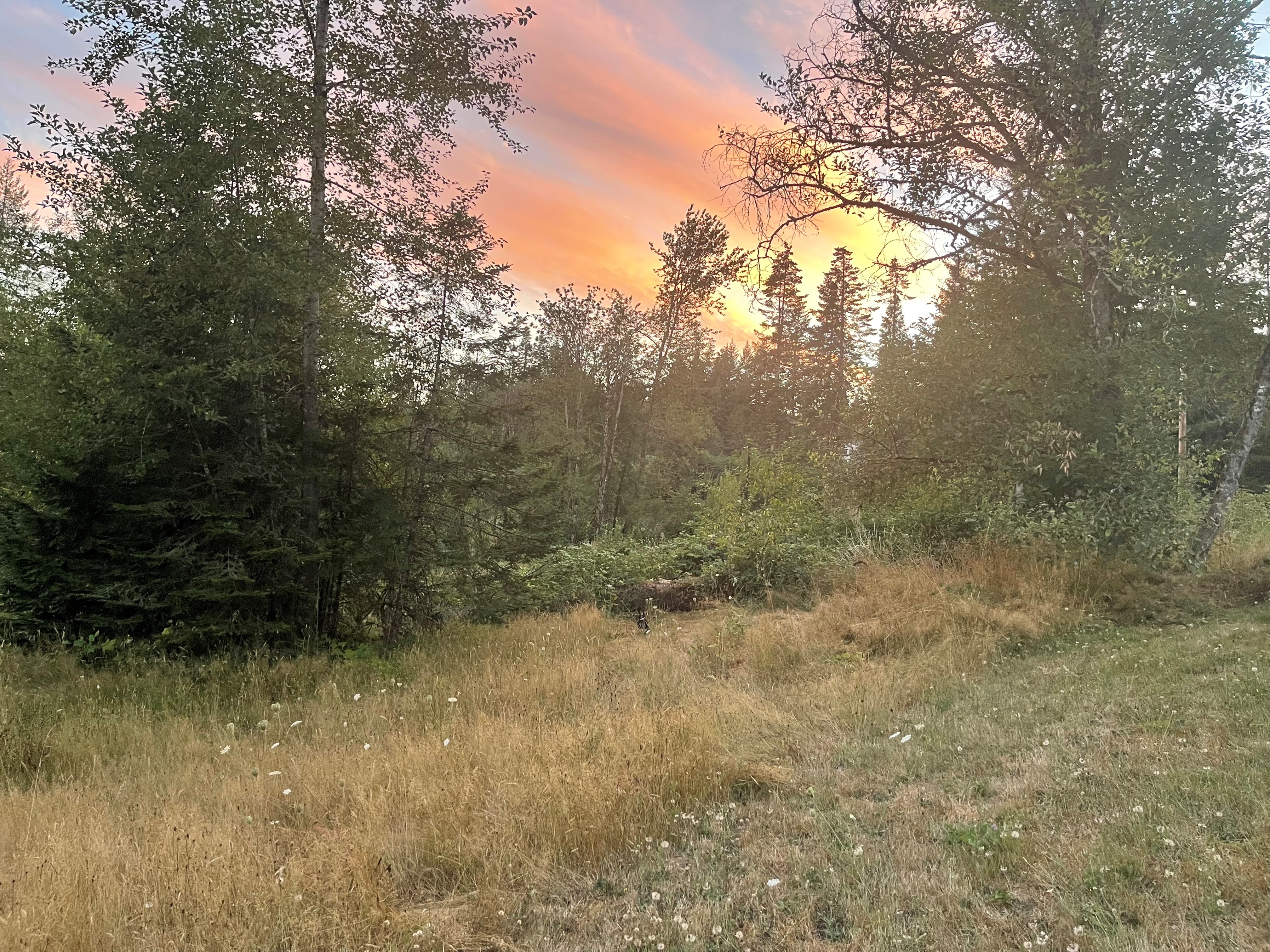

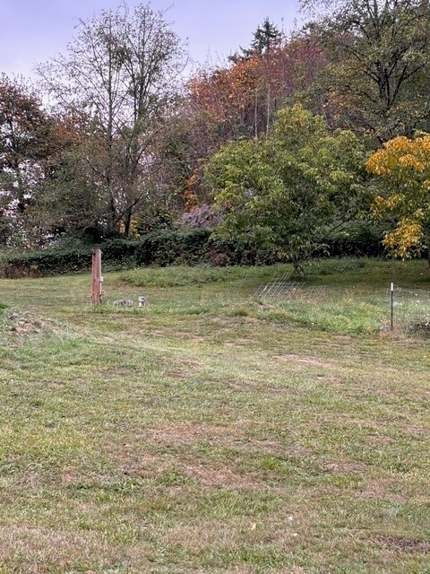

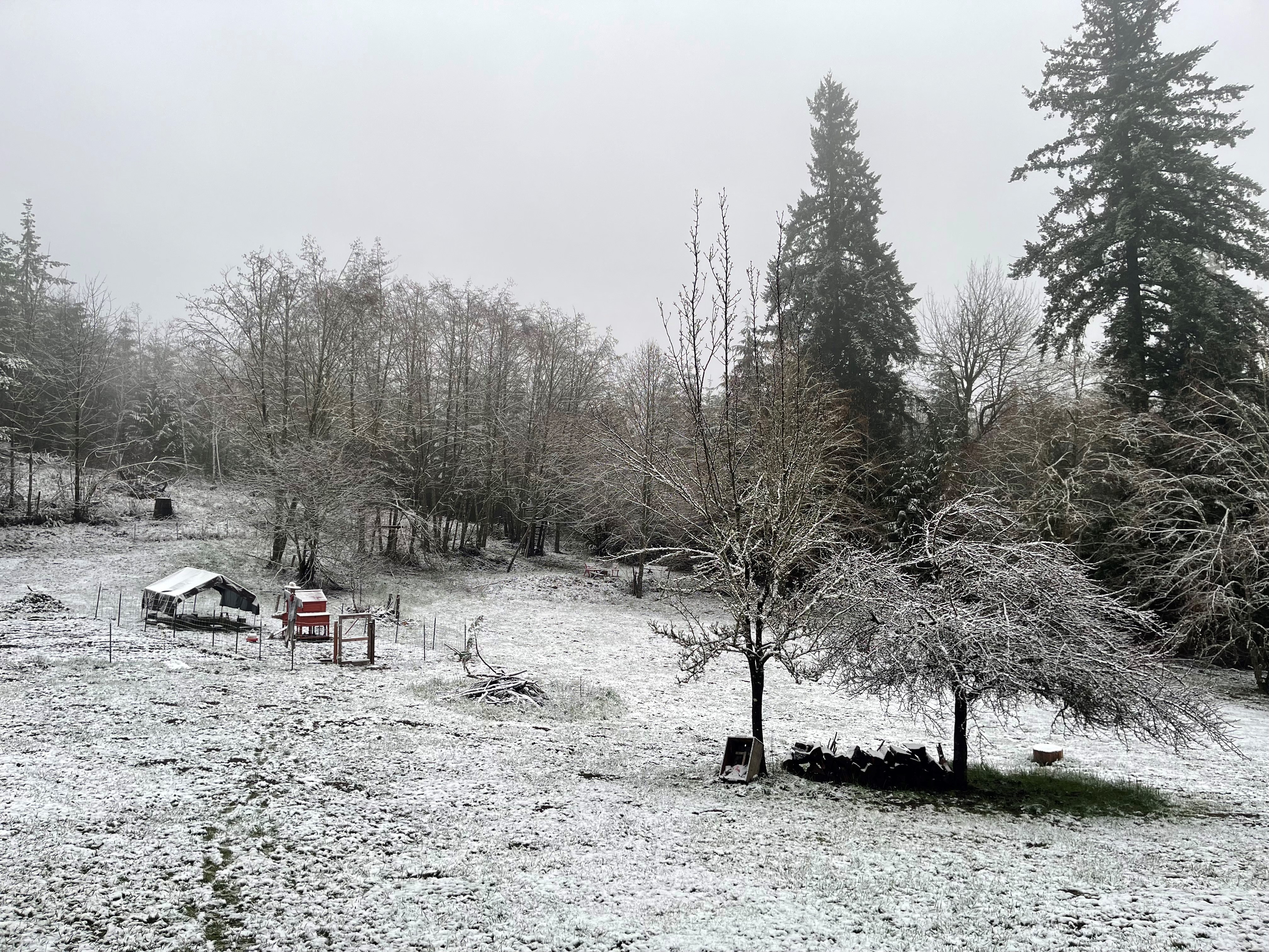

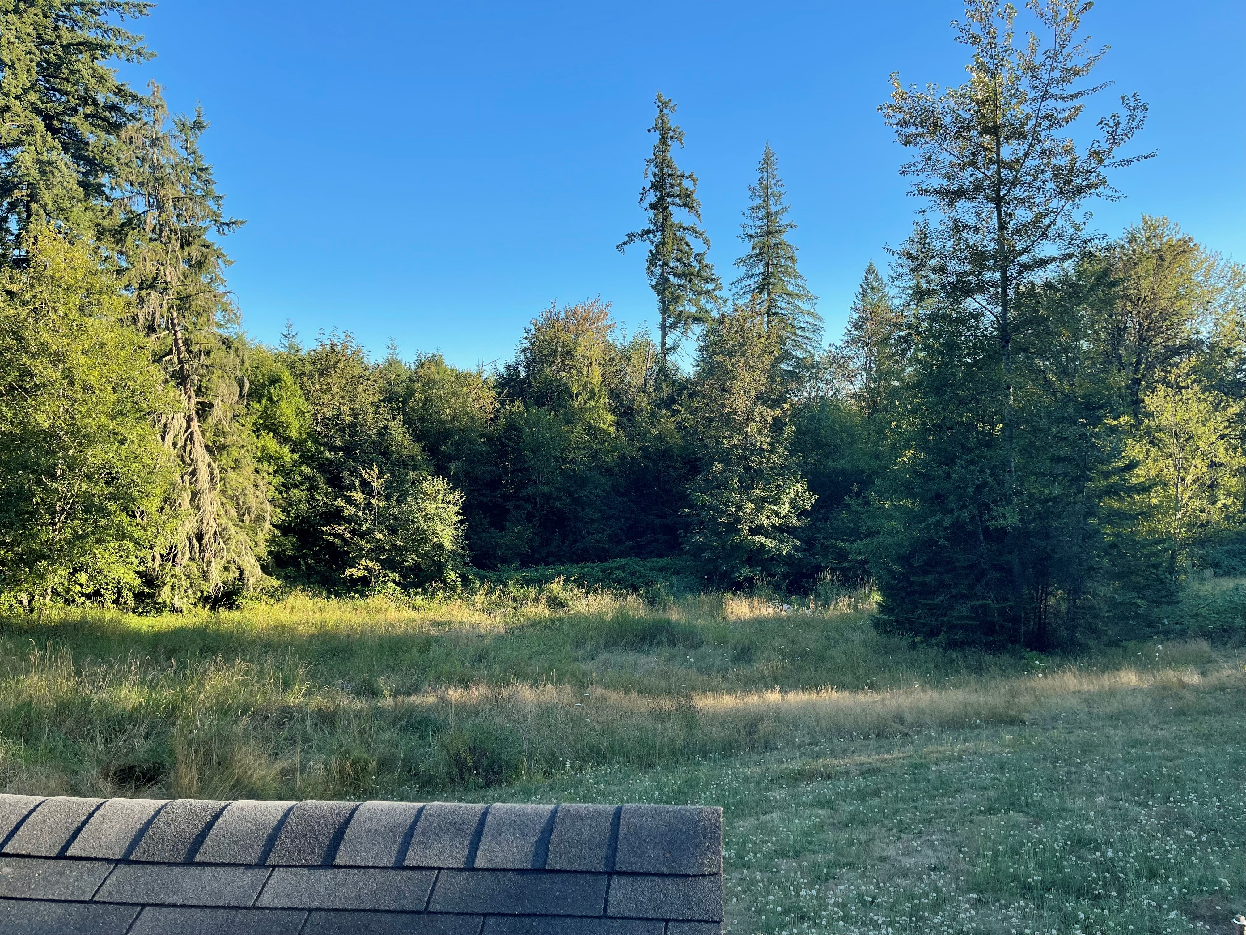

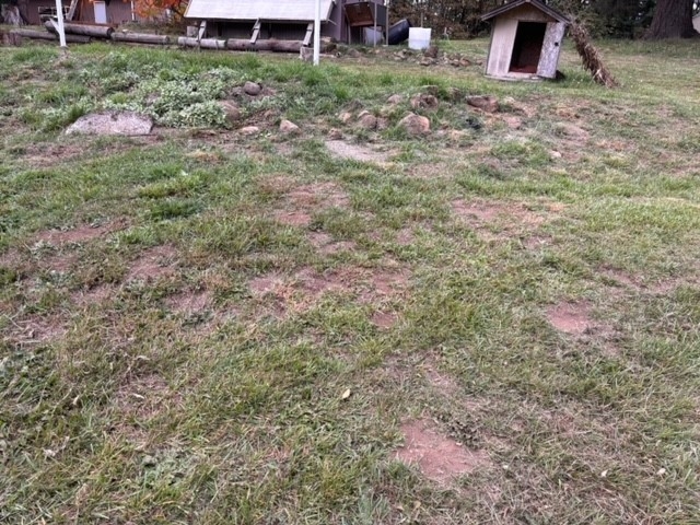

It would be helpful if you posted some pictures of your property.
Disclaimer: Tried my best on these - but I'll try to explain in captions. The property wraps around the house, so I focused on the larger areas and it's essentially more of what is captured below.
This is what it looked like when I moved here. Property extends to the tree line at the back. There is a fence overtaken by blackberry, not mad about it, but it has collapsed the fence and is encroaching in the summer.
One more - and you may see a small black dot in these pictures. That's my little whippet, he's the one that needs the grass short as he's known to run through, get ticks or other mischief.
This is after a light dusting, and you might be able to see details of the property more?
This and the following are from last night. Tried to capture the slope on this one. On the upper right corner, you can see a steeper incline where the earth has been piled up into a mound. This is one of the places that I can't get to on my mower due to the rockiness and slopes.
Beyond the walnut trees is where the former garbage burn pit is. I've already tilled up a couple piles of sod that I want to fill it with.
This is another retaining ledge held up by rocks. Naturally, I can't mow over this without destroying the blades of my mower - I want to turn this into a lavender field, as my vegetable / dye garden is adjacent to the area and I am trying to think of uses for it.
