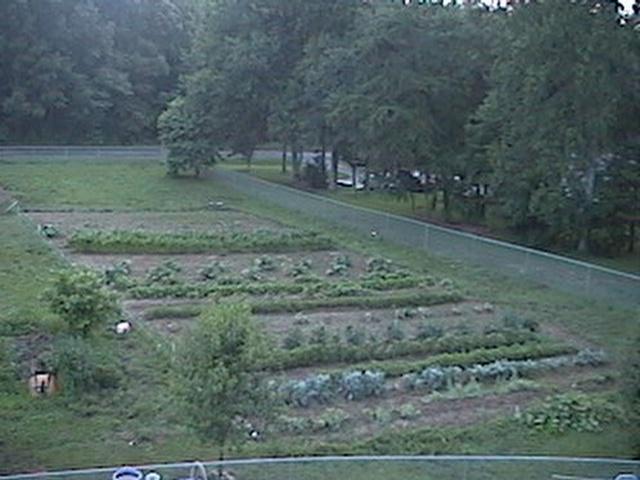

I've got a BX23 and a single bottom 12 inch plow and the tractor pulls it like it isn't even there. never pulled a 2 or 3 bottom plow but would imagine that the tractor would handle a 2 with no problem. I do a 1/4 acre garden and I was done plowing it in less than an hour onece the plow was set up.
/ Question on Plow size #14
oh and BTW I plowed it the length of the garden first, fertilize it then If I can find a decent disc this year, I am going to disc it, then use the plow to plow it across the garden and plow it up into rows. Plowing it into rows across the garden takes a bit more time because there is a lot more stopping and turning around. In years past I would plow and fertilize, then till it with a walk behind tiller (took forever, but was good exercise) then I still used the plow to plow it across into rows, then if I needed to I would hand rake the rows into hills for things like squash and melons that don't grow well in rows.
