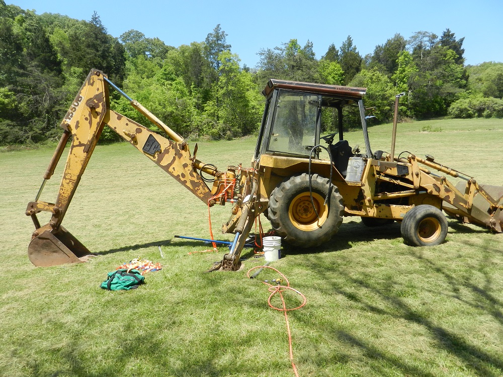

Jumped on the machine today to empty out the rocks we put in the front bucket. Had it beside the house, next to a pair of tree stumps the wife wanted removed.
Been a while since I've yanked a stump out so let's knock these out while the machine is next to them.
Got one out, other is half dug....and what to I notice?
Hydraulic fluid cascading down the inside of the boom.
The JCB has a square boom and the cylinder is inside the boom. The dipperstick resides on top of the dipperstick as does the bucket cylider.
So, the boom cylinder is going to be tough.
I've never done this but, the boom cylinder (and the steering cylinder) are the last two cylinders that have NOT been rebuilt since I've owned this machine so in fairness..... it/they are due.
Is the best way to remove the cylinder to dig a hole so the hoe can be extended downward or, will the cylinder come out with the backhoe laying stretched flat on the ground?
I'm guessing I need to angle the boom downward so I'm racking my brain to think of a location on the farm where there is a strong tree next to it that I can use to hoist it up. If the boom cylinder is the largest (as I'd guess it to be?) then I won't be able to handle it alone. I wrestled the dipperstick cylinder alone and it was just about all I could handle. I think if a butterfly had landed on it, that might have been just enough to wipe me out. (I had to raise the **** thing about five feet in the air to put it back in place)
Just thought of something.... the hole I dug to pull the stump out is probably 5' deep. I wonder if that would be deep enough to give me the angle?

From the look of your pic, I would think you could stretch the boom/dipper/bucket out all the way, shut it off, wiggle all the levers, then pull the OUTBOARD pin (I can't see it in the pic), then start it up and RETRACT the boom cylinder til the rod end comes out of the cavity, then shut it off, drain the hoses/cylinder into a bucket and go from there.
Maybe a closer shot showing where the cylinder pins are?

OK, just blew up your pic and found the upper boom cyl. pin - :eek: -
So, is your boom completely boxed in up to where the dipper cylinder attaches? If so, I think you're right about finding a big hole.
What (if anything) does your new manual have to say about this? I've seen a lot of wierd designs in over 50 years in several different occupations, but at this point I'm REALLY glad none of them involved JCB stuff :confused:
/ Question on JCB swing cylinders #64
It doesn't look that difficult to me. Your hoses are exposed, so that makes it a little easier,
I would just lay out your boom and dipper flat, disconnect your boom cylinder pin and retract your cylinder closed, disconnect your hoses and pull it out.

Took machine over to the pond and laid the hoe down the slope.
Yeah....definitely looks like this will work without digging a hole.
Since it is sitting about chest high it might still be a bugger. I've got a couple extra hoses laying around 'just in case' but, I don't have any extra fingers laying around. Looks like that hurt and hurt for a while.

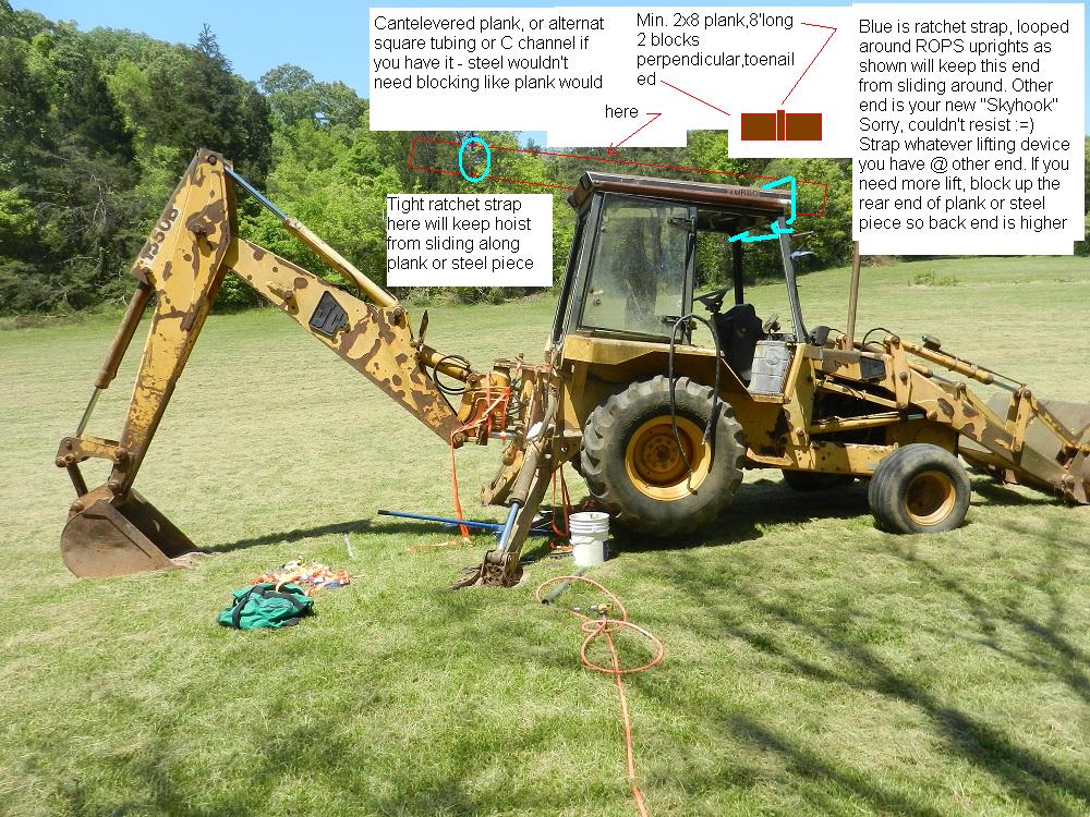

Dang file upload is broken AGAIN :mad: Shoulda known if I marked up your pic it'd be a waste of time...
Lay a 2x8 on top of your ROPS (on edge, front-to-back, front end hanging over about a foot, rear hanging over about 4 feet - toenail two blocks @ 90 degrees to keep it from tipping over - ratchet strap the front end around both front uprights TIGHTLY, rear will probably need it too- (if you have an 8' long piece of steel, either square tubing or C channel (NOT angle) you could use that instead)
If your new "Skyhook" :D isn't high enough over the boom, you could block the rear of it up some -
Tightly ratchet strap the come-along where you need it, or it may try to slide along the beam, especially if the beam isn't level..
If you need more, PM me your email and I'll send you the marked up pic... Steve

Steve, I think I'm getting your idea. Sort of creating a crane from above. Nice idea, don't think I would have thought of that. Am still thinking it through. (not sure I have enough parts on hand to make it happen either)
Right now, I'm thinking on connecting one end of the cylinder to the come along (while on truck). pull it out and then connect other end to other strap. Basically letting the truck keep it at bed height instead of taking it to the ground and raising it back up.
Then doing it similar to how I did the swing cylinders, raise one end up & tighten it. Go to other end and do same...

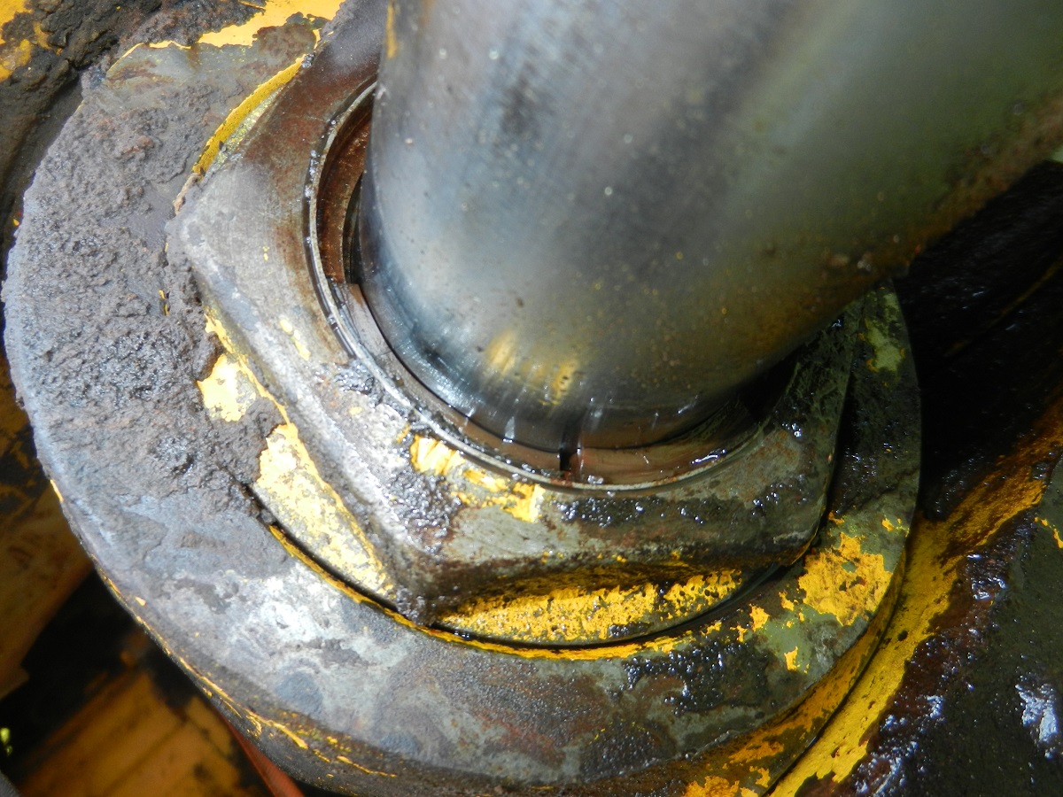

Got the cylinder home yesterday. Went out to start the process of how to reinstall it. Ultimately, the process took about 5 hours which included a couple breaks.
When greasing it, I noticed grease squirting out the sides.....fine & dandy. Upon having it off the machine, I discovered the pin was dry as a bone. The grease was squirting out between the spring bushing & the ram hole, never making it to the rod.
I decided when I got it home that I'd take the bushing out and see what's going on in there.
Long story short, there is a small indention (call it a "V" groove for simple conversation) in the outer circumference of the bushing. I'm guessing this is the channel that the grease will take to get to the hole or slit and then work its way to the pin.
These little channels were filled in with all I can describe, dried grease. Most of this stuff flaked out like drying paint.
I took a wire brush to the entire inside/outside of the bushing, brushed the entire pin and brushed the hole in each end of the cylinder where the bushing goes.
Got it all assembled last night at dark. Machine still sitting there waiting new grease. Might do it today if I can get to it, otherwise probably do it this weekend. This however, brings up a concern about all the other pins. I might take each one out (one at a time) and remove the bushing to clean the entire assembly. It was quite a surprise to think all this time, I've been greasing it but it might not be reaching the proper area.
