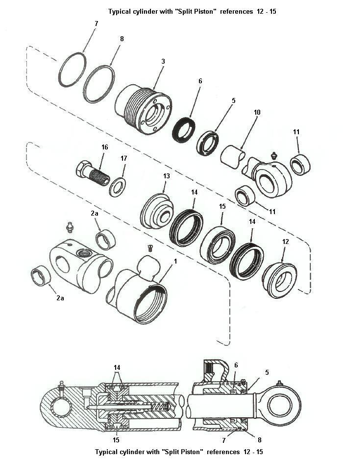

This is what Case swing cyls look like
New Swing Cylinder 580C 580D 580E 680G 680H 680K Case Backhoe 1346044C1 | eBay
As soon as we can see YOUR PIC :licking: we should be able to verify this... Steve

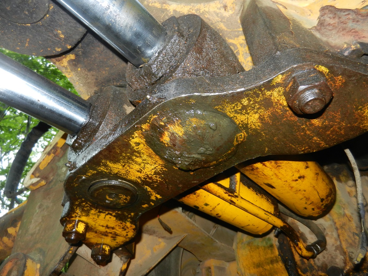

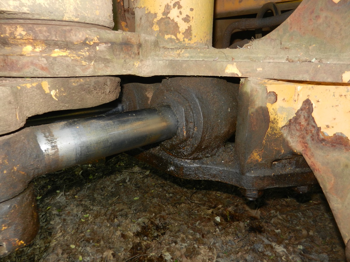

Had to recharge camera battery.... :rolleyes:
Here's pic of the end nut and the underside.
You can see the 'mushroomed' pin on the right and the other shape on the left. I've not banged around on it to see if the right side might be a cap and the left side is missing.... I've just got down on one knee and cranked my head around like Regan to try & see up. Finally, I just (blindly) took the camera and tried some pot luck shots.
Looks like the end nut is just a hair under 4" across.
What kind of wrench to you use (if I do it myself) to take those off? A huge pipe wrench? Buy the 'correct' wrench from the dealer and have something I'll probably never use again?

OK, yours is pretty much upside down from the way Case does it - on mine, the lower support plate is one piece with the support frame and the upper plate is a glorified C channel with the trunnion caps welded into it - that "c channel" is bolted to the support frame at both ends, IIRC the bolts are maybe 3/4". Also, my cylinders have totally different glands (the removable end that the cylinder rod pokes thru) - I would LOVE it if mine had that big a** nut on 'em, but instead Case decided that 4 wimpy little 5/16" holes in the end cap (gland nut) were good enough to stick a spanner into and unscrew a 4" diameter LONG-threaded cap after it's been in service for a couple decades :confused:
If I were working on your JCB, I'd first find a manual for it - usually they will at least give you some sort of idea what you're gonna run into, which can be somewhere between "slightly helpful" and "Lifesaving" :rolleyes:
Then I'd crank my pressure washer up to about 3000psi and clean all the crud off the cyls and immediate area - your pix look to me like the gland nut MIGHT be the full diameter of the cylinder tube, I can almost see/imagine a crack going around the cylinder about 3/8" from the face of the cylinder cap (gland)
Either way, if my biggest pipe wrench would fit I'd try that, without a cheater first - if not, I'd plasma cut a chunk of 3/4 steel plate into a wrench head with maybe a foot long handle 2" wide and slip a 4-5 foot piece of trailer hitch receiver tube over it and go from there.
From there (in my experience) it stands a good chance of getting pretty ugly - a couple of the cylinders on my Case I had to retract the rod (keeps the piston seals away from the gland) then heat the whole circumference at the gland a dull cherry red (don't even try this without acetylene torch, propane torch will NOT get it hot enough) - Then, while it was still hot enough I shot some penetrating oil along the crack til it quit catching fire, slipped a 4 foot piece of pipe over the handle of my 3 foot pipe wrench (heavy welding gloves unless you like 3rd degree burns)
The gland nut FINALLY started to budge, which gave me a bit more room for penetrant - at last it came apart, I let it cool and dug/scraped/polished the burnt up seal materials from the open end of the cylinder (rod still in it) then pulled the rod/piston out with a comealong, cleaned a bunch more, then put it all back with new seals.
Most of this type cylinder needs the piston-to-rod connection torqued down to around 400 foot pounds or more - I used my 3/4" impact wrench to R&R, you do NOT want the piston to unscrew itself inside the cylinder...
Considering that I have no idea whether you have welders, big tools, comealongs, etc, if you DON'T then you may be ahead putting a floor jack under your bottom plate, cleaning up the threads on those 4 bolts, and (carefully) dropping the whole thing - I can't really tell if your hydraulic fittings are accessible, hopefully they are and should be removed BEFORE you do anything else.
Where I'm going with this is farming the job out to a pro hydraulic shop - if there's one in your area, they would be a good outfit to make friends with whether for having them do the job or for some useful suggestions.
BTW, if you go the pipe wrench route I would NOT recommend Harbor Freight - their pipe wrenches seem to have too soft a jaws and will slip off under high torque. The price of cylinders like these, even USED, will scare the crap out of you - ones for my Case typically run $6-900 on flea-bay USED. Also, a REAL pipe wrench in larger size can run you well over $100, possibly $200.
If it comes to it, better to pay a good hydraulic shop a couple hundred than mess up due to improper tools.
Hopefully I've given you a few options that'll help - or at least a good reason to run away :D Good luck... Steve
Oh, forgot to mention - the bottoms of your trunnions look like they had a domed cap tack welded over them, and the one on the left either fell off or got removed at some time. I see zerk fittings that appear to be in the right place to lube those bushings.
Also, when/if you put it back together I would suggest finding 4 more nuts for the ones holding the support - the threads sticking out like that are a good candidate for getting mashed; a second nut would protect them so you can get the main ones off without having to re-shape the threads or destroy the nuts/studs...

The gland is the screw-in (or in some cases) the snap-ringed in part with the hole in it for the rod - the piston is typically bolted to the inner end of the rod - so how would one go about removing just the rod by pulling it thru the hole in the gland?
Seems like it'd pull pretty hard trying to get a 4" diameter piston thru a 2" diameter hole... Steve

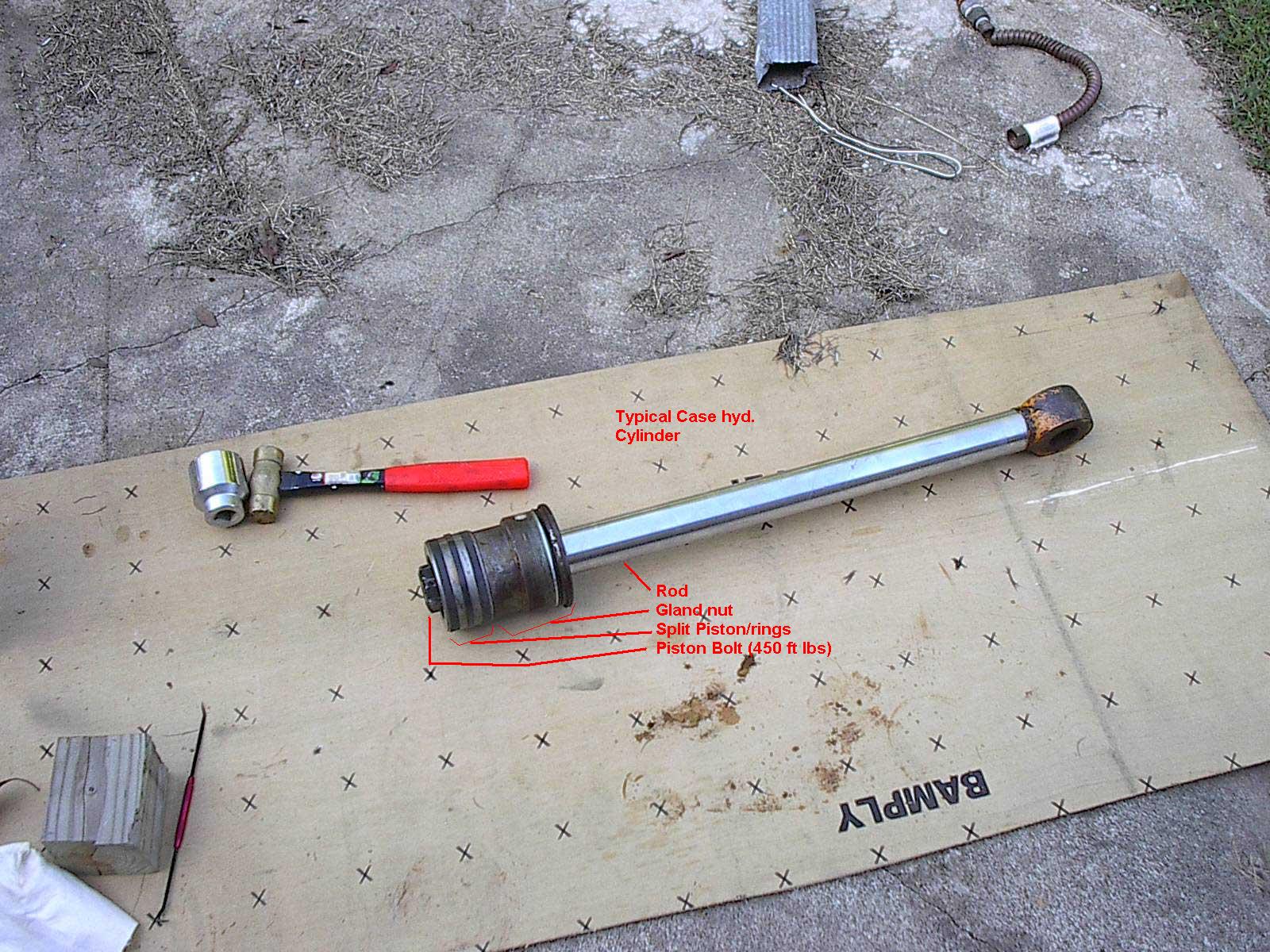

Here's a typical Case cylinder (not a swing cylinder, but same internal design)hyd-piston-assembled-2.JPG

"I would expect to unscrew the end cap (pardon that I don't know all the correct terms for their respective parts)."
I tried to clarify some terms in the marked up pic.
"Once the end cap is unscrewed, I would anticipate seeing something like the picture above. Some more of the cylinder rod with the "piston" at the end and several gaskets on the piston."
Correct - except those gaskets would be called "rings" or "seals"
"I would imagine, the gaskets get wrestled off somehow, new ones installed and the whole assembly gets reinserted back into the cylinder, screw the end cap in and "done", easy peasy."
Correct, except for the "easy peasy" part - usually not so much, due to heat/cold cycles, time, being put back together previously without anti-seize lube on threads, etc...
"I don't understand the comment above about pulling a 4" piston through a 2" hole?"
This was probably due to Billrog/my misunderstanding of terms - What I meant was that, unless you take that gland (AKA "end cap") out, you cannot just take out the rod because the piston is (hopefully) still attached to the rod, and the hole thru the gland is only the diameter of the ROD, not the PISTON.
"I would think the whole ensemble would come out with the end cap dangling during the process."
Correct.
"I wouldn't need to actually remove the piston from the rod would I ??"
Sorry - I am ***-u-me ing you found the leak because it's EXTERNAL (dripping) rather than INTERNAL (can't see it but cylinder is weak operating, bleeding past the piston seals) - if so, then the main seals you need to replace are the ones INSIDE THE GLAND - and the ONLY way that can be done is to completely remove the rod from the gland once you've removed the "whole ensemble" as above - hyd_cyl_split_piston.JPG
And that requires removal of the piston from the rod, since the welded end of the rod won't go thru the gland and the OTHER end can't either, unless the piston is removed.
Item# 5 is the front wiper seal, #6 is main seal, and there is sometimes another rear seal (not shown in diagram) - ALL these must go INSIDE the gland, which can't happen unless the rod is out of the gland. These are the items that will cause an EXTERNAL leak if bad -
Also, in some cylinders (older Case, for example) the piston is split (see items 12,13,15) - regardless, since it's likely your GLAND seals are bad, the piston has to come off the rod in order to get the rod out of the gland.
From an optimist's point of view, you might NOT have to remove the cylinder BODIES - I didn't when I did the swing on my Case - I centered the boom, pulled the pins that hold the rod ends to the swing tower, unscrewed the glands, broke hydraulic connections so pistons could move, hooked a comealong into the rod eye and pulled the entire rod/gland/piston out of the cylinder tubes.
Next - big vise, big table, smooth metal "shoes" over vise jaws, grab ONLY the flattened sides of the rod end, 1-1/2" impact socket/big air impact gun, remove nut retaining the piston, slide the gland off the rod, match up new parts in kit to what was removed, reverse the procedure to re-assemble.
NEVER touch the rod with anything metal - any part of the rod that isn't perfectly smooth will cause you to start OVER with new seals :confused:
Also - the Case cyl's use an internal rod seal (item#6) that's usually a BEAR to get in and out - it goes into a deep groove inside the gland. Getting the old one out will usually take a couple of "hook picks", something like this
Pick and Hook Set 7 Pc
Getting them out isn't usually as hard as getting the new one back in - my method for that is (1) dunk the seal in nearly boiling water for maybe 10 seconds to soften it - (2) as soon as it's not painful to touch the seal, grasp it on one side with thumb/finger, then use SMOOTH-JAWED (no sharp edges or serrations) pliers and grasp the OTHER side of the "donut", and TWIST the seal (in the same plane, this will cause the part between your fingers to become smaller diameter, with a small "inside out" half-circle where the pliers are) - then, holding the seal in this "omega" shape, insert the part held in your fingers into the big groove in the gland, twisting the pliers back and forth til MOST of the seal is where it belongs - finally, smooth out the seal with a finger so ALL of it is in the groove.
Re-assembly - wet a finger with hydraulic fluid and pre-lube the seal and wiper before attempting to insert the rod back into the gland.
I may have forgotten a step or two, feel free to ask about anything that isn't clear... Steve
