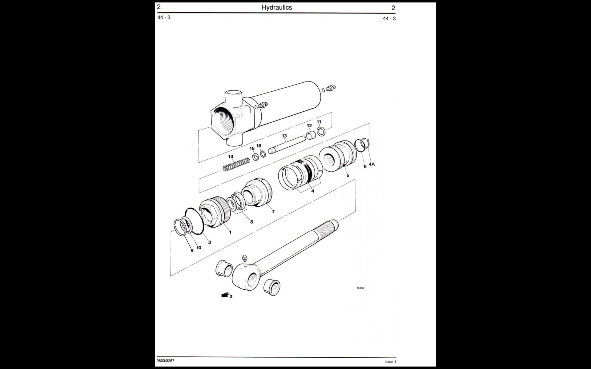

Aside from that.... I found a service manual. Big help. I think this answers most of the questions regarding the trunnions! (had I only seen this earlier)

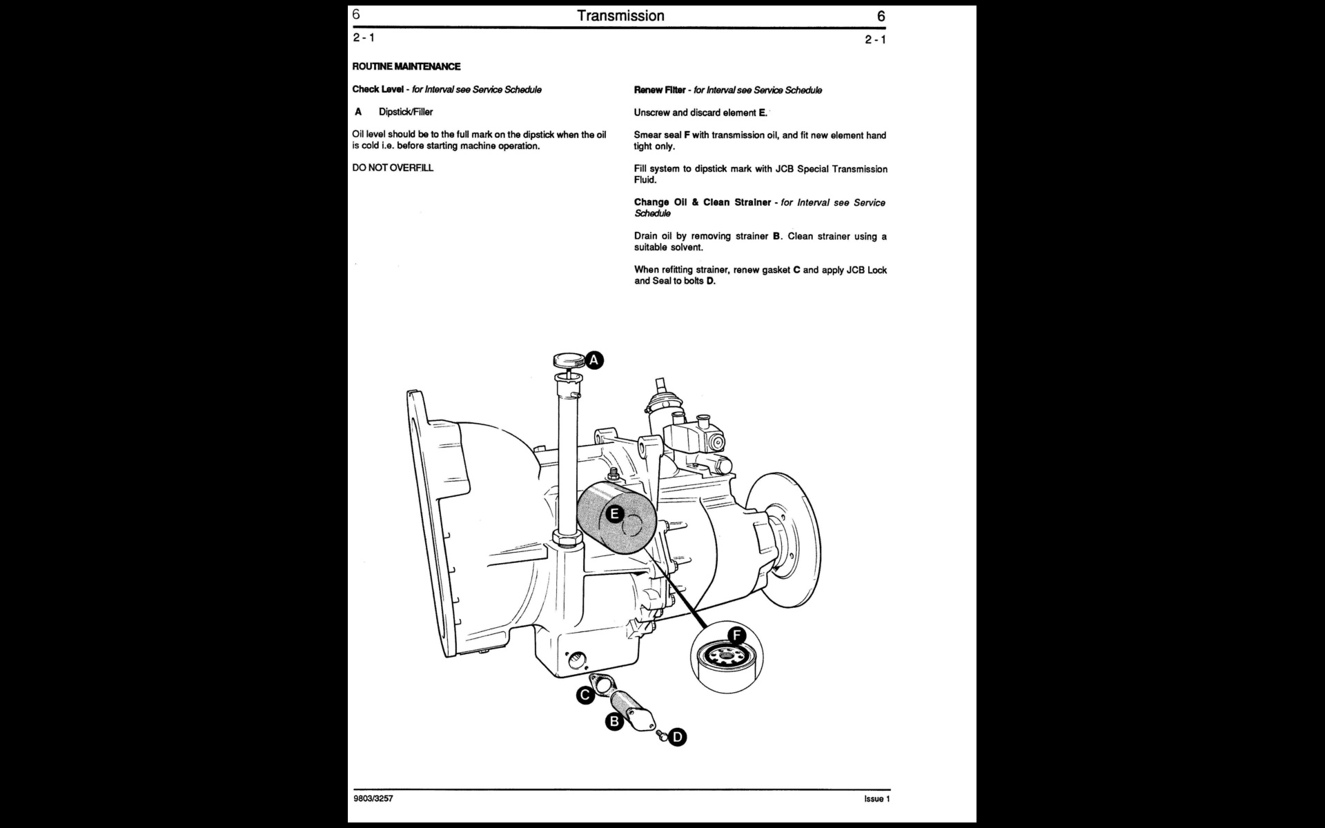

I found this. Looks like you take it to the mark with the engine cold.
Interesting thing for me is, my dipstick isn't a traditional dipstick.... it's more like a coiled spring (think of a sink snake) Hard to describe. I have never ever seen a mark on the stick to get a reference point.

Looks like your piston threads onto the rod and is held from coming off by a snap ring - has a spring plunger "shock absorber for end of travel. Also, it appears your gland is two piece, should make it easier to get those inner seals in place.

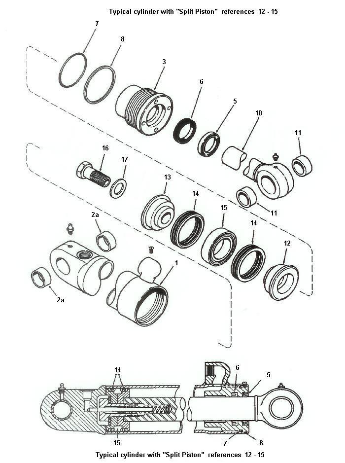

/ Question on JCB swing cylinders #38
heres a pic of mine (#5), yours "may" not have one but usually JCB's have them.

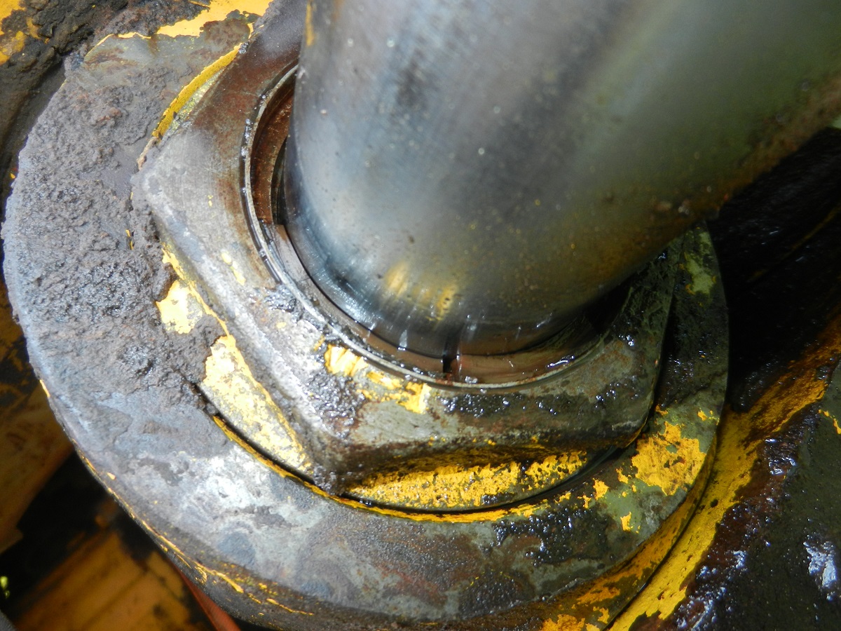

that said, I started getting things organized yesterday. Tried to break some crud off with the pressure sprayer.... tough going! I think I'm going to remove the cylinders and then spray them again.
I did find what I believe to be the source of my drip....
Preparations: Cut field yesterday. Did initial pressure wash of back end of machine (went over a lot of the machine)
Got three of the four bolts loosened that hold the plate under the cylinder. Last nut is TOUGH!
Hoses off....draining some of the fluid into a container.
Straps holding the 'hose' end of cylinders up so when the plate is removed, the back side will be supported along with the ram being supported in the hoe.
Floor jack is out there & waiting. Getting ready to eat breakfast and then get dirty. :)

Skyhook, thanks for the diagram of your cylinder - two quite different designs, yours uses that allen in the groove at the inner end of the rod to keep the piston from backing off - looks like Richard's uses a snap ring of some sort. As you said, since it's going to a rebuilder it doesn't matter... Steve
