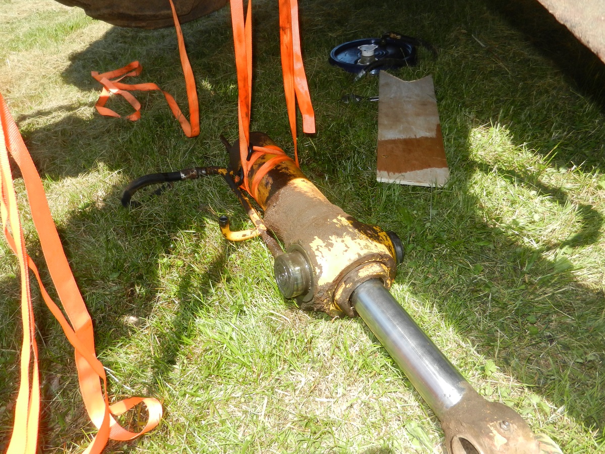

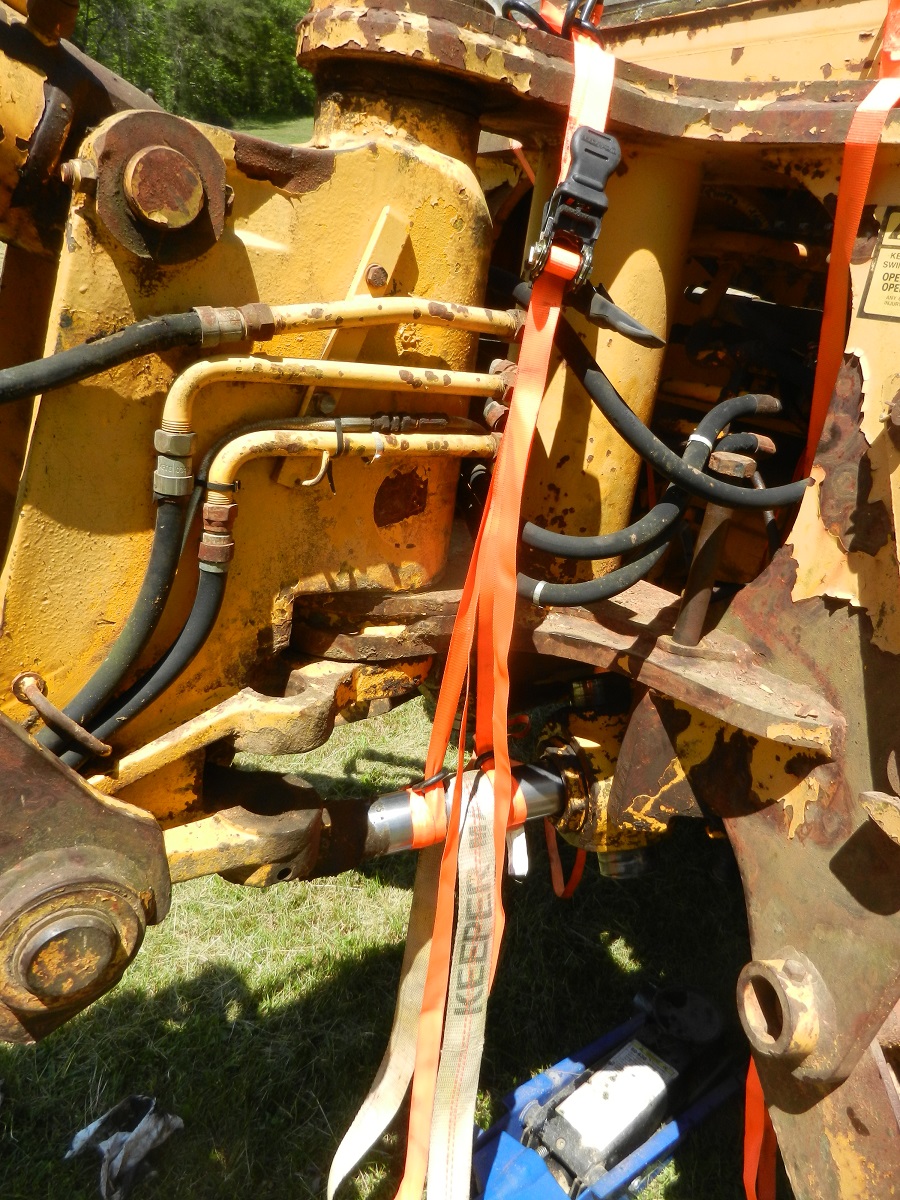

Ok, so the buggers are off.
Put 4 straps around them....2 in front....2 in rear.... used the straps to sort of 'ratchet' them down, one at a time.
Found out that with the ram in the hoe socket (even if not pinned) that helped act like a lock with the trunnion in place. Had to do some twisting & turning to get them out. I think it will be much easier to put them back up collapsed and then used the hydraulics to align with the pins (after they're fully mounted)
Here's some pictures of how I took them down (alone, without any help I might add)
Right now, I'm looking to try to do the same thing in reverse when I put them back.

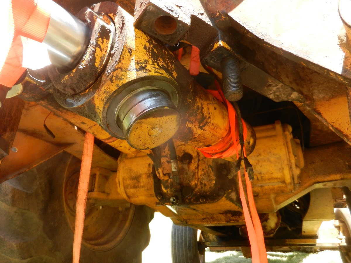

Ohhh... I meant to add... there are the four bolts that hold the bottom plate in place. I'm sure I could reuse three of them with zero issues. I "think" I could use the fourth but truth be told.... it was a bugger to get out. I'm guessing there was some crossed threads in there but they were minor. My impact wrench was able to handle three of the four (it's pretty heavy duty).
I had to use the pipe wrench with cheater bar to take the last nut 90% off, then the impact would get it.
I might replace all four of them just to have peace of mind.

Well, I don't see any extra body parts in the pix so I'd say it went OK :D
Also didn't see a board for the jack to roll on, or is it just not in the pic?
Those 4 bolts are technically called studs - as in, no head, threads on both ends - a LOT of those have different threads on one end than the other - typically coarse on one end and fine on the other. IF you can find direct replacements, I would also replace them all, and if the new ones have more than 1 thread protruding past the nut I would still double nut them.
No way would I re-assemble that part without anti-seize on the outer threads, and at least loctite blue on the ends of the studs that go into the main frame. Best way to re-install studs is to double nut the end that's NOT screwed into the plate, lock the nuts together HARD, then use a wrench on the OUTER nut to run the stud into its socket tightly. (It helps if you have a bottoming tap of the right size to clean out the holes first.)
Then you can hold the inner nut with one wrench and back out the outer one first, repeat all that til all 4 are back in place.
Hopefully all I saw on the surfaces of the rods was removable crud, and NOT rust pits - ANYTHING but smooth chrome on those rods and you'll soon be REALLY well-versed on this job :confused: - because your brand new gland seals will last maybe 8-10 hours of use and start leaking again, especially if any roughness PROTRUDES from the smooth surface.
If you're good on that condition, great - otherwise you may wanna ask your hydraulic shop about rechroming.

Actually, those 4 are indeed bolts. Though I didn't measure, they're about 12/14" long and about an inch in thickness. (though I'm sure they are in MM's)
In the first picture above, you can actually see where I raised the bolt to get it out of the way from the cylinders under it. I didn't want to hit it and bugger a cylinder or the threads. I was thinking the two were bolts and the rear two are studs.... until I tapped on them and got one of the rears to raise up a bit (lots of dried mud holding it in)
I have one of the bolts in my trunk and will find out about replacing them tomorrow. Also have the lower trunnion "cap" (or whatever it's called) in the trunk. Going to see if the dealer can tack weld one of those caps on for me. I noticed that the side with the cap had held some grease in it while the other one.....

I actually did use the floor jack. It was too small (short) to reach since I have the back end raised. I cut a 24" piece of plywood and cut a "V" in one end.
I set it vertically on the jack and put the "V" onto the cylinder end of the cylinder. Used it to jack it up a bit when I was trying to loosen them from their mounted position. I tried first to get on my back, use my foot to raise the back end of the cylinder while messing with the ram end. Realizing this was a bit precarious.... I decided to be more rational.

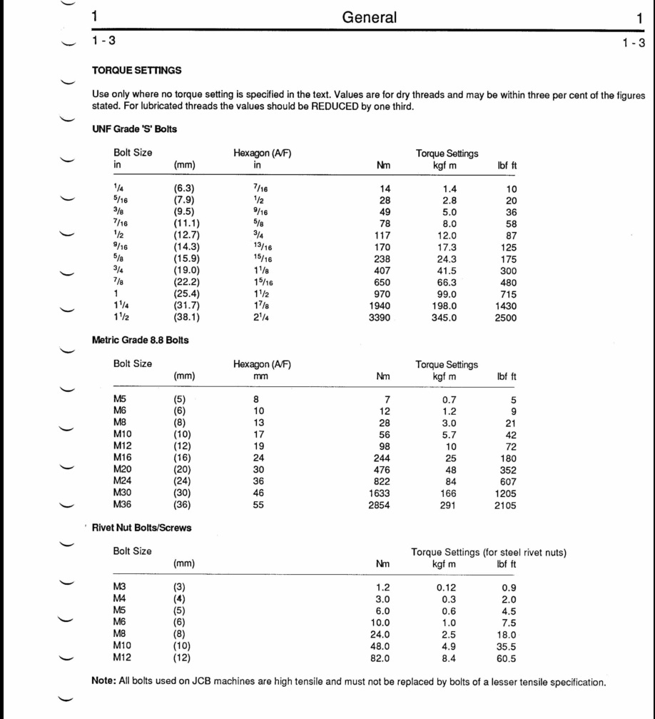

Question.... I've not measured the bolt but it looks like it's about 1". The absolute size of it isn't relevant to my question.
Here's their torque chart.
If it is the 1" bolt, it calls for 715 lb/ft torque or, "for lubricated threads, REDUCED by one third"
What would be best used to lubricate them?
I've read things online stating that motor oil might be the best (which I found intersting....then again, "I read it on the internet")

I read the entire page, and I would still use anti-sieze, just lower torque values - especially with the size fasteners you're talking about - in 35 years of heavy industrial maintenance I only saw a handful of problems using anti-sieze, and most could be attributed to ham-handed macho crap.
On the other side of that coin, I rarely saw NON anti-siezed fasteners come apart without damage requiring replacement - although to be fair, mine was a pretty toxic atmosphere - various acids and gases that (in many cases) required face shields, respirators, etc...
On my own equipment (the list on my profile is a small drop in the bucket) I always use anti-sieze except on hydraulic fittings, and have never had a problem with fastener damage that could be attributed to it - I do tend to under-torque somewhat, but not much. Being able to take something apart and put it back together without either a trip to town or ordering parts online is more important to me, sounds like it would be that way for you also.

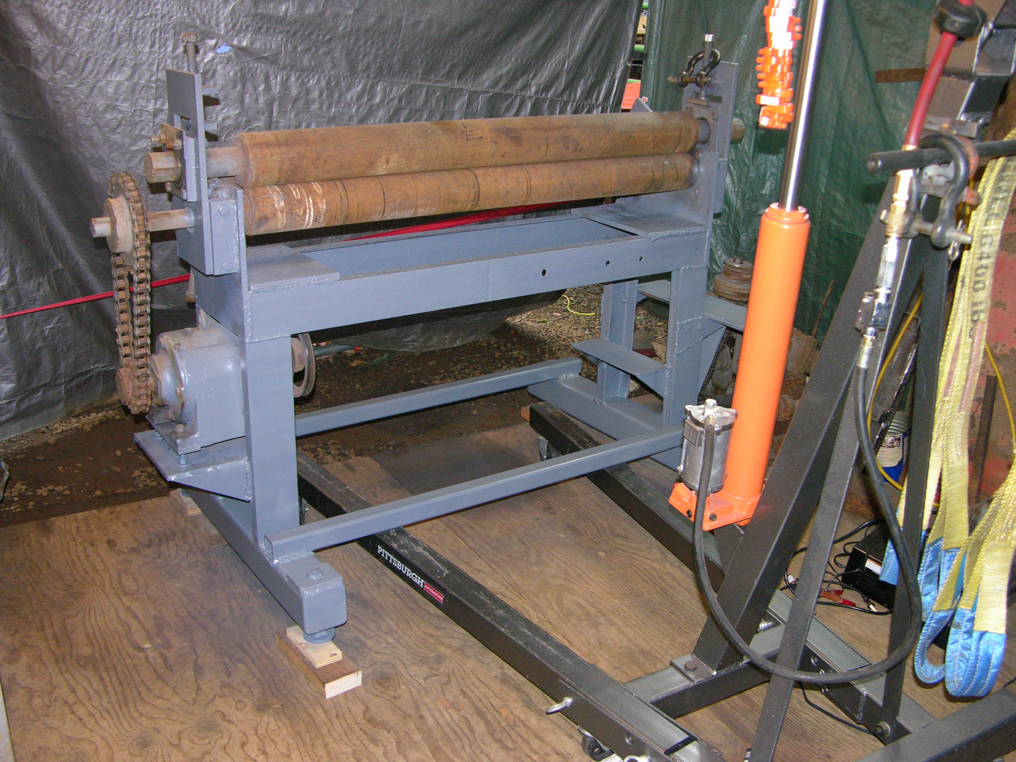

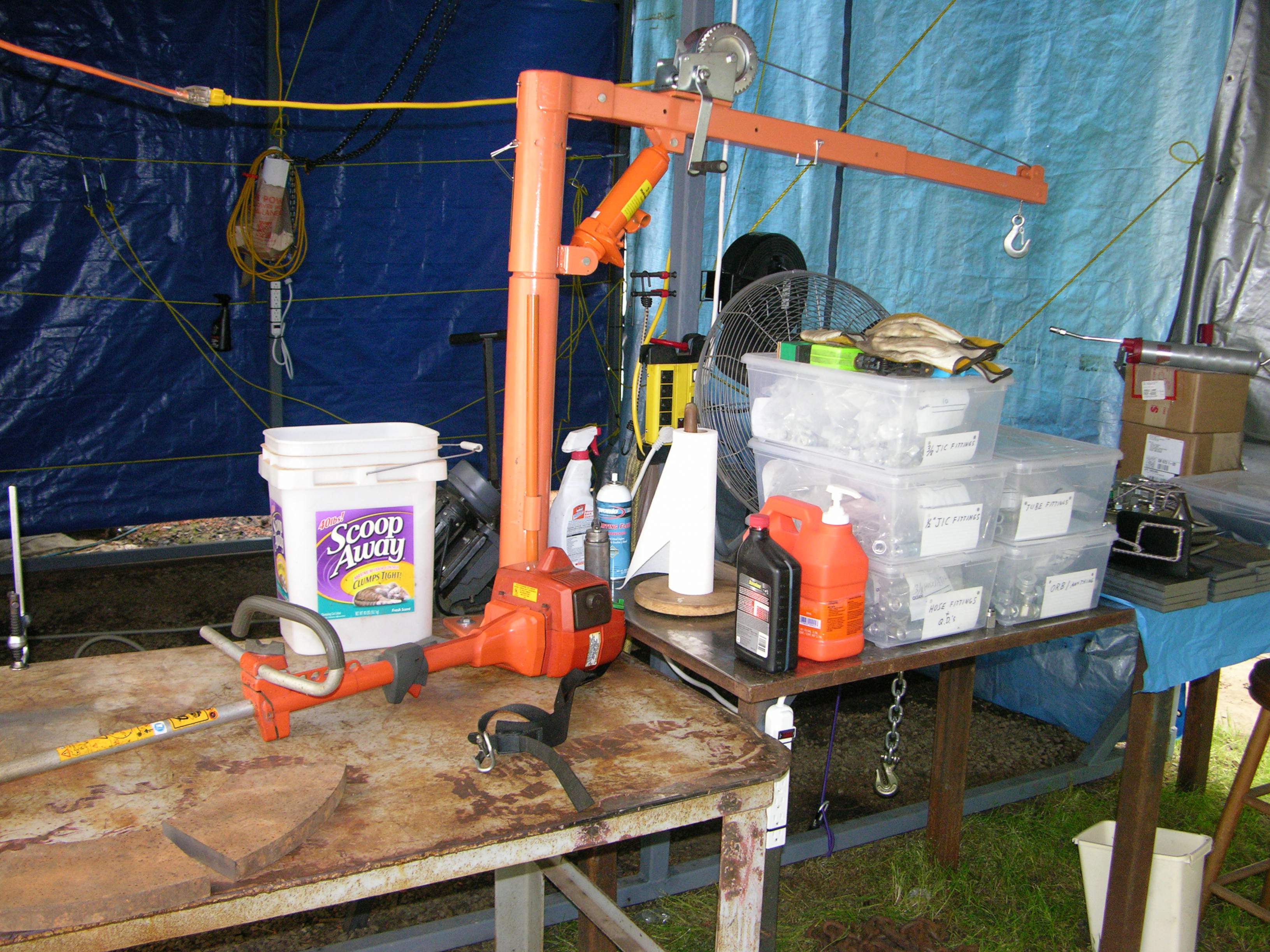

Here's a pic of the cherry picker helping me to fab a better base for a CL find - this slip roll will handle 1/4" plate without a grunt, and will roll 1" steel up to at least a foot wide. Note the replacement air/hydraulic jack on the cherry picker - DSCN1243.jpg
Here's the pick-up shop crane mounted on a 3'x5' steel table - DSCN1284.jpg Eventually I'll replace the PITA winch with an electric one, it's kinda hard to reach but it still beats using my back...
Hopefully some of these will help you get things done easier - I know how much I rely on them... Steve

Saturday I drove my car into the field and lifted a cylinder to see if I'd be able to lift it. I could, so I pulled them out. Knowing this, I decided to see if I could put it back single-handedly. My neighbor wasn't due home until Monday night.
Stood cylinder on end, put a strap through it to hold it high. Put strap on other end and raised it with one hand while tightening strap with other. Worked fairly nice.
Main issue was the cylinder pivot really wanted to be VERY aligned with the pivot hole before it would go in. This caused some wrestling with it, lowering it, raising it.... cussing a bit. Finally got it in and tightened both straps to hold it.
Repeated same process with second cylinder and got it mounted.
turns out, this was the easy part.
The steel plate that bolts on underneath the cylinders.... well, this was the bugger.
It has four bolt holes so we have a pattern to match. Then, we have the two holes for the pivots of the cylinders.
I had two bolts installed and nothing would line up enough to make anything work. meanwhile, the plate (I'm guessing 50/60 pounds?) was wearing me out since I was trying to lift it while wrestling with it. It fell out of my hands many times. My focus was to not have it fall back on me.
keeping myself intact was pretty high on my list during this process.
finally, I made a quasi-sling so I could try to hold it with the sling while adjusting it with a free hand. This too, basically failed.
I finally took all but one bolt out to lower my alignment points. finally got it started in the right place so added a second bolt and threaded them with the nuts to at least keep the steel plate suspended and my hands free to do other things.
Got it mounted, torqued and greased up.
