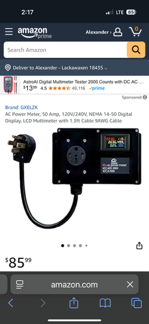

Finally bought new generator Westinghouse 9 kw. Installed manual disconnect switch with 50 amp cable so the whole house will be supplied during power outage. Would be nice to monitor output wattage... Found this on Amazon
The problem is 10 awg cable. 10 awg supposed to support 30 Amp. Sent txt to the seller and his answer:
"The short distance (1.3 ft) means that the resistance is low and the cable is resistant to high temp., so it can pass 50 A current".
I find it hard to believe. Any opinions? Are there other similar gadgets? Don't want to overload the generator.
Sounds like we have the same gen 7500/9000 been a good unit and has lots of hours. The question is why do you want to monitor output? You might look at it once or twice and after that not even notice it as all you really wantvis a house full of power. I also use a manual switch and it works good. I converted mine to propane. Never have to worry about old gas etc. Here in Panama we have 25 pound bottles, a little bigger that the BBQ size and i get 10 hours from it. 100 hour oil changes without fail after the first change at 5 or 10 hours to get and machine dust, bits out of it

Since your generator input will have a separate breaker in your panel, probably easiest to put a power monitor from the panel, since those wires are separate and easy to put the current transformer on. Amazon has a number of cheap power monitors that work great. I put two in a tailed-off box from the solar panel to monitor each inverter, and small ones on my generator panel and well panels. These are tiny and cheap, and were easy to mount on my generator and well panel... Pardon Our Interruption... And no, you won't notice the small voltage drop in the short generator cable, which will easily be able to absorb the small wattage loss heat generated. Amazon.com
Most power meters will also tell you the frequency, which is nice to know with a generator... just in case. Also, if you put in a meter box next to the panel, wouldn't hurt to put in a couple MOV surge protectors to kill any surges that may come from the generator... also, just in case. Insurance is always best applied while it's easy and cheap, and before you find out that you needed it. If you want to get even fancier, voltage protection relays are cheap now, will monitor and display the parameters, and drop out if voltage is too high or low, over current, etc.. I put one on my well to protect the motor, since we've had so many low voltage issues with the local power. Pardon Our Interruption...
