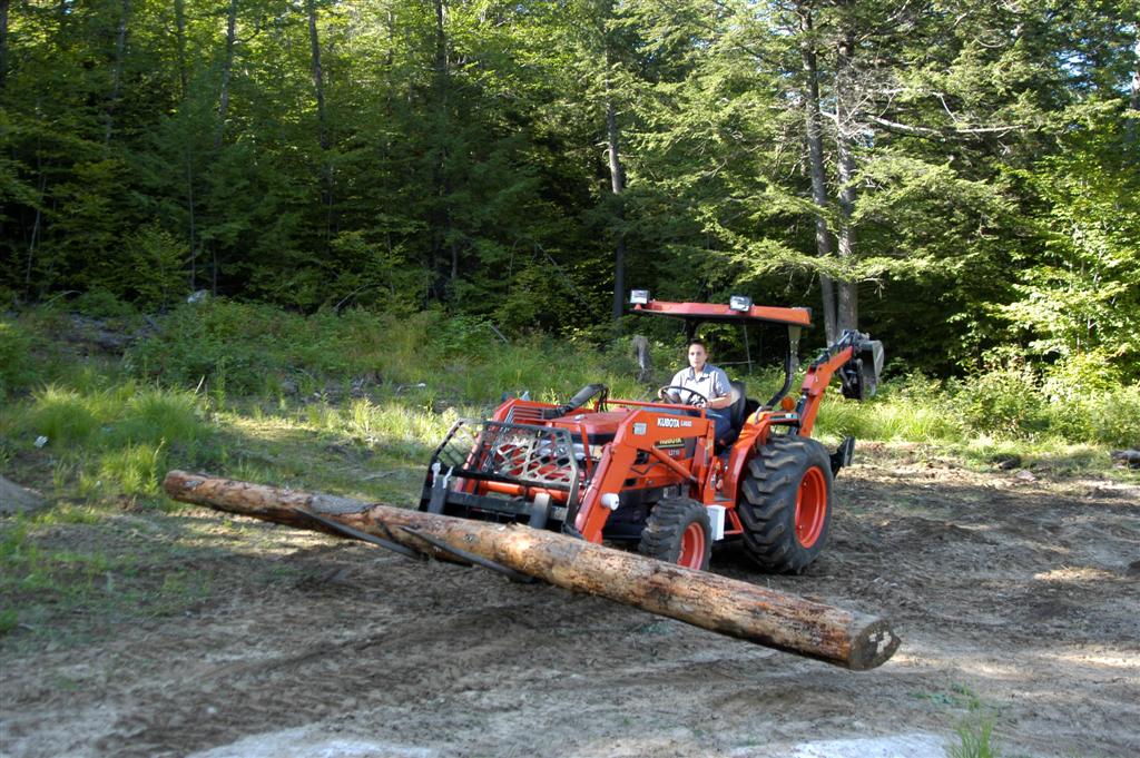

My solution

Forks are just cheating:)
He still needs the toothbar and grab hooks.... Oh yea I use forks for the same thing even though I have TB and hooks.

Look Again,the forks are only half the solution. The little woman is driving, I'm in the house watching the game

I am a little shocked you posted the pic "wider than the bucket." I hope those tires are loaded, but even if they are there is not enough ballast there. There is daylight under the left rear tire. Oh... and using ROPS with no seat belt on...:( That pic has the makings of a disaster. Cool attachments though. I have seen them on your website in the past.
/ Question Concerning Loader Methods #16

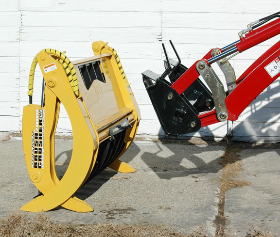

Thank you for bringing that BAD photo to my attention - I've deleted and reposted without the "wider than bucket" photo.
If you plan to move and clear logs, this is a unit built for just that. It attaches right to the end of the loader arms or works with your skid-steer adapter. It's just like putting fingers on the end of your loader arms. It eliminates the need for chains and hooks. It is much faster and safer way to transport logs, brush, fencing etc... and it grabs uneven loads securely. The unit on the end of the arms DOES NOT require extra hydraulics or ports on your tractor (approx. $750 to 1000). The skid-steer model will need to plug into a set of rear remotes (approx. $2100).
It is very important that you read an operators manual for your loader - contact the company you purchased it from. If you are new at operating your loader, you can get some great tips and a lot of do's and don'ts that can save you costly repairs. You can access John Deere loader/operator manuals online.

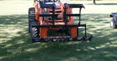

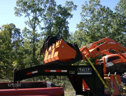

We recently purchased our first new tractor with an FEL. We decided to purchase a 66" grapple based largely on information I found on this site. I cannot believe how many uses there are for this implement. It is worth it's weight in gold in my opinion. The cost was around $1,450 installed, not including the third function valve. It is one implement that is definitely worth saving for and investing in. From a safety standpoint, it is much safer to move logs and such with also because you eliminate the opportunity for it to roll off. There are many manufacturers and there is a lot of info here, just do a search.
Here are a couple of pics for reference.
