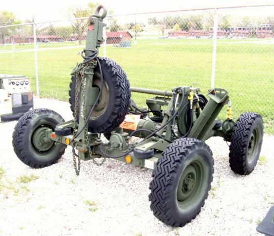

Rather than try to win any awards, if I had to reverse it I'd use the receiver on my front bumper. Here's what the M721 Dolly looked like at the auction yard. Complete unit, they connect together as a towable unit. They separate into two units, each one hooks onto one end of the container and it has the jacks to lift the container off the ground. Hard to imagine with all the containers for sale these are not coveted. This one went for $200 on Oct15, 2015. ALMOST wish I had the uncut version. Except then I wouldn't have a log trailer in the works, or tires for my Willys. RNR Don't you think dragging a 5,000lb container up onto a 5700lb capacity trailer, with a 12,000lb winch "seems feasible"?I already have the winch and the car trailer. I'd put blocks under the rear of the trailer so it doesn't lift the truck.
451876d1451339269-question-about-trailer-steering-m721-dolly-jpg
