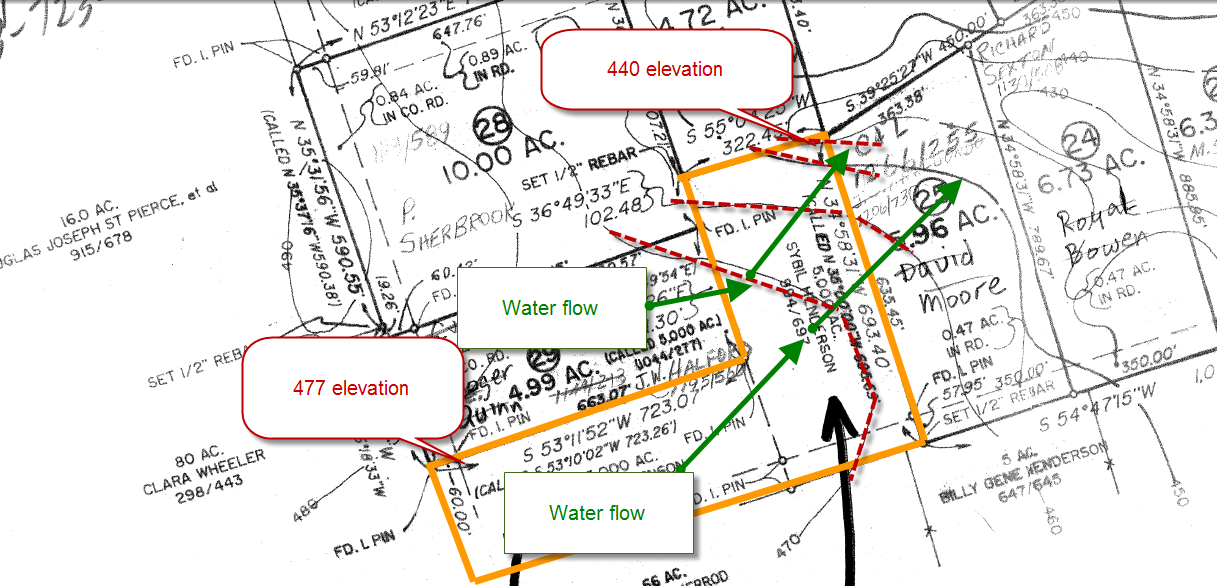

I hope somebody with more Google Earth knowledge can help me.
Can I discover the low and high points of my land by looking at the "elev" "ft" number at the bottom - middle of the picture?
Oddly the higher ground seems to have a higher number, yet given that the "eye alt ft" number remains the same shouldn't the higher ground have a lesser number?
Or is the "elev ft" referring to elevation above sea level.
Is the elevation figure accurate enough to guide me as to where the start and end point of a drip hose of say 200m (660ft) should be to minimize the friction loss over that length?
And how can I know when I'm perpendicular (directly above ) my land?

You can do it with Google Earth with the add on to make it a topo map
below is my land
Sorry I see your down under so I don't know if it will work as mine is for the lower 48 states. They also call it Trail maker software for hiking.
