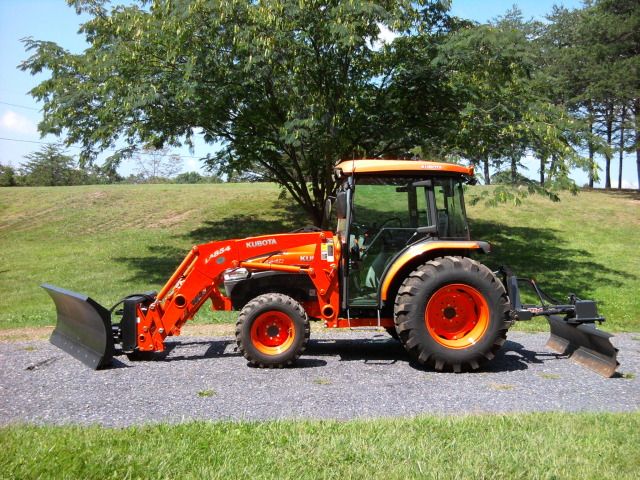

Thanks, I hope it will last forever. I would have liked to have found a old plow to adapt to the qa but I never could find anything worth buying. Everything was either over $1000 or junk. I did almost get a plow to put on the bx. Tomorrow I will probably see a mint meyer st-90 on craigslist for free. I am hoping it will work good with the tractor. I know you can feel the weight of it when you pick it up but not as bad a big bucket of dirt. I need to make something to hold the hoses on this plow and I want to get a set of markers for it. I am on the fence about adding a crossover relief valve.
/ QA Snow plow #22
Nice looking plow Roger,If it were my machine I would put a crossover relief valve on it,Cheap insurance against one minor mistake torquing your loader arms or bending plow parts.Good luck with it,I think you are going to like snow removal a little more this year.
Brian
/ QA Snow plow
#23
Nice looking plow Roger,If it were my machine I would put a crossover relief valve on it,Cheap insurance against one minor mistake torquing your loader arms or bending blow parts.Good luck with it,I think you are going to like snow removal a little more this year.
Brian
Thanks. I may add a cross over relief valve. My luck if I hit something it would be on the side it was angled too so the relief valve would do nothing.
