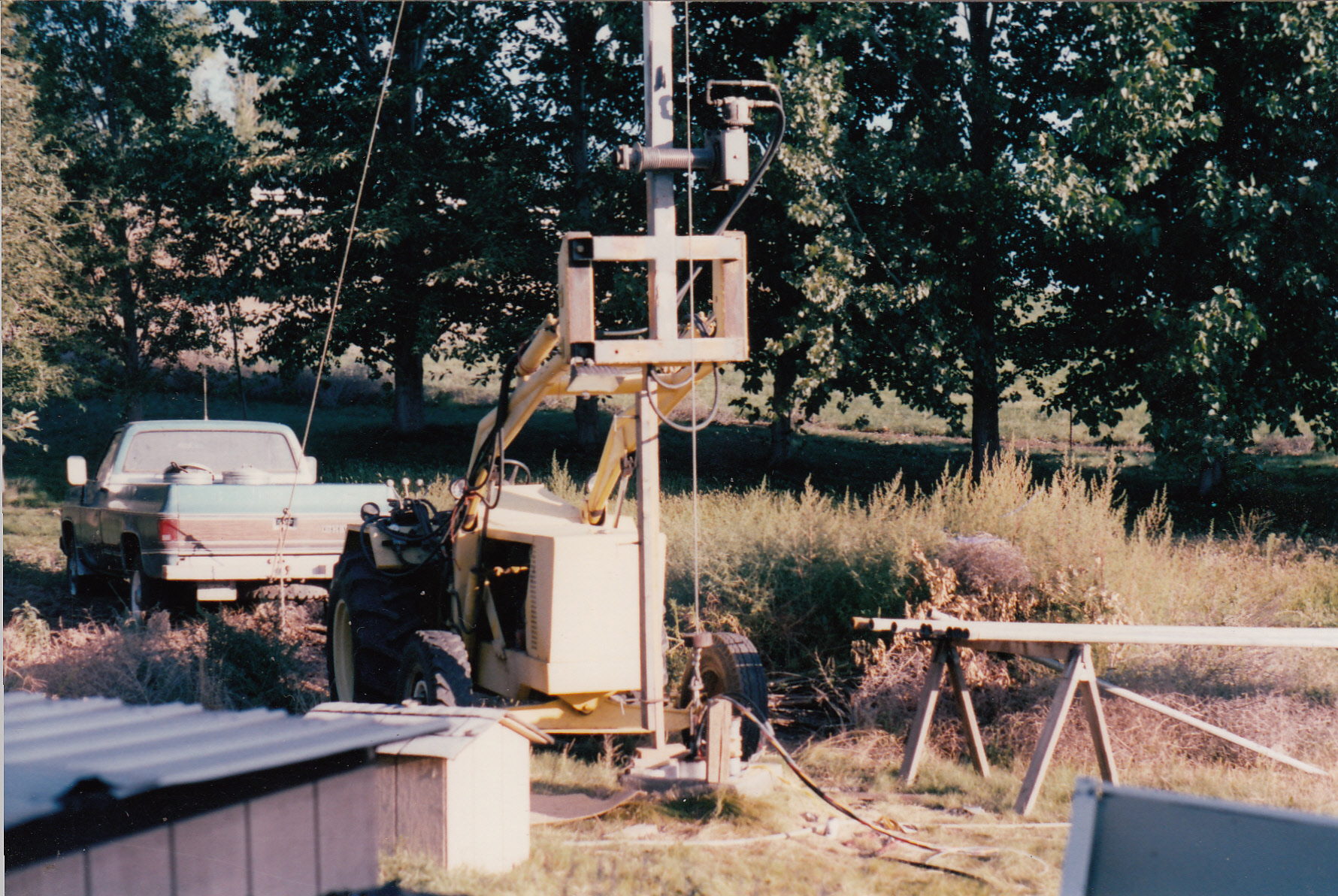

How did you run the hydraulic winch?
/ Q. Replacing a (very) deep well #23
Off the rear remotes on the tractor. I looked for a picture I have of it set up pulling the pump, but I can't find it.

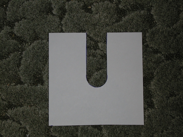

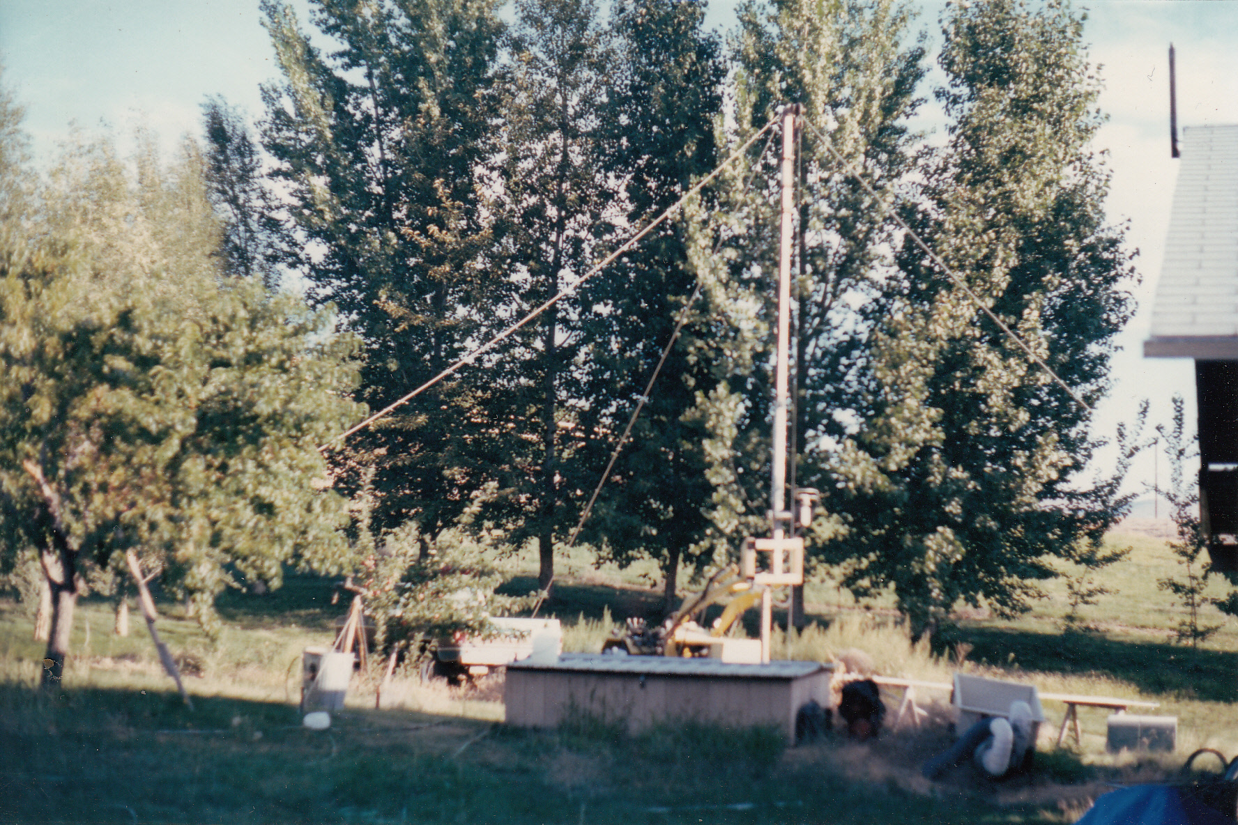

Don't know if this will help anyone, but I found a couple of pictures from 25 years ago. To hold the pipe up while unscrewing each piece we used a 1/2" plate like the piece of paper in the third picture. Just slip it over the pipe and the coupling stops the pipe from falling while you unscrew the piece up in the air. I used a 6" pipe nipple and welded a piece of 1/2" rebar formed into a U shape onto it to hook the cable to. The hook has to be able to swivel because you're going to be turning the pipe.

Pulled a few thousand pumps in my day. I applaud anyone who can DIY a 400-600' deep well, especially on steel pipe. The plate and bell method works very well. I used those for many years until I discovered elevators, which are much safer. With plate and bell you need a really good swivel. While you are unscrewing the joint you have in the air from the one setting on the plate, the bell screwed into the pipe 21' above will be trying to unscrew itself. If the bell holds by just barely one thread and you lift the pipe and remove the plate, the whole thing can go south in a New York minute. When that happens the wire you have nicely looped up on the ground or spool will turn into a hundred snares flying by trying to grab you, tools, or anything else close by and pull them down the well. NEVER stand close to the wire or have anything close to the wire the ENTIRE time you are working on the well pump. Always look up while unscrewing the pipe and make sure the swivel, not the bell threads are spinning. Also make sure as you are pulling the pipe that a foot of wire comes out with every foot of pipe. If you let slack in the wire it can cause the pump to get stuck in the well.
Pulling pumps is not hard as long as everything goes right. But when bad things happen the little tricks that a good pump man has learned over many years can make quick and easy work out of what could be a nightmare for someone doing it themselves. That being said, there are not that many good pump men anymore. If you can find one of the 5% of good pump men, he is worth whatever he ask. But you are probably better off doing it yourself than to use one of the other 95% of pump men that don't know what they are doing.
