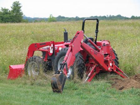

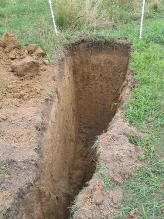

Here is where I rounded the back of the house. It was steep here so I had to be careful with support placement and how fast and high I moved the bucket. Turned out just like I wanted it to.

#22

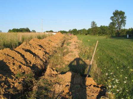

This is the last one for now. You can see with the placement of the tractor that I am making my way into the backyard at the south of the house. I'll have a few more obstacles here like our septic line and underground cable. Should be interesting! I'm feeling like Eddie Walker digging this much waterline trench! (That's a compliment Eddie btw /forums/images/graemlins/smile.gif ).
At this point I am at about 300' of 6' deep trench. More to come next week.

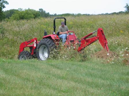

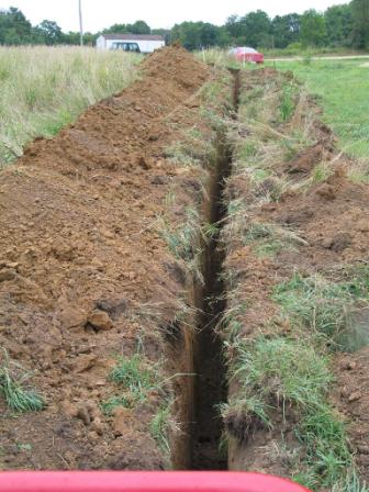

Made a little progress on this project last weekend. Here is a shot of the trench coming round the back of the house. The hose over the trench is the temporary water lines I used this summer. They're a big reason for the hydrant install /forums/images/graemlins/smile.gif.

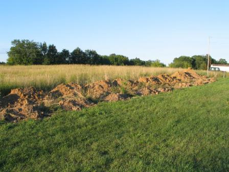

#36
2' sure would have been nice, but it sure gets cold here in Iowa! Kind of hard to imagine right now with it still in the upper 80's for September. That's about 10degrees above normal.
Gas prices and shortages made us reconsider our trip to the twin cities over labor day so I was able to make more progress on the hydrants.
My tractor dealer was able to honor my time requirements and get my tractor back with the PTO pump fixed and also fix some minor warranty items, (hazard switch, air clog sensor). The pto pump just needed a new level see through indicator on the side as the one that was in there apparently had its threads stripped at the factory.

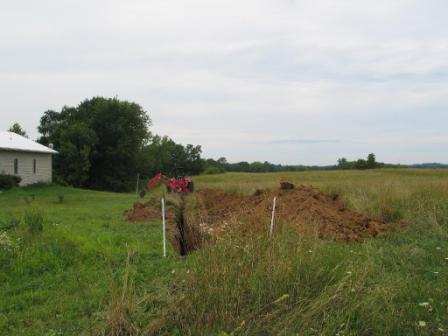

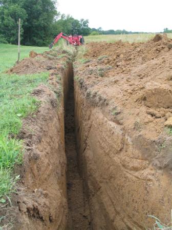

Okay, so back to the hydrants. I had to fix a cave in and correct some high points in the trench. Here is some of the remaining trench digging.

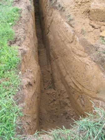

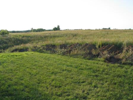

And here is the final stretch. I had to make all the corners so I would miss the septic and other obstacles.
