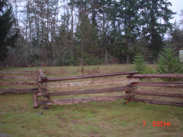

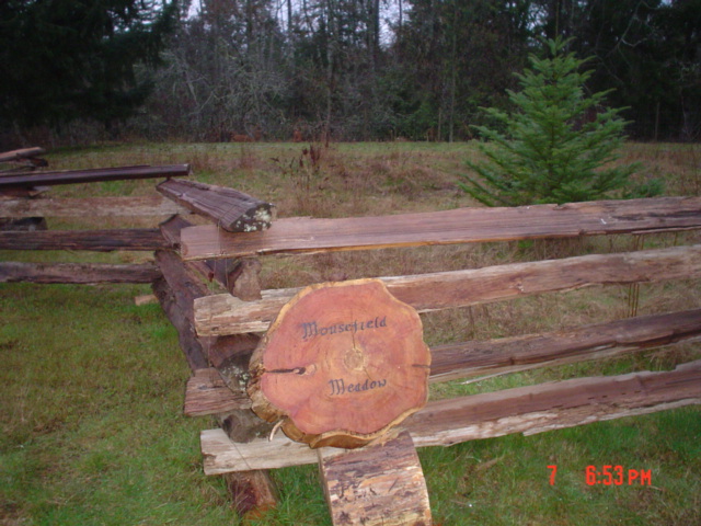

Not sure what type of split rail you are putting up. Ours is a zig zag style. We just put a starter piece on the ground and then built it up from there. They are wired together. Hope this helps. :)

That is a great look in Mousefield Meadows. What is the origin of the name?
MMH, do you have a design in mind that differs from the picture mousefield has posted. Looks like no post hole is needed for this type

That is a great look in Mousefield Meadows. What is the origin of the name?MMH, do you have a design in mind that differs from the picture mousefield has posted. Looks like no post hole is needed for this type
We have a meadow and we have mice so the wife called our little place Mousefield Meadow. :laughing:

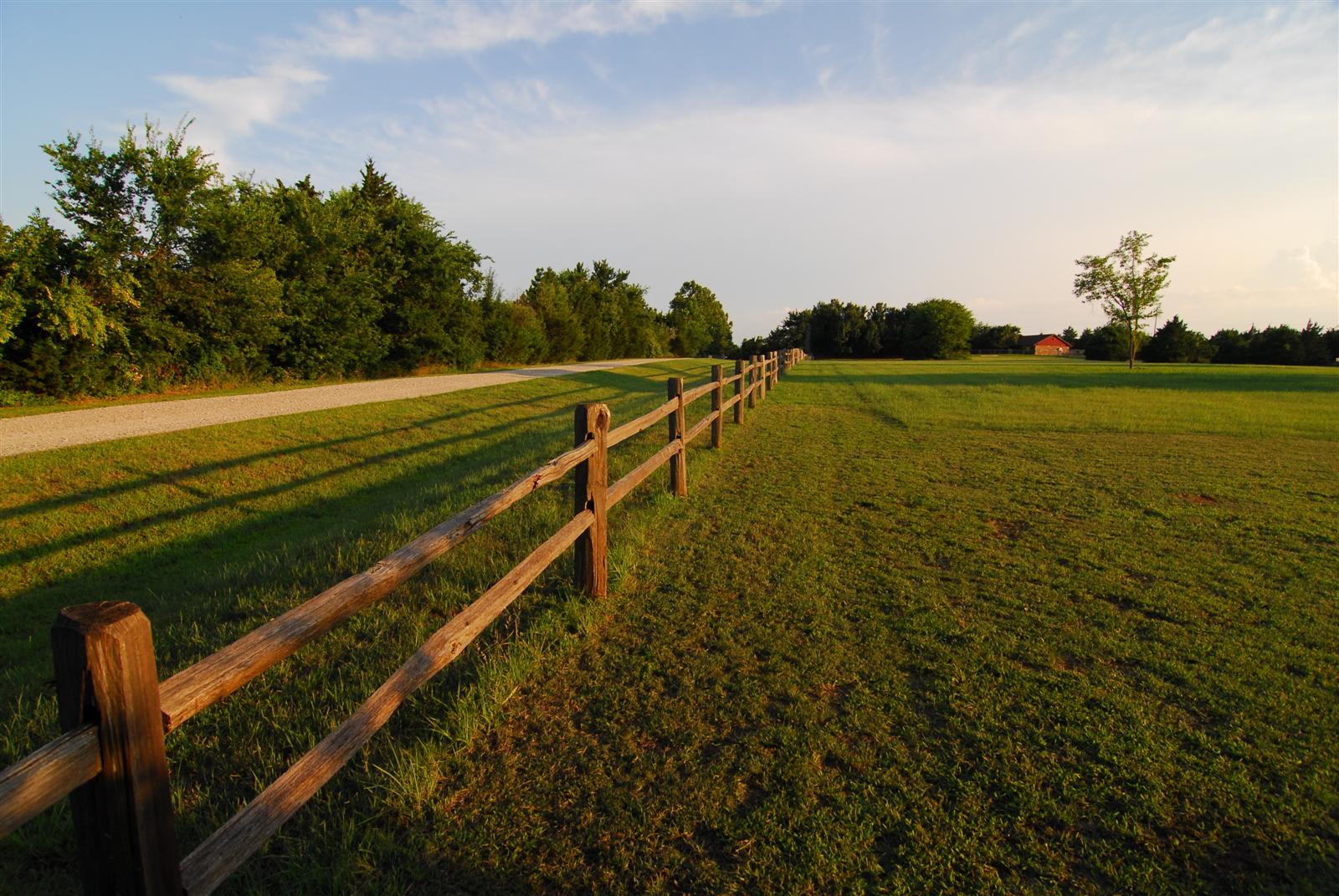

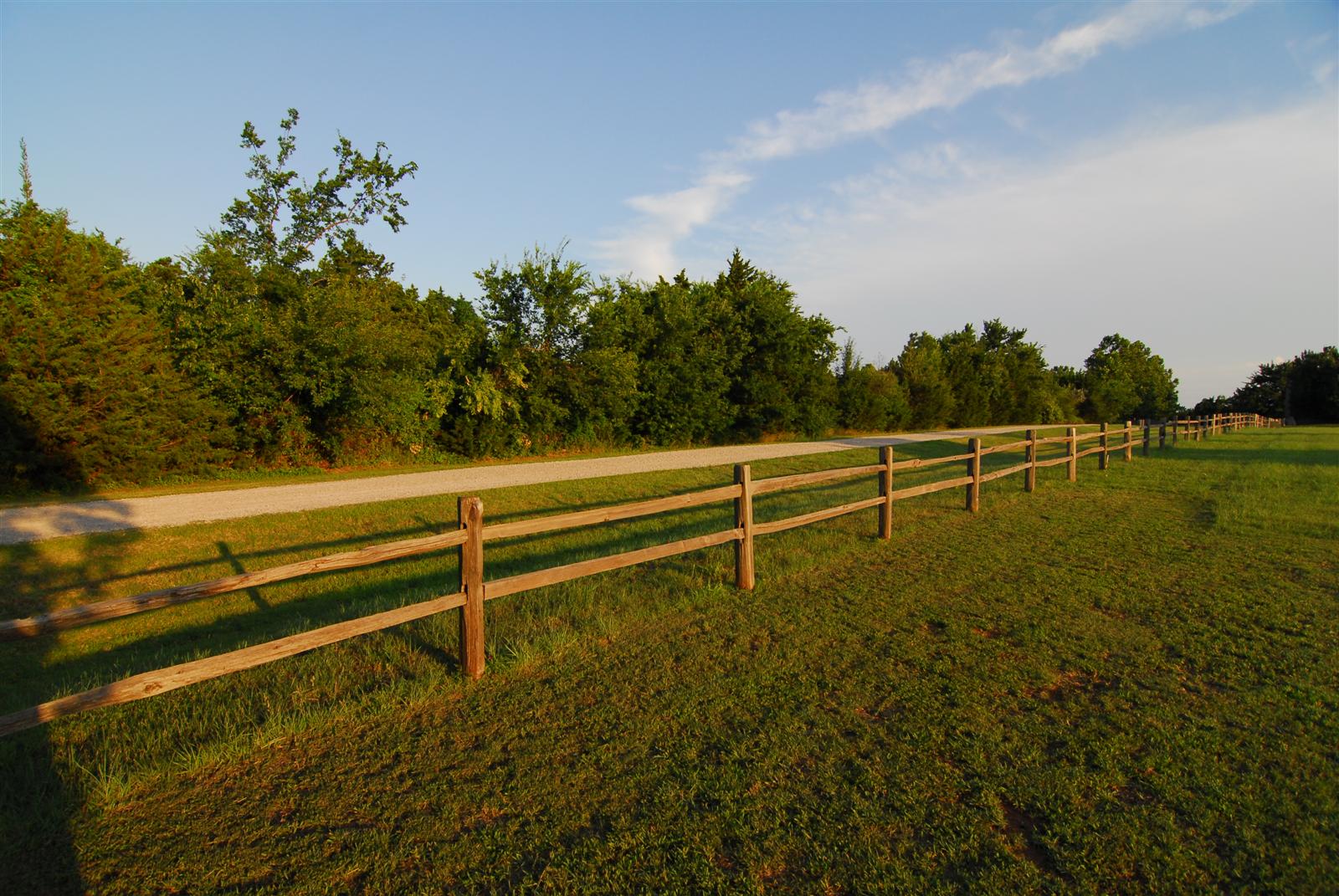

Here's about 450' of two-rail I put in a few years back. It replaced original similar fence but offset by 3' to one side of the old fence, used new posts but re-used all the 30 year old rails by cutting 6" off each end of the original 10' rails and spacing at 9' instead. 3' deep holes not really needed for this type fence, this is not livestock fencing, just red cedar "landscape" fence. 24-28" with a bit of gravel in the bottom for drainage and leveling post tops is plenty deep if posts are well tamped. All hand dug, post/rails fitted one hole at a time, no tractor needed. In fact, I think a tractor & PTO digger would just have been in the way and more trouble than it would be worth. This is nice pleasant summer upper-body exercise. Not that hard to do, I was 63 when I put this in. Forget concrete and deep holes, around here natural cedar posts will eventually rot out at ground level no matter how you set them, just plan on replacing the posts every 15 years or so. Or use that phony-looking white plastic fake stuff you see everywhere. :laughing:

Well I learnt something today :cool: as I did not know you could buy fencing like that, with the notching already done. Guess the only tricky part from looking at the pics from picker77 is you have to make darn sure of the post placement. :)
Good observation Mousefield. And it is the reason for putting the next post hole in one at a time if a tight connection of the rails is desired.
picker77's fence shows he put in a lot of care and planning along with the hard work. Very neat and tidy fence to add to the attractive landscape. Makes for a warm feeling for everyone driving down that lane/road. :)
