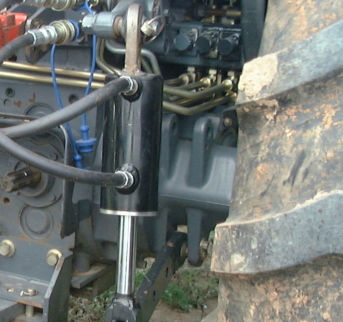

Although I believe you can carefully push in reverse with any tractor, there are some that are clearly designed to be better at it that others. When you look at the way the lower lift arms are attached to the differential, you can see what I mean. If you just have a pin coming out of the differential, then it cannot be as strong as a captive pin with support on both sides. My attached photo illustrates what I think is the best/stongest way of mounting the lower link arm pins.
With any tractor, you have to be cautious when pushing backwards. If you get going too fast, you have a lot of inertia, and the force could be enough to bend you lower arms. If you are going slow in reverse and hit an immovable object, lower traction and less inertia will most likely make you just spin your tires and come to a stop. The same is true when going forward, but your tractor is designed to have more strength for pulling than pushing in reverse. That is true for all tractors.

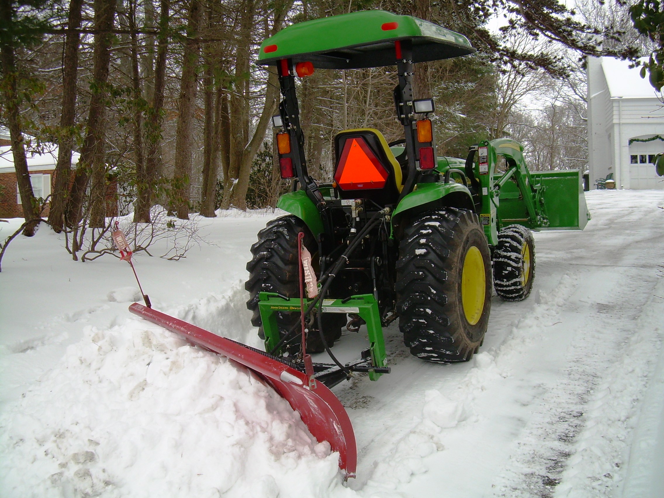

Both the rear blade and box blade are designed to use in reverse, so there's no rule against it. I did bend my lift arms by not being careful and going to fast plowing snow backwards with a modded snow plow. But that's life, things get bent, broken and worn out when you use them.
You have to use a bit of caution, not fear. There have been plenty of users stories of breaking 3 pt parts using them in forward position as well.

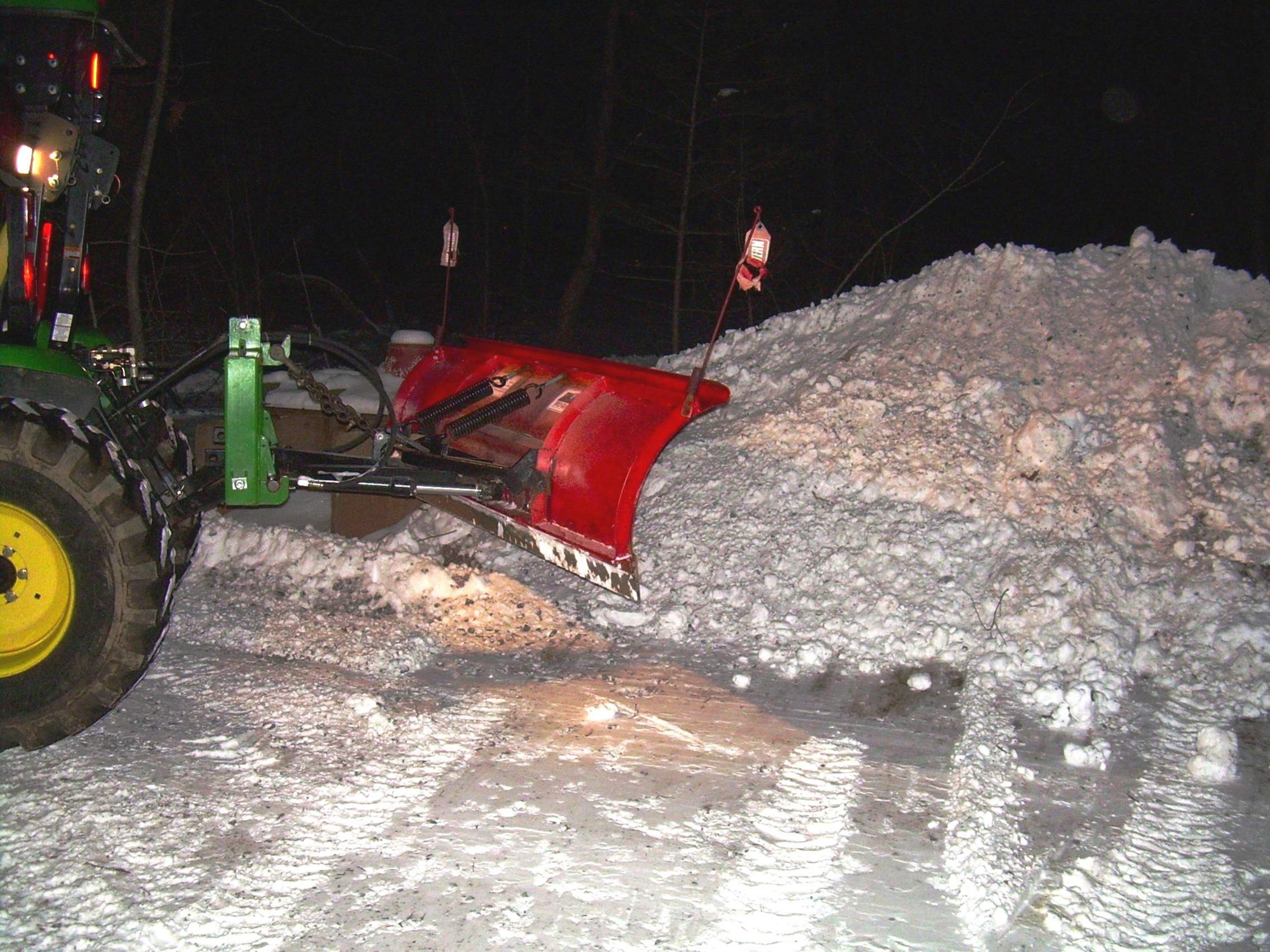

I have pushed snow w/the 3PH for years. Took a 7' blade, cut out 2' of extension, turned it around and can pivot both ways 2 holes w/o hitting the wheels and covering the tracks in all positions. Have done more damage to the implement and none to the 3PH in all the years I have used it. It is snowing here today, hence the pic reflects that! What does not show are the skid shoes on the tractor side of the blade. When I want to be aggressive in the bite I use the top link cylinder to adjust, allowing the edge of the blade to dig in a bit. Common sense when operating a tractor is always the SOP.

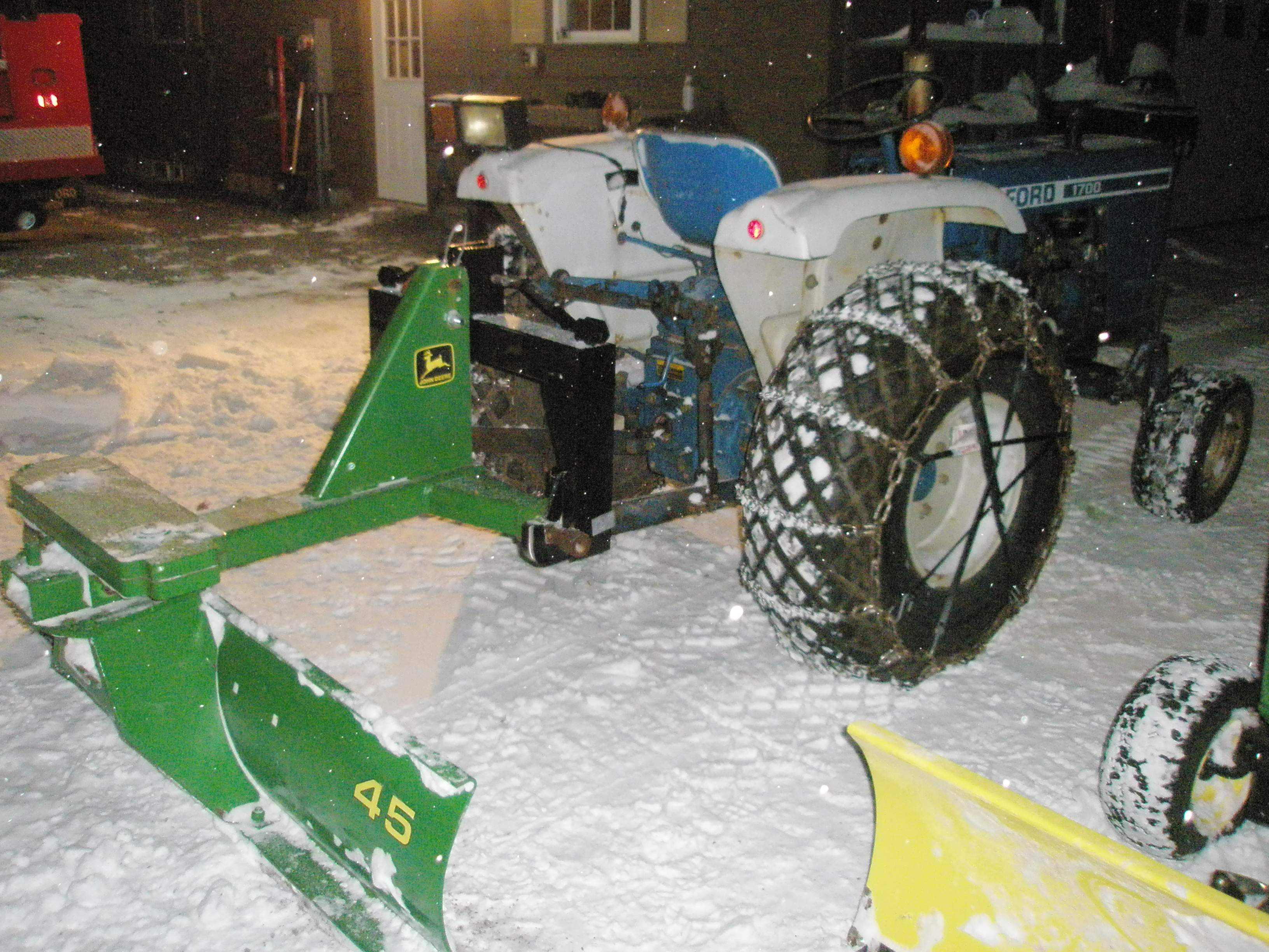

Just to add to what Jim said in his post. Conversely, you see on the pic below my lower arm set up is not as robust as Jim's. At least I'm glad the bracket behind is bolted on in two locations and can't see it easily sheer off the diffy housing. I have used my dirt scoop and push backed in to a pile of manure specially when I know there is nothing in the mound such as 6" post buried 4 feet deep:D
I try to pull if I'm doing a bit of the digging, once I made a mound they backing to it and lift trying to emulate poor man's REL (Rear End Loader):(

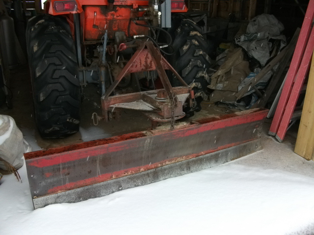

It was such an easy mod, I've since gone with that plow front frame mounted, alot more work but much more efficient and less pain in the NECK!!
I push (snow) backwards with an RB but I do it with the back side of the blade. That way if I get into something more than my equipment can handle, it has a tendency to ride up and over. Make sense?
Yeah I do that also with rear blade, both pushing and pulling, but mostly on soft ground with first snow so I don't gauge gravel and grass areas. It tends to ride up on top to much though that's why I added a bunch of weight to it. Only helped a little.
