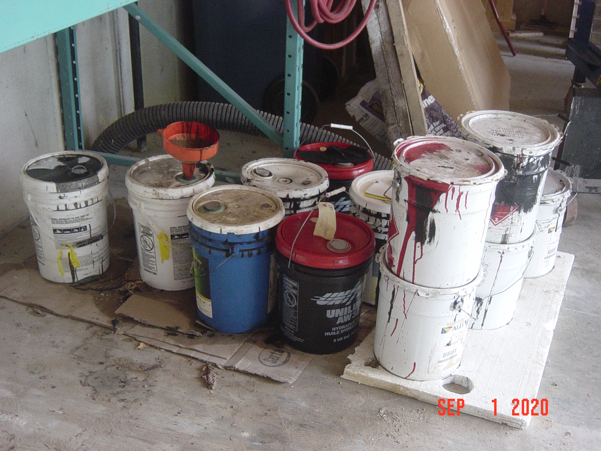

The final take, of sludge from the tank. Yup, amazing what you can get for FREE Sometimes! Took it away for disposal. Glad I had my friend along who got me the tank to partake in the joy. Funny, he got a little miffed when he soiled a white sock on one of the cans!
i found another really nice 2", two foot long rubber flex hose in there. ALMOST, stupid enough to salvage it and clean it.
Decided that what I thought was a tarp, was probably hundreds of blue kim wipes!
