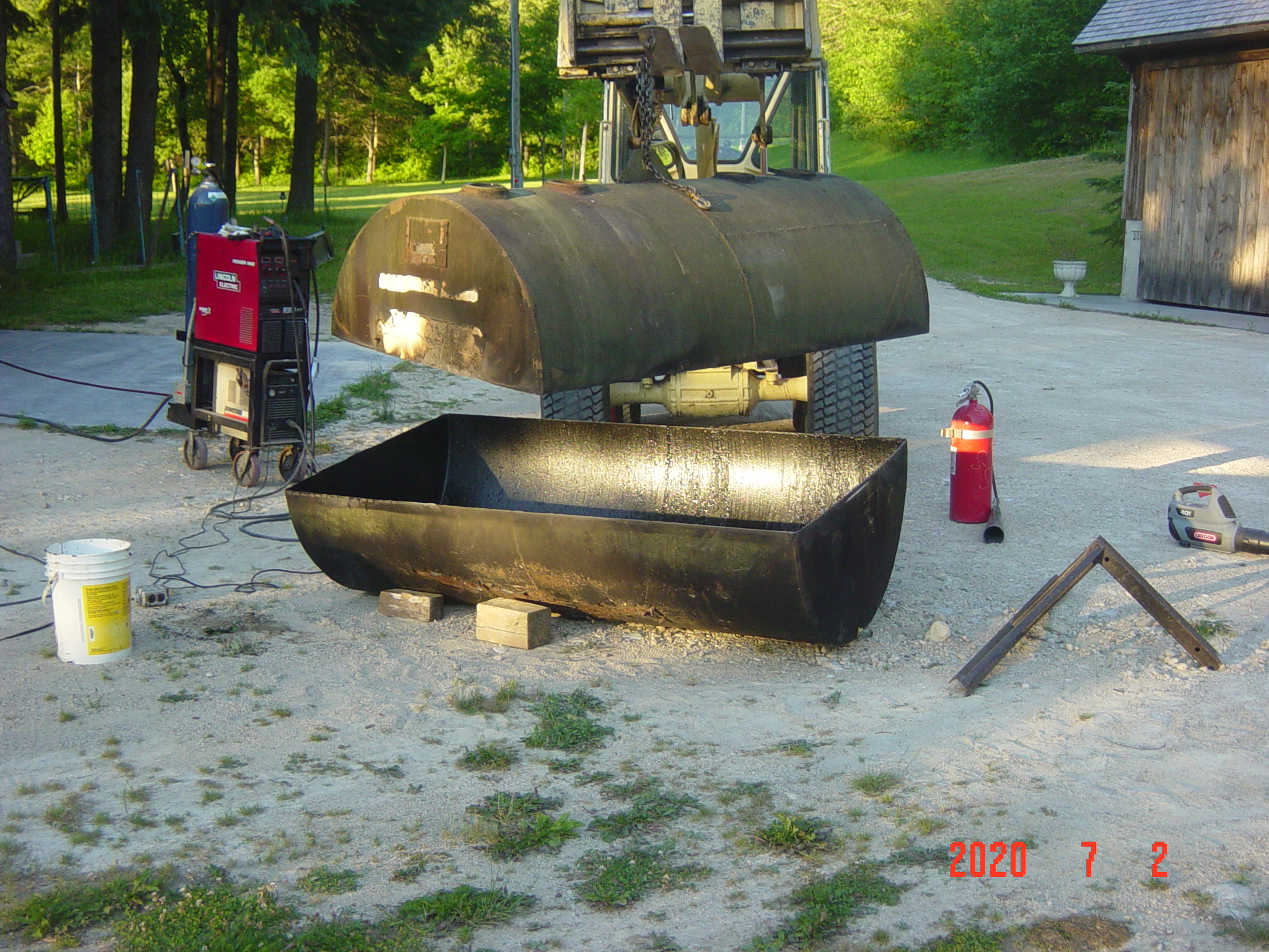

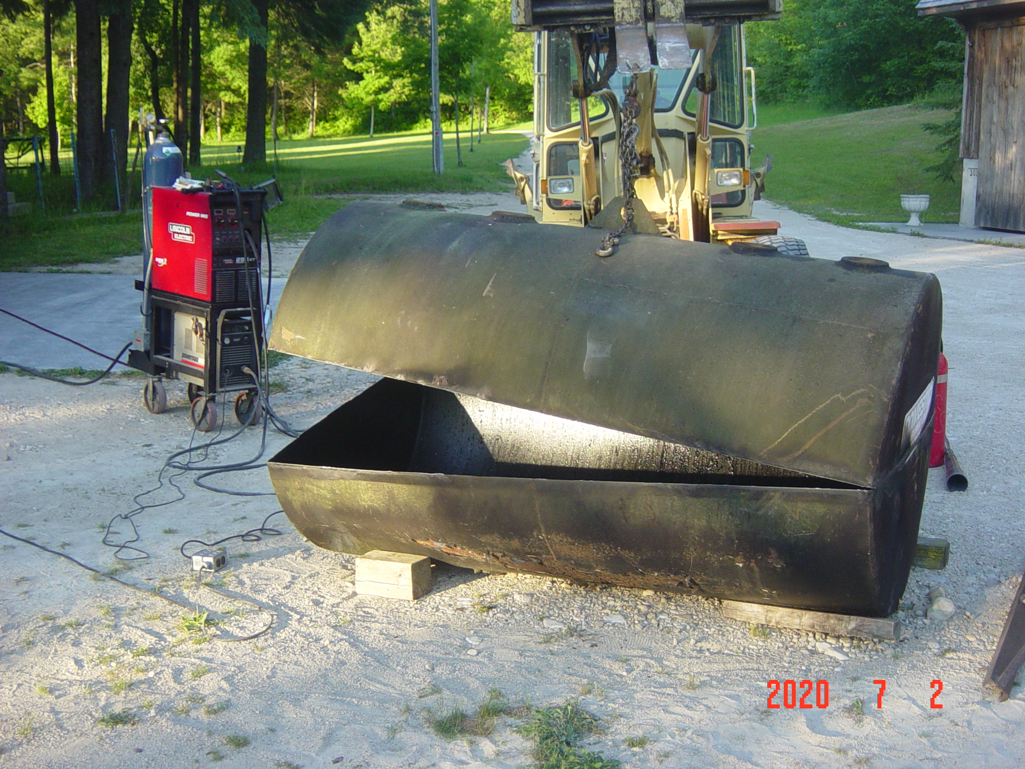

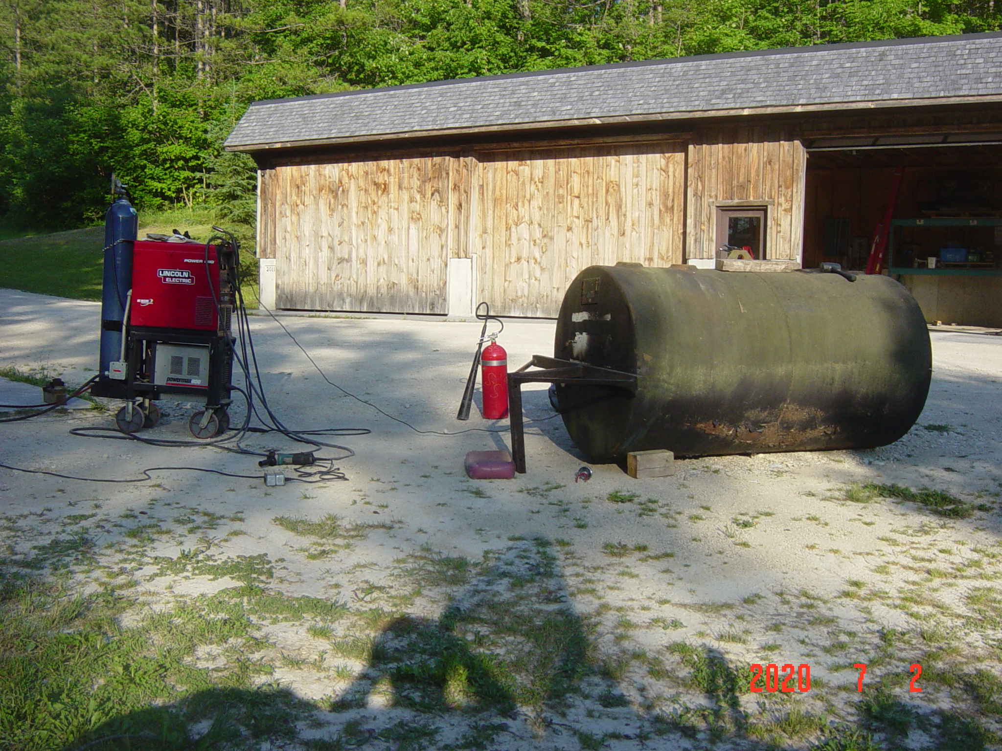

Spoke with a friend that has been repairing other peoples stuff in this rural/farm environment for fifty years. Says if it didn't have gas in it, just take the plasma torch to it. I stuck the leaf blower in there for a moment, discharged the CO 2 extinguisher a little and put the torch to it. I really didn't know if I was experiencing my last few seconds on earth! Well I got it cut in two and I'm still here. Thanks all for input.
Worst part was the paint (no doubt lead based) and labels I had to cut through. Leather gloves caught on fire and so wrapped glove in water soaked rag, which also quickly caught fire too from the intense heat.

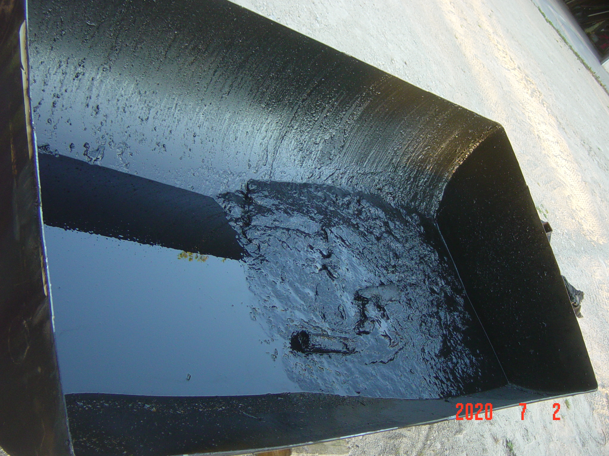

And then I got to the gooey good treat inside!
I can see getting quite dirty in my future.
So one half will be for cos manure storage with a lid and the other half I intend to make into a fire pit that I can bring near the porch and then remove when done. Another piece of junk on the property!
I gotta say, I'm shocked at the neat job I did cutting. Usully when I want nice, I make a mess of plasma cutting. All the surfaces were bowed making use of a straight edge difficult.

I was going to make a comment on the straight cuts.
   / Purging a Tank For Cutting/Welding #26
Really nice job on the cutting.

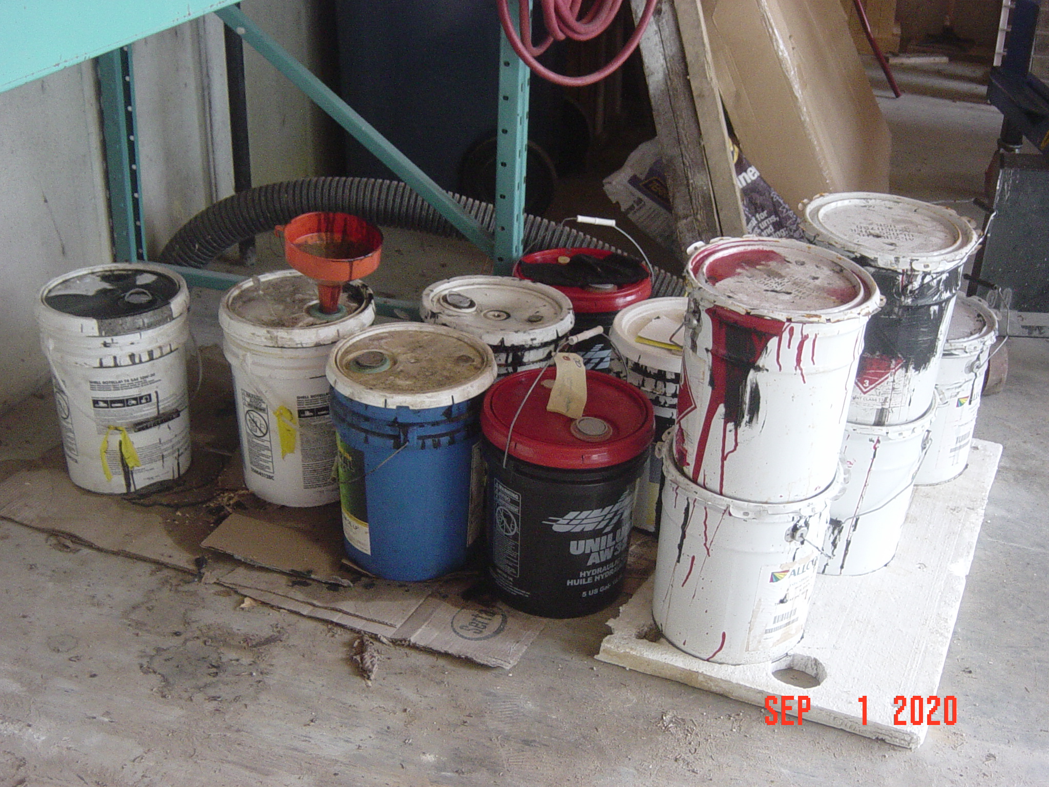

A friend will take the liquid oil to burn in his waste oil furnace and (surprisingly) the sludge to burn along with saw dust he gets to burn in his outdoor boiler. So that's a big load off my mind.

WELL! Easily something to go on my ten dumbest things I have ever done list. Accepting this tank some fifteen years ago. Thinking I could clean it and reuse for fuel oil or even dirty water.
There are treasures mired and buried in the tar/sludge/whatever. Six foot, four inch rubber hose, filters, filter rubber gaskets and some large quantity of some blue stuff, either a tarp or bunch of lay flat hose! But seems too rubbery for vinyl, so I really don't know..
I have used up six pails and need at least that many more! Trying to rip the mess apart with a hook and dig it out with a spade. All taking me away from other more important work! What a disaster!
