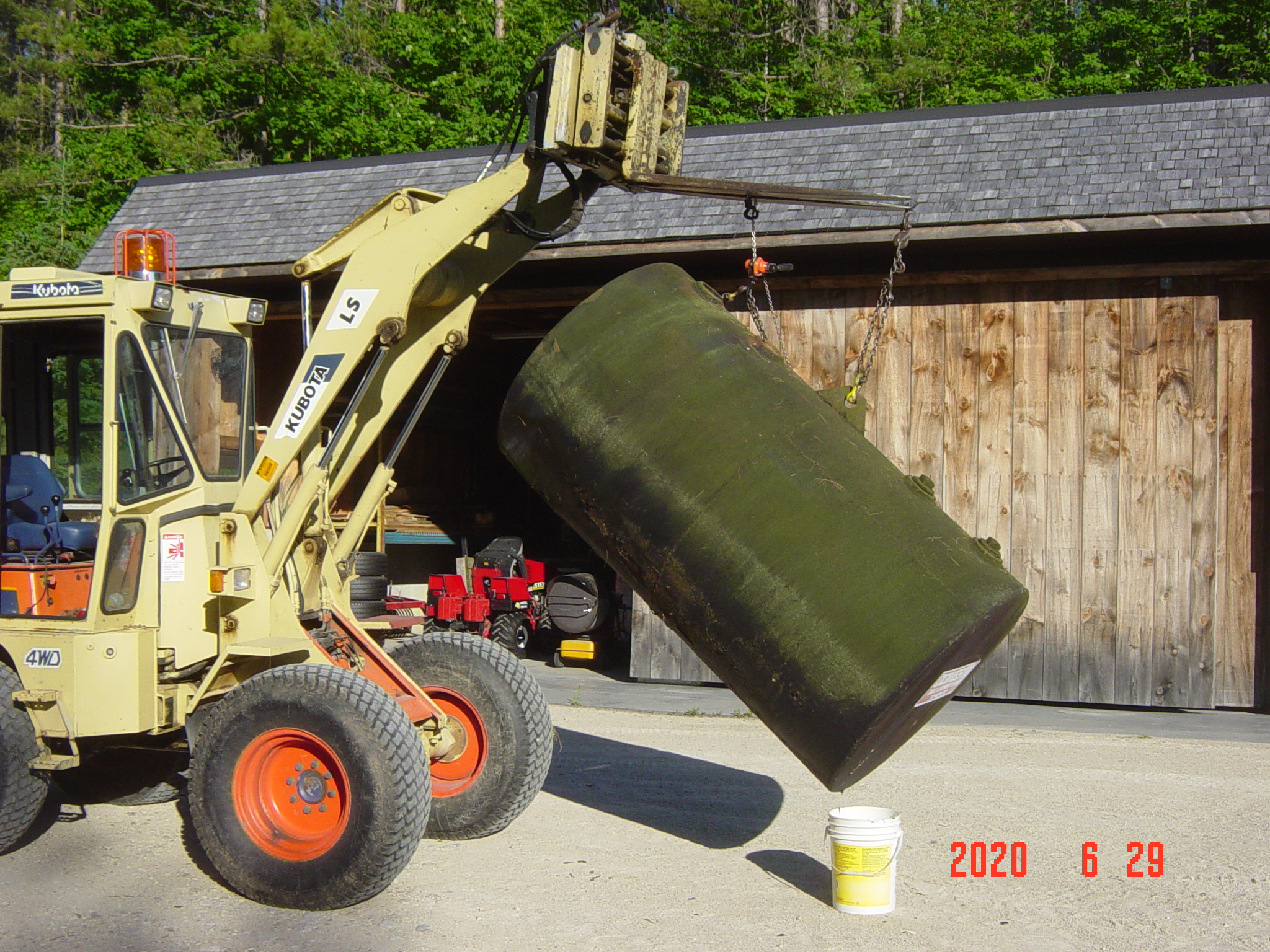

I have seen a thousand times the suggestion to put an exhaust hose in a tank for reducing risk of explosion.
Never ONCE did it say if Diesel or Gasoline Exhaust matters. Googled it, nothing!
I made the mistake of accepting this waste oil tank, years ago, Maybe 750 Gallons.
Now, I want to cut it in two with a plasma torch to use it to store some manure. No other use for it, nor will I probably ever have one.
I only have diesel exhaust. Tank has sludge in the bottom, I tried to remove, without much luck.
Tank has four, four inch bungs that are now open. Is that safety enough for it to stop from blowing up?
I'm thinking old engine oil often has gasoline mixed in with it. I have also had it fifteen years or so. Can vapours live that long? I mean, if it did, we shouldn't have all these STALE GAS issues.
Used a step drill to drill an almost 1" hole.

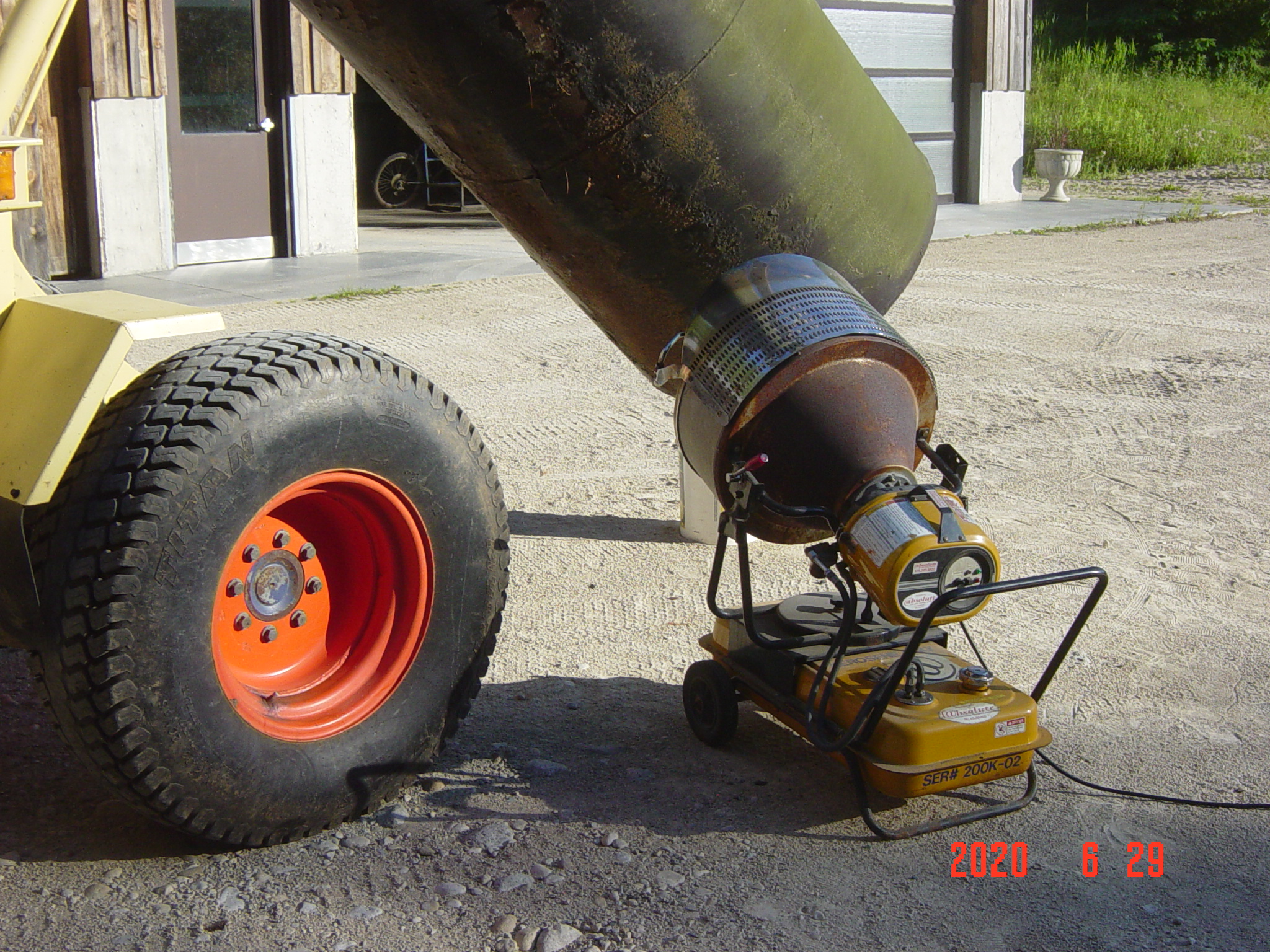

Tried heating sludge with a heater, with limited results.

A carbon dioxide fire extinguisher discharged into the tank would purge any oxygen. Personally, I use water and a battery powered demolition saw. The water leaks out over the saw blade and keeps it cool and no sparks.
/ Purging a Tank For Cutting/Welding #4
It takes fuel, heat, and oxygen to have combustion. The idea behind running exhaust into the tank is to purge oxygen with the already burned fuel - air mixture. If you could prevent oxygen entry into the tank any fumes could not explode or even burn. Since that's not practical exhaust is an option - diesel or gasoline. Filling the tank with water is an option - water displaces any fumes. The carbon dioxide fill is also a good option, just remember it's heavier than air so keep any openings on the top side. Good luck with your project.

Placed the tank into position away from buildings, in the hot sun. I don't like it! Smells too fresh inside. Nothing like old oil or stale gas. And it's been here fifteen or so years. I would swear there was/is tar in there. It's not impossible that I wasn't given the correct information about old oil storage. Maybe I made some assumptions too.

Spoke with a friend that has been repairing other peoples stuff in this rural/farm environment for fifty years. Says if it didn't have gas in it, just take the plasma torch to it. I stuck the leaf blower in there for a moment, discharged the CO 2 extinguisher a little and put the torch to it. I really didn't know if I was experiencing my last few seconds on earth! Well I got it cut in two and I'm still here. Thanks all for input.
Worst part was the paint (no doubt lead based) and labels I had to cut through. Leather gloves caught on fire and so wrapped glove in water soaked rag, which also quickly caught fire too from the intense heat.
