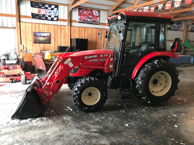

How do we know you really have this tractor, WITHOUT PICTURES !!
Gotta have the pictures.....:D
/ Purchasing a used 2014 4520C
#22
Branson 4520C 2.jpeglol. Here it is...

Nice Machine !
I have 4520 no cab, with 12 hrs on it. I think I paid a little more than you for it, but you got a SMOKIN deal.
