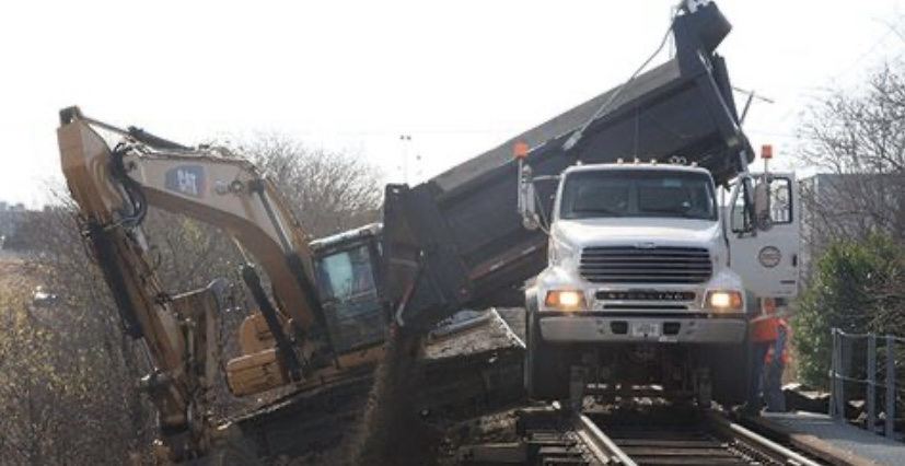

It often depends on where you are, what kind of trucks and trailers are popular. In the western states, belly dumps are very common. As you get closer to the West Coast, you see more side dumps. In the Midwest, you see lots of end dump trucks pulling trailers. But, you can see about anything being used if you look hard enough. Railroad contractors often times have end dump trucks with a turntable so they can dump to the side.
