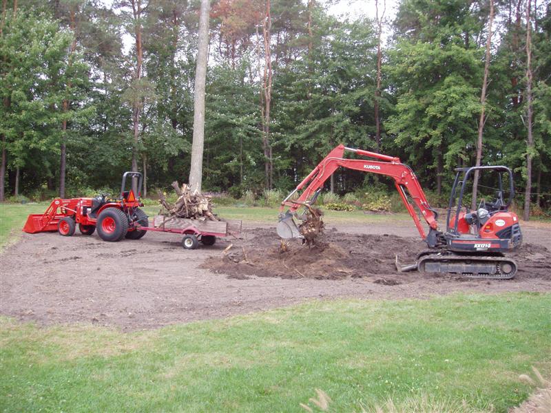

If you end up renting something the best thing I know of for removing stumps is an excavator with a thumb. For your application a mini-excavator should be all you need. I have rented them 3 times in the last 15 years and they are amazing. They have a small dozer blade on the front and with that you can push out most anything 3" or smaller. If you can't push it out, just back up and dig it out. With a tracked vehicle you would never have a flat tire from the thorns. Around here a mini-X can be rented for about $300/day. Get it for the weekend and it will be the same price. Then you can use it for 2 days. There may be an extra charge though if you put more than 8 hours on the meter. Here is a pic of how I removed some large pine stumps a couple of years ago.
