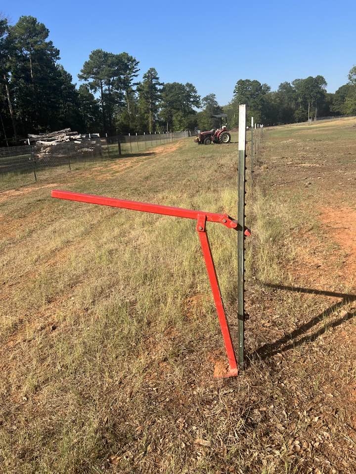

I got home early today and I pulled out the T Post Puller. The last time I used it was in June or July, when I made some changes to the dogs runs. It was horrible, I could barely get them out, and I was climbing onto the handle and bouncing just to get them to budge.
We got an inch of rain last week and the ground feels "softer" I popped about a dozen T posts out of the ground really fast. Probably took 25 minutes to get them out. Then I hit one that just refused to come out, I went to the next, and it isn't budging either. I tried the third with the same results, so I just left the puller sitting there and called it a day.
We're expecting more rain this week, and I think that's what's going to make the difference. I'll wait until it rains and try again. I'm in no rush.
You can see the new fence to the left. The old fence was used for the electric wire when I first got the horses. It kind of worked OK, but not great. It zapped them just fine, but the plastic things to hold the wire where always breaking. It was a constant search for broken plastic thingy's, and replacing them. The new fence is 2x4 horse fence.

Congratulations on the rain and the T-post success!
This is my issue with that gizmo. Here, mostly by the time the ground is soft enough to use it, the soil is usually unsafe (too slippery).
As an aside, when we first put up electric fence, we used some Zareba brand yellow insulators that were um...less than optimal. We switched to Gallagher and Premier1 insulators, and the Gallagher top caps have been 90% good for 15 years of Californian sun and snow (mostly one of the two top ears snap off, often from a branch hitting them). The T-post standoffs are going ok. They seem mostly to die by impact with a branch. The flat plate versions that go between the bumps/knuckles on the T-posts are close to 99% survival here.
