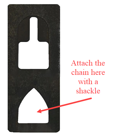

I bought one of these at TSC, $13.99. I wrap a chain around the bucket and leave about 4' of chain between the puller and the bucket. That's enough to get it over the top of the t-post and let it drop down close to the bottom. I still have to get out of the seat but I drag the t-post I just pulled to the next t-post, remove the one I just pulled, throw it in the bucket, and put the puller on the next one. If I can't lift it out of the ground with the FEL, curling the bucket up has worked.
If your bucket has enough dump angle(ie the top of the bucket is ahead of the cutting edge), Bolt this thing on a hinge on top of the bucket where you can see it... The real trick is now how to collect the t posts without getting off the tractor!
