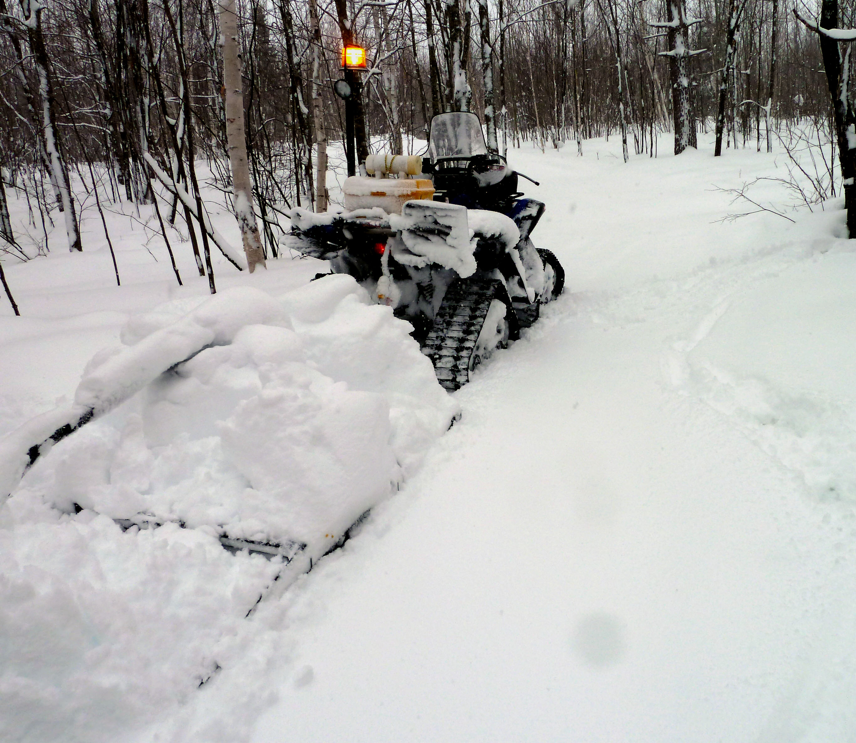

You folks don't really drag all that much......

Nice little groomer, our trails are 14ft wide so we use monster groomers..

HCJtractor, Its likely your 550 will do fine. Whenever you pull something that demands more power, your transmission will wear faster. But hopefully it will not break or last significant less long for you. I posted that photo just to show that some folks do tow implements requiring a large percent of the engines total HP. Hope that helps.
