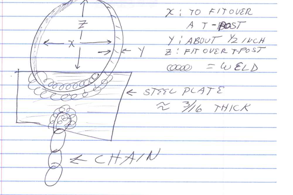

Jim, I took a short scrap of pipe and some scrap metal, sized to fit over a T-post and welded a chain on it. Y put the chain on the FEL and it dangles down with the pipe ring at an angle between vertical and horizontal. You can drive up to a post and lower the ring over the post. When you pull up the piece of pipe tries to capsize and grips the little bumps running the length of the post. It grips pretty good and doesn't slip often but its grip depends on tension, i.e. the weight of the post holding down on the puller and its chain. If you lower the FEL and let the weight be partly carried by the ground the puller-gripper-thingy looses its great grip and can be jiggled a bit if needed and it will release the post. IT helps if you don't initially lower the gripper way down on the post, just grab it near the top.
Pat
   / Pullin Old Fence Posts #34
Patrick_g, I'm going to need a photo of your puller-gripper-thingy....can't seem to get a picture in my head...

   / Pullin Old Fence Posts #39
John, I posted a drawing a while back.
It really isn't complicated. It is basically a short length of scrap pipe with a chain welded to it.
Hanging from the chain, the axis of the pipe is diagonal WRT the world. The pipe is like a wide wedding band. It will slip over a T-post by gravity but when you pull up on the chain it cocks the pipe which catches on the bumps on the T-post and lets you pull the post.
If you lower the FEL till the post starts to touch the ground a little and jiggle the FEL a bit and raise it a bit the T-Post falls out of the grabber and you are ready for the next one.
My pipe was a little larger diameter than I wanted so I welded some scrap steel inside the ID to close the hole down a little so it grabbed batter when I pulled up on it.
I haven't used it (or seen it) for a while and don't really know exactly where it is. It would only take a few minutes to make another one. I'm no artist but I'll try to make a sketch, scan it in and post it.
Here goes...
OK, I fond some previous scans so posting an old one and a new one. Both designs work. The one with the scrap plate grabs better (fewer missed attempts) but doesn't release quite as easily.
Note: These drawings are not all that good to scale. Make a prototype and watch how it works and then make a better one. NOt much to these but they do work.
The commercial post popper I have, the one that works manually like a jack has a little attachment that grabs the post. You could duplicate that attachment and have a post puller that would work on flat posts AND T-posts.
Pat

   / Pullin Old Fence Posts #40
OK... I got it now..... thanks for the sketch....very functional, and all that I needed to understand .... I'm remembering that once I tried to use a pipe but it didn't catch the T post ridges.... maybe it was too long or something.... good idea! Thanks!
