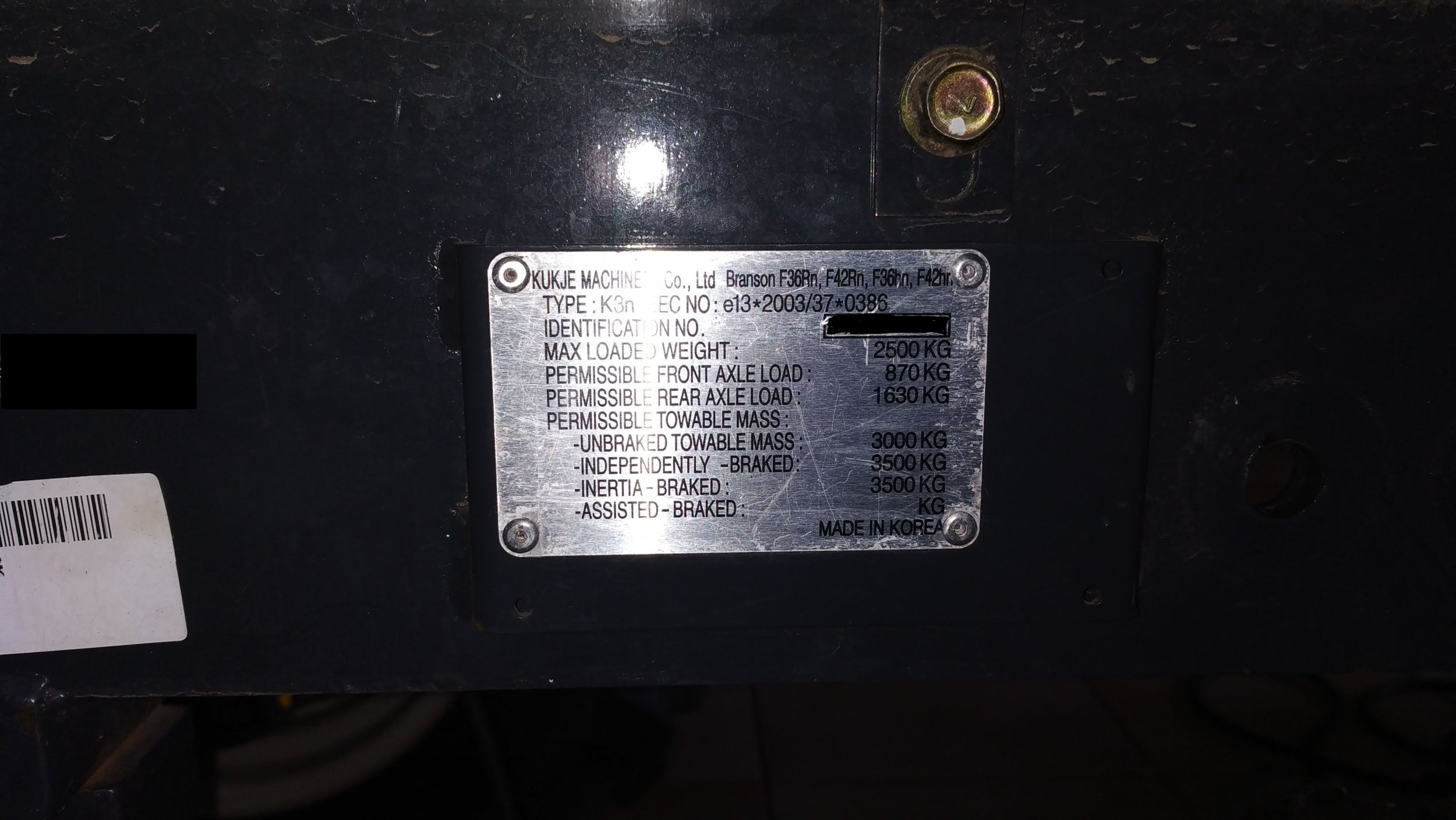

I'll just show the tag on my tractor. It would be nice if manufacturers could expand on more details about these axle ratings to clear things up. Is the rating meant for static use? While moving? If moving, at what speed? Does it include the front weights already? Without the front weights?, Etc. Lots of variables.
The reality is, most tractors will be near max capacity with just the loader on it. Here is my case, I have 870 kg (1900 lbs) weight rating on the front axle as seen on the picture. I know for a fact it does not include a loader since the tractors are sold without a loader and there is no OEM loader option.
If I put my loader on, that's about 1000-ish lbs (loader mounts + arms + bucket) that will take from the front axle capacity. So this means I now can only lift 900-ish lbs with a loader that I built and design to match the aftermarket loaders we have here, which have a max capacity of around 1650 lbs at max height at the pins. Or even the Branson loader in the US with 2200 lbs capacity. Plus, I still have my hydraulic winch (160 lbs) and my front weights ( 240 lbs).
I'll also add that Branson tractors have really heavy duty axles for the size of tractor compared to about everyone else. It's like they put the axles from the next frame size tractor on the smaller frame one. Specially when compared to other brands side by side, you'll really notice the size differences.
If all the rest of the design was equal, a larger axle would be stronger. But that doesn't mean that it is.
It would be just as easy to make a smaller and stronger axle out of stronger material - or with a different internal geometry.
It would probably cost more, and so would the tractor.
