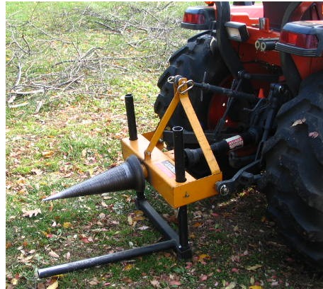

Got the old Stickler out of mothballs,still works great! For those members not familiar with the Stickler,It is a screw type pto wood splitter. I run it 237rpm PTO speed (1100 indicated) seems to be a good speed for splitting.I've split wood up to 12' in diameter. The length I keep around 3-4' .Wood species also determines how well it will split. You simply roll or carry up the wood to the splitter screw,hold the end near the screw up off the ground,and let the screw auger in about 12''-15" from the end then stand back let-err screw. I keep a small axe on hand to cut stringers.

I had one that bolted onto the rear axle of a pickup that I used for a while. When that truck was replaced it didn't fit the new one, so for many years it sat in the cellar. Now it has been put back into service by some one else.
They worked great for longer length wood but on the truck short pieces could end up being a propeller. They sure were quick. I had not seen one set up for a 3PH, that one looks good.

If you look at the picture of the splitter,you will see a pipe parallel to the screw,this is the stiff-arm designed to prevent spinning of the piece of wood to be split. I split mainly longer pieces of wood,that when splitting are long enough that they hit only the ground.(to the right of the screw),the screw turns clockwise. If you were to split only short pieces ,you would need to be very cautious, the longer the piece the safer it is.

That's one of those death tools. What if you catch your sleeve in that thing? Or your beard?

Your research is correct,my unit was made by Arnold Industries,Toledo Oh. I purchased my unit new back in late 70's. I've split many cords of wood with this unit over the years,I kinda like it. I don't burn wood anymore,but use it to split wood that will not fit into my 4" chipper.
