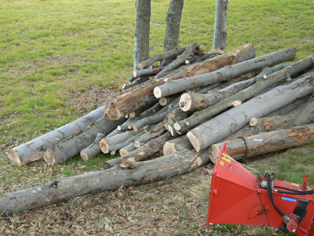

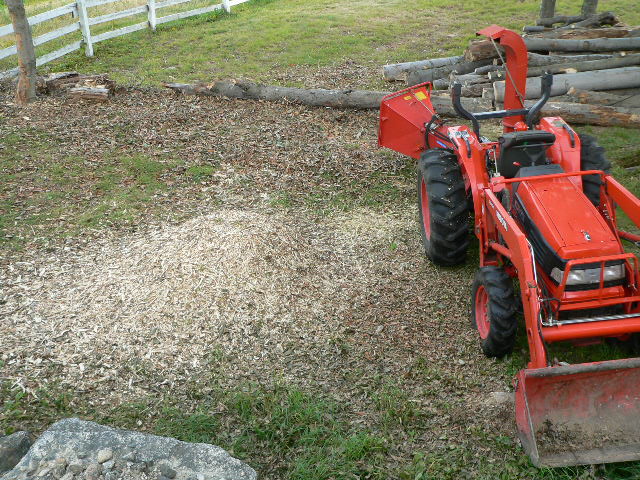

Yeah likely the only 4 inch stuff you will put through the chipper is punky junk wood anyway. I am unfamilar with the specific chipper you reference. I use a Valby two stage behind my 3710. The feed speed is important for the type of material you are feeding. I cannot imaging using a low powered single stage chipper for anything beyond 1 inch brush......
I do not think I would be comfortable with a single stage chipper. it would neither be strong enough to do real work, nor safe enough for anything but chopping near weeds. You get a big enough flywheel chipper moving at speed and the flywheel itself does the real work...... moderate the feed rate to keep the rotor moving at functioning rpms.........

sorry. The Valby has a hydraulic motor, feed drum, that is speed adjustable. This takes the material to be chipped from the feed shute and feeds it to the blades and anvil box of the chipper. I was responding to someone's comment about managing the feed speed by holding on to the material to be chipped with his hands. With a two stage chipper, once the material is in the feed shute, you do NOT handle it. The feed drum is also reversable for when you get a jam.
Pickies added.

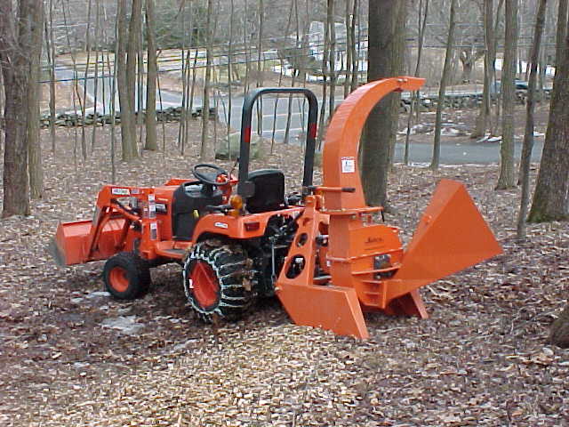

I have had a Wallenstein BX42s, since end of January 2012. Purchased it from Iowa Farm Equipment via eBay for $2599 plus $335 freight to Florida. Ordered it on eBay before Noon, it was on a truck heading for Florida at 2:00 PM same day.
Wallenstein has an excellent reputation. I have been pleased with mine.
PTO direct drive, NO hydraulic feed // NO hydraulic fluid. I am a firm believer in the KISS principal.....Keep It Simple, Stupid. The BX42s is a KISS implement.
I run mine behind a Kubota B3300SU; 33 engine hp / 25 PTO hp. It chips all the green wood I feed it in Florida. Personally, I amputate roots with V28 battery powered Sawzall before feeding in trunks. Dirt will dull the blades so I avoid it by cutting off the roots. I also do not try to make the chipper into a shredder. When the trunk chips down to the twigs I toss those twig bits onto the pile of roots and the combination goes to the burn pile. Straight trunks, without roots feed easily so your arms take less pounding from vibration. My arms are 64 years old.
Kubota B3300SU manual recommends 500 pounds weight on the three point hitch when using the bucket. This is not essential in Florida with our rock-free sandy loam...even a full bucket is easy to transport with nothing on the back. However, when carrying heavy sections of Water Oak trunks (12"-30" in diameter) chained to the bucket a counter-weight on the back is essential. The BX42s weights 425 pounds....just about right.
I recommend getting a dolly to rest your chipper on between uses. It is a real bugger mounting any implement on the three point when the implements rests directly on a floor. The castered Vistil dolly I bought, also on eBay, 1,200 pound capacity, eliminates 90% of my bad language.
One last thought: The BX32 has a V-belt between the PTO shaft and the chipper drum, used to speed up the rotor on the BX32, Wallenstein's smallest chipper. The BX42, BX62 and BX92 are all DIRECT PTO drive; NO V-belts. I hate V-belts.
