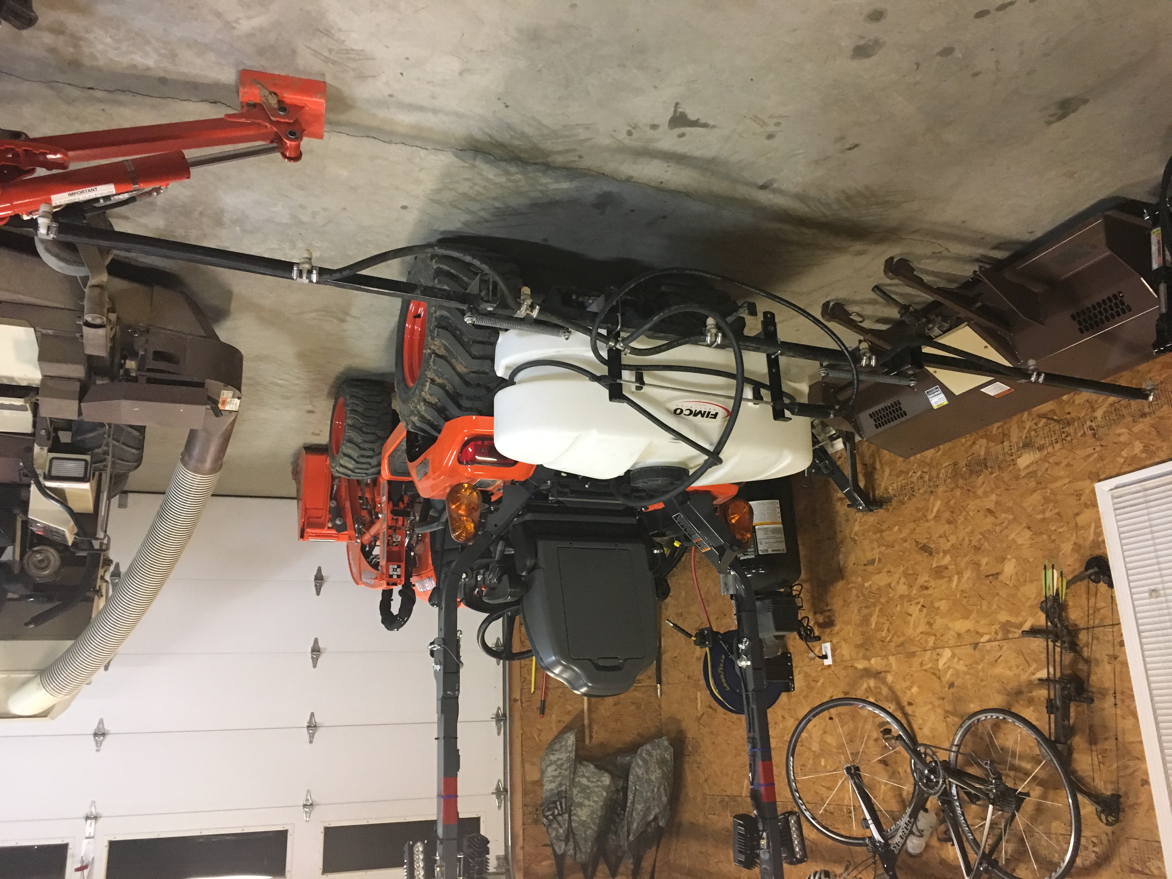

I mounted a 15 gal atv FIMCO sprayer on the back of my tractor for lawn weed control w/ weed b gone. I have a little platform like a small carry all on the 3 pt hitch and bungy the sprayer down. It gives me about a 60" wide spray with its 2 sprayers and then it has a wand for special projects. It works fine but I think I am on my 3rd pump in 8 years. I can cover about 1/2 ac with 15 gallons w/ good saturation. When your pump dies, buy a higher quality pump.

I have a little wireless remote and my spray tips have check valves so when I turn it off they don't leak. Still on same motor since 2009. I have used this sprayer on all sorts of different machines but I think with my lil BX this will work best.

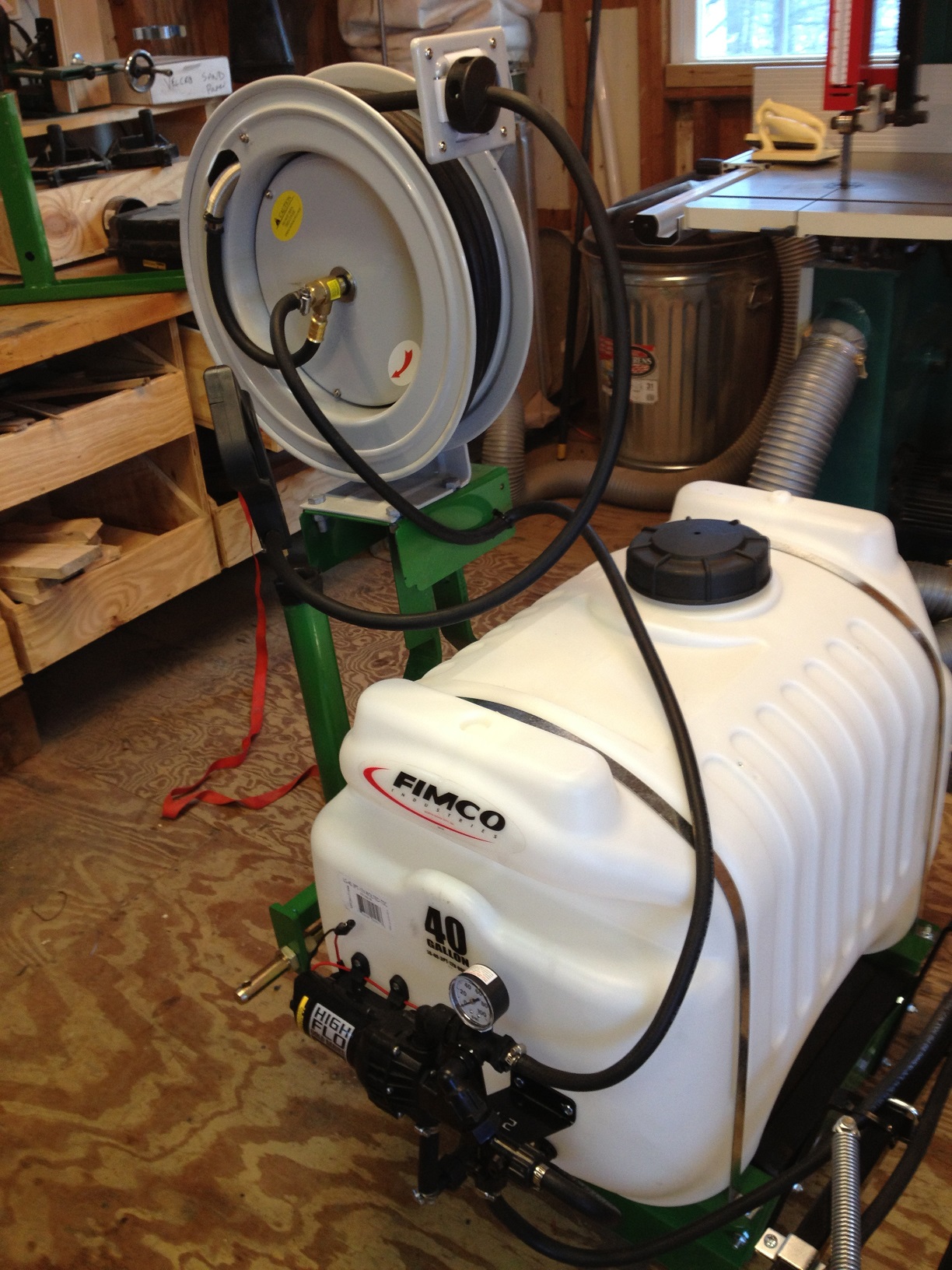

I have a 40 gallon fimco on my 739. It works well for my 2.5 acres. I welded a spring loaded return spool on the top and upgraded the sprayer wand. I love it. Though, I did replace the pump with a better one. Use the wand more than the boom, mainly because I'm spraying weed n feed and have a lot of flower beds that can't be hit. Photo below.
That said, with your acreage and needs, I would think a PTO driven sprayer would give you better performance with less issues. However, as you probably know, the cost is several times that of the fimco.

I agree for a larger field go with a pto pump. But they can be problematic, my farmer brother considers them to be a an annual consumable, Round up is hard on the seals. The Fimco is fine for small properties. I have the 3 pt. 40 gal. But it was upgraded to 1/2 inch hose, bowl strainer, 6 spray T jet AIXR11002 nozzles, instant shutoff check valves and a 3.8gpm Fimco pump. Only thing original is the tank, frame and boom. This setup is perfect for liquid fertilizer for lawn and landscape plants and Square One spring herbicide for lawn weed control.

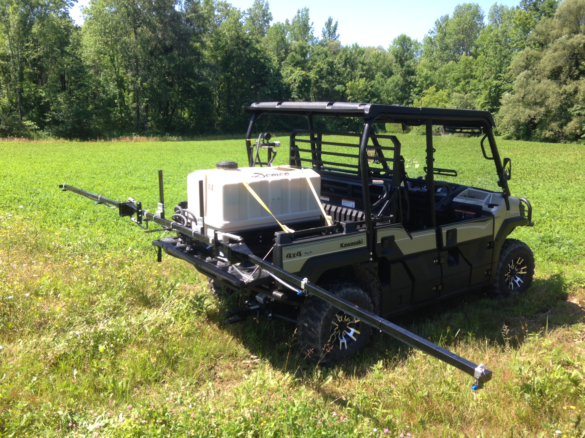

I have a Demco sprayer that I use around my 1/4 mile driveway/house and soybeans and corn. It has worked great for the last three seasons.
I really like that sprayer....I have never seen that one or the other side by side sprayer someone posted earlier....I paid a lot of money for mine and thought I had looked at all the higher quality side by side sprayer, but obviously not. What type of pump motor do you have on this sprayer? Gas? Electric? How big is the boom? How many gallons is the tank?
