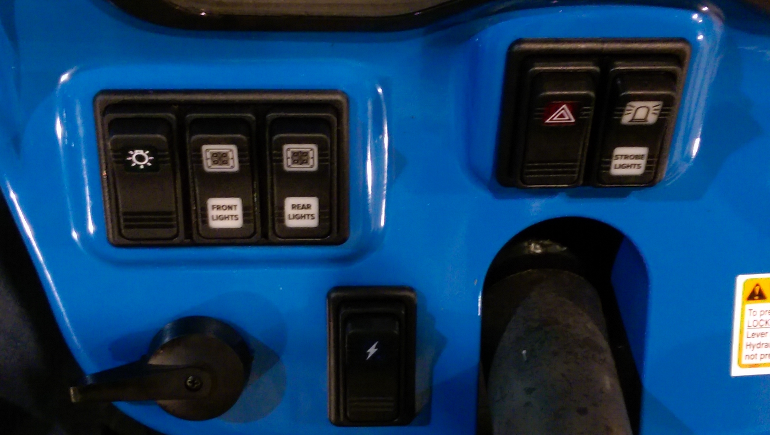

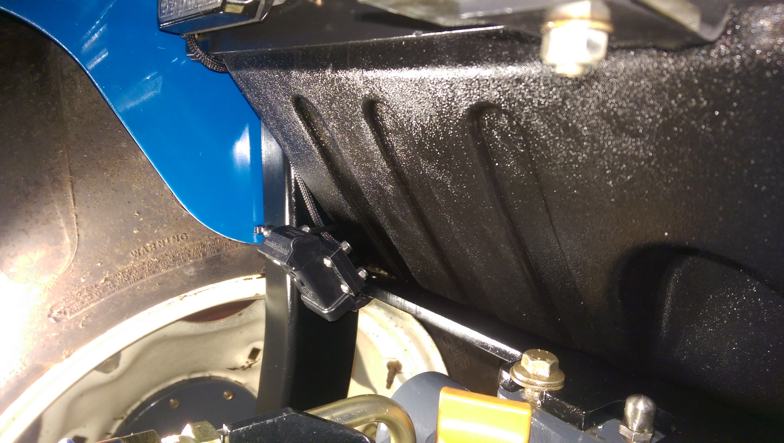

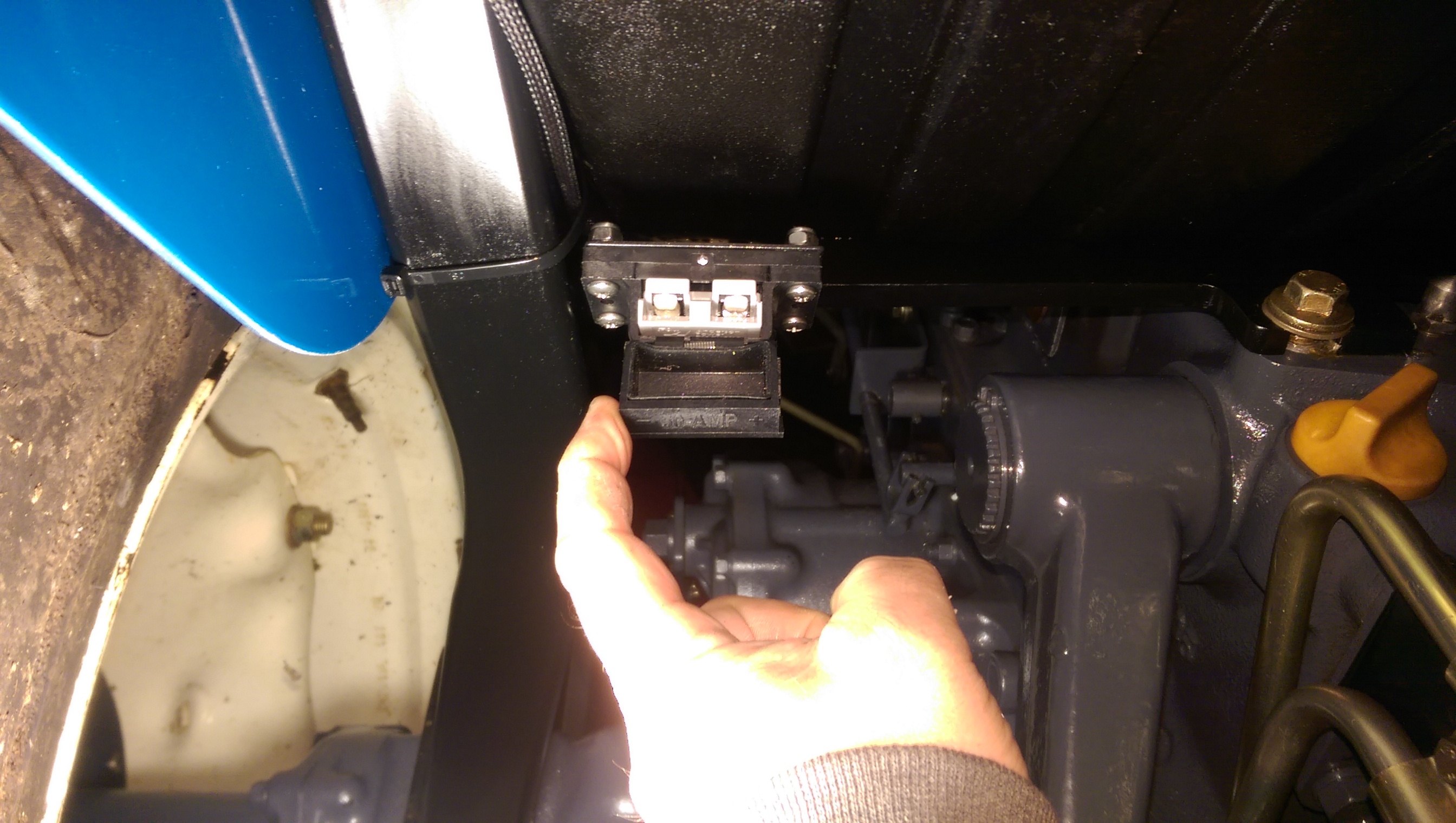

I would wire some Anderson Power Pole connectors on a relay to the back of the tractor. That way it's switched and not hot all the time. Change sprayer ends or make adapter
This is basically what I did for the front & rear of our NH... Wired up some Anderson Powerpole SB50 connectors using the Trailer Vision mounts / housings. The power is controlled by a dash mounted switch that controls a relay that sends fused power to the Powerpole connectors. I made a couple of different harnesses, Powerpole to implement connector, which allows me to run different equipment on either the front or rear of the tractor.
The switch is nice to have as it allows remote activation when using things like the boom sprayer.

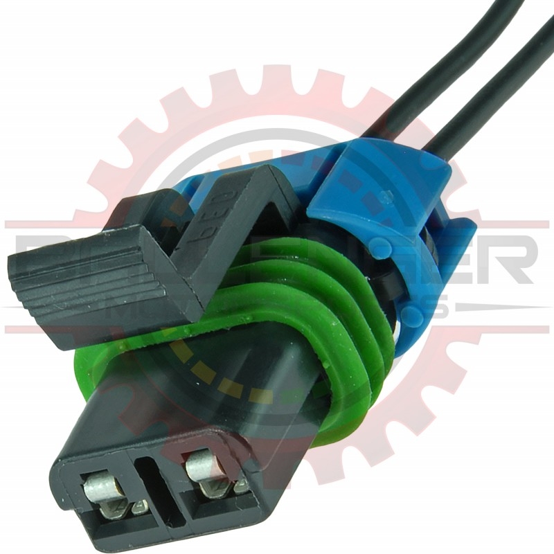

My tractor battery is in front of the radiator, behind the grill. instead of messing with that, i put a Packard connector on the battery terminal of starter solenoid w/ring terminal and ran ground to frame, then put a Packard connector on the sprayer motor wiring too w/inline 10a blade fuse.

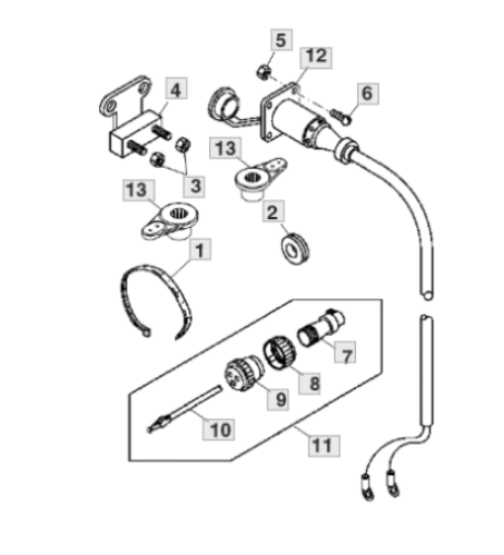

Here's a wiring harness that JD offers to operate their round baler monitors. When I attached my rd baler monitor to my Kubota M7040 I used that type harness attached directly to tractor battery. Part # is AFH210360
