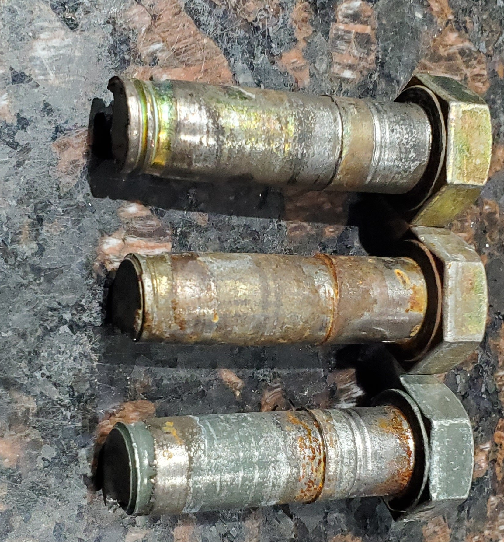

As mentioned earlier, it looks like the bolts have been "rattling" in their holes, until they give up due to the shear forces. Work hardened if you will.
I don't think it's one "shear force incident", but repeated abuse from not being tight.
Agree^^ on the "rattling" marks on the bolts. It looks like those bolts are being hammered from all directions...a lot. My cutters will only show the bolt with the one mark just showing it is trying to slightly shear. The OP's bolts have heavy wear all over them. I'm still wondering if the PTO shaft u-joints are out of phase. If that is the case, the pto shaft will be trying to speed up and slow down the gearbox TWICE per RPM. That would stress the bolt and the clutch wouldn't help it one bit.

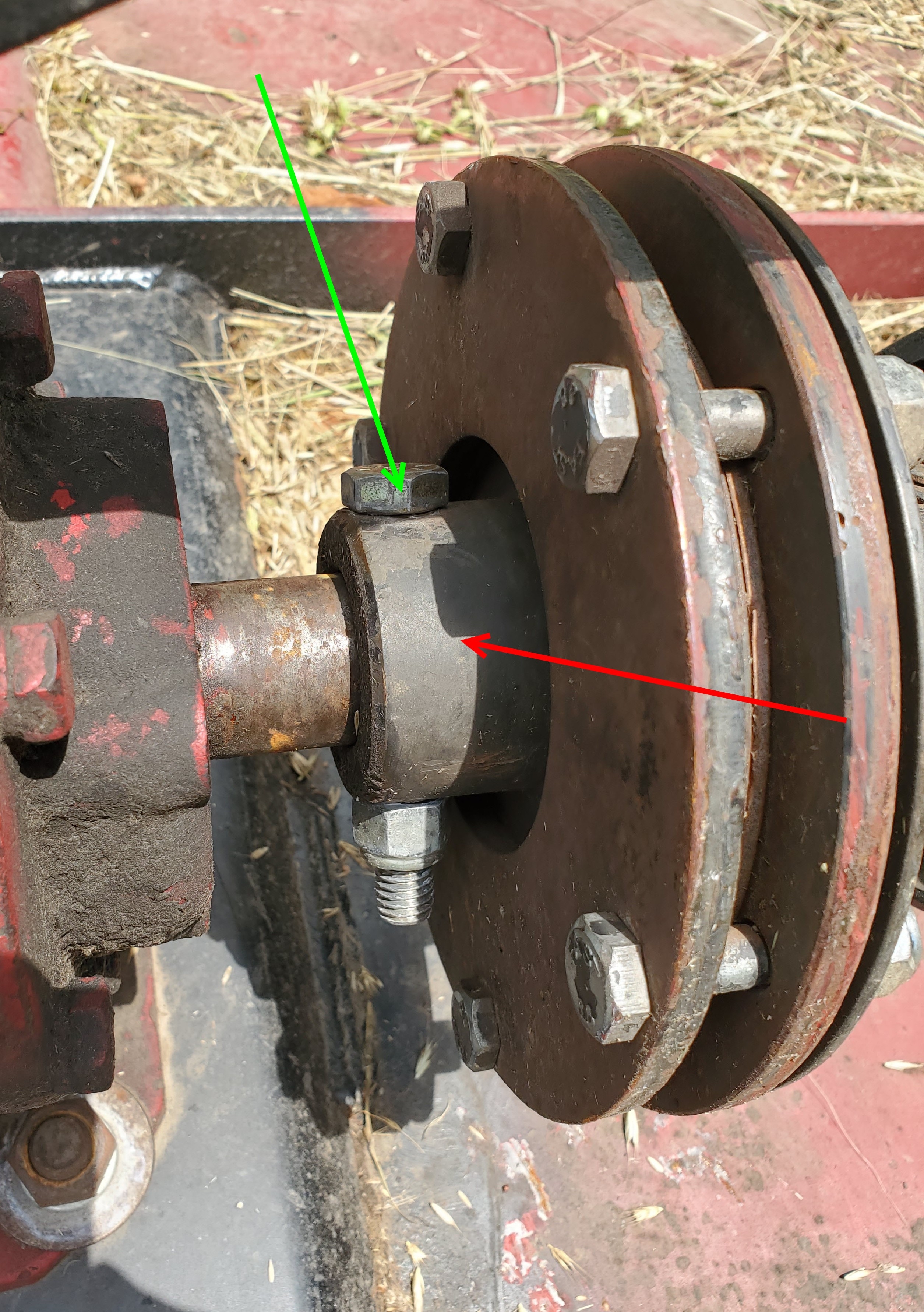

/ PTO Shaft to Gearbox Bolts Keep Breaking! #64
It is a pretty standard setup.
In the picture the bolt in question, green arrow, holds the PTO saft to the input shaft on the gearbox as you might assume!
You can tighten this bolt as much as you want and it will not make the collar, red arrow, on the PTO shaft any tighter on the gearbox input shaft.
Tightening the bolt simply keeps it from sliding in the holes. It does not "clamp" anything in place.
Now, on this type of setup all of the driven force from the PTO shaft is transferred to the gearbox input shaft via that bolt. The input shaft nor the PTO shaft are splined in this case.
I can see why they recommend a grade 8 bolt there. I'm thinking that bolt is to retain the clutch hub to the shaft, not a shear bolt, as that is why the clutch is there. If the clutch is functioning, something ODD is going on to break the bolts. Take a picture of the pto shaft for us to see.

Do you have more photos of the slip clutch, the other side? Are there springs on the other side?
This one does not have springs on each bolt like some do. It has a spring plate called a Belleville spring. It does the same thing as the individual springs do, it applies the pressure to the clutch disks.

Thats a big boss on the clutch collar.
Now bolt photos make a bit more sense and they do not look like shear failure.
The break is not at either of the two points of shear, but outside the collar under the nut. And there are 2 mysterious untouched lands at the shear points. possibly due to previously yielded material around the shear point. But no bending in the bolt photos so not an issue now.
Cannot imaging what knocks the bolt heads off. Nice some more photos of the driveline arrangement. Also the grain at the fracture. Nuts would be great too but guess never find them.

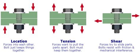

For accurate shear limiting , the bolts need be loose. Tightening only introduces additional load ability via friction (& not a consistent value for this joint example: could be zero contribution ) at the expense using bolt strength needlessly.
The example cited earlier post here was for a bolt loaded in tension, not shear.
I disagree; my guess is that the geometry is:
@wirlybird can you post a pic with an unbroken bolt in going through, and one of a broken bolt in the hole?
My guess is that the bolt near the cap is about the right diameter, but the hole in the shaft is larger which allows the shaft motion on the bolt shoulder, and then the other edge of the collar is over threads which are very much not the right diameter (well not after you run it for 5 seconds).
Most likely the mismatch of the shaft hole and the collar hole sizes is mostly ok, but the collar being over threads is definitely going to do the bolt in

That's really close to where I'd expect a shear with the threads under the collar.
I mean, I'd expect it to be right at the blue/green joint, but hey close enough.
I'll bet if you found the other piece of the bolt the threads would be mashed to smithereens and strangely the fulcrum is at the transition from one diameter (mashed threads) to another (bolt shoulder); it's probably been flexing back and forth at that spot, aided by the shaft hole being slightly larger.
Not a pure shear break so much as a work-weakening.
Just get a bolt with a longer shoulder and be done with this.

My rotary cutter has a 1/2" shear pin. When it breaks, it shears neatly at both the top and bottom (flush with the shaft). What's left of the bolt looks unmolested. Your bolts look like they've spent 10 rounds in a cage match. There's a whole lot of shaking going on (and I don't know why).
/ PTO Shaft to Gearbox Bolts Keep Breaking! #79
Does it matter which side of the collar you insert the bolt head in - i.e. is the bolt head always on the right, or is the orientation of the shaft, collar, and bolt head random?
Also, it looks like the bolt is spinning a lot in the hole. It "machines" a step on one side, and a groove on the broken side. Not sure what that means.
/ PTO Shaft to Gearbox Bolts Keep Breaking! #80
^^agree. That bolt is doing a bunch of gyrating in the hole somehow. ....and why?
