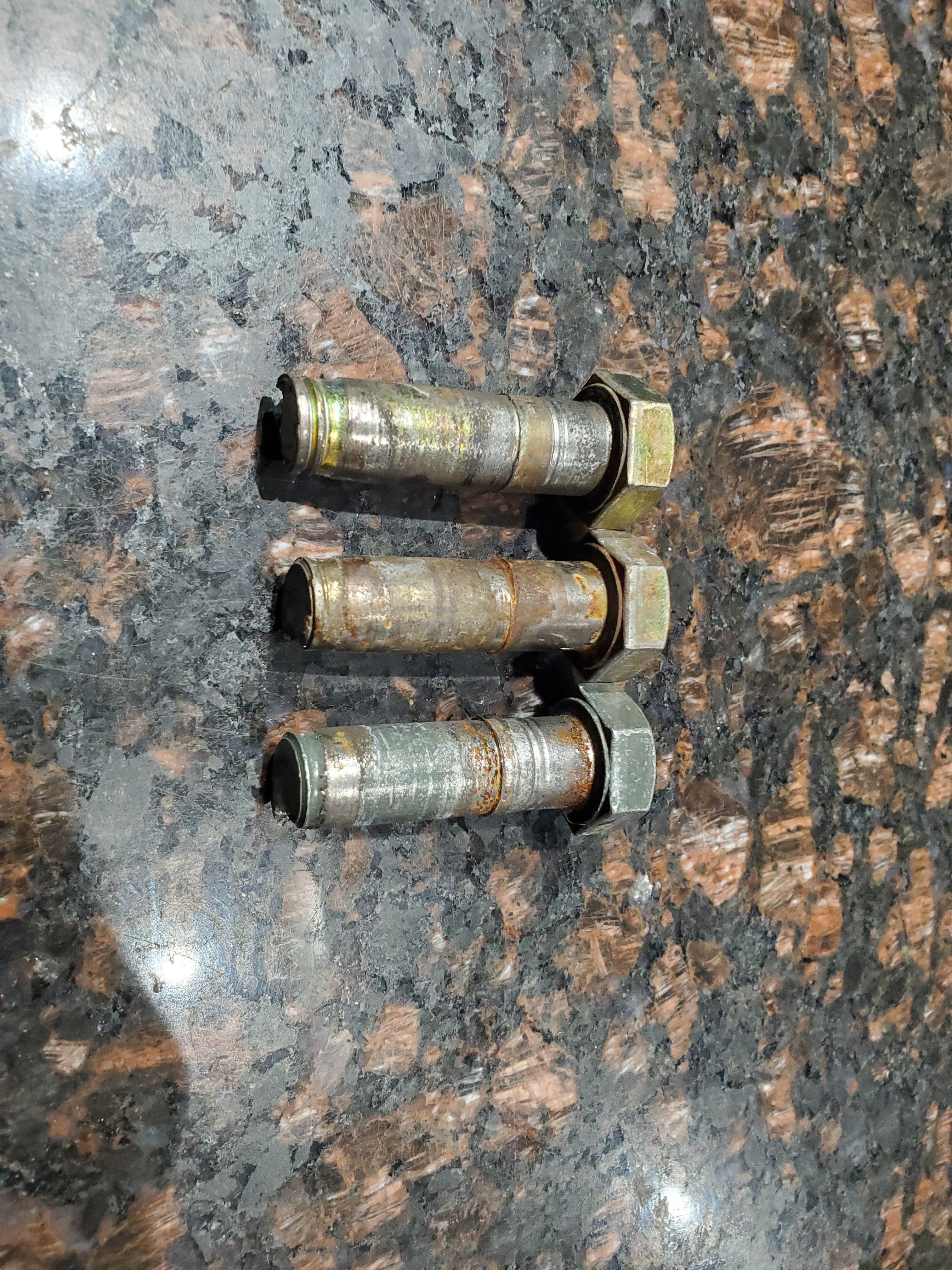

From the posted pictures it appears as if only one end of the bolt is taking the load. Normally a shear bolt shears both ends and leaves the center of the bolt in the shaft with the ends being "lost". Are both holes in the yoke the same size, or is one slightly larger? As for tightening the shear bols I have always tightened them tight and "given them another turn" as the old timers would say. Figuring the extra squeeze put on the yoke would take some load off the bolt and reduce any "hammering".

Based on the photos, those bolts have taken some serious shear forces.

That is the thing, they haven't as far as cutting goes. As mentioned, I am cutting field grass, maybe 2 feet high, on flat smooth land. It's just early spring growth, nothing even heavy.
The cutter doesn't hit anything, it doesn't bog down. No indication of any big shear stress. That is what is puzzling.
These bolts are breaking after 6 or 7 hours of cutting. Some of my other cutters will go the whole summer without breaking a bolt and some of those are being used in quite rough areas.
One thing is that the bolt is only breaking on the thread side and not shearing like you might expect from a typical shear force incident.
Once the rain quits I am going to pull the shaft and inspect the bolt holes and see if I can find anything.
Also am going to change to another PTO shaft and see.

As mentioned earlier, it looks like the bolts have been "rattling" in their holes, until they give up due to the shear forces. Work hardened if you will.
I don't think it's one "shear force incident", but repeated abuse from not being tight.
Could be but I do tighten so snug, no play, I just don't crank them down!
I agree they are getting banged up some.
Going to pull the one that is in there and see how it looks. It has about an hour on it.

Note that if you torque a bolt down, it gets narrower as it stretches, so a snug bolt gets slightly less snug and is more likely to get pounded. What is the point of torquing a shear bolt? We're looking for shear, not tensile, and I think torquing it is going to reduce the shear strength.
Shear bolt should have a nut on it to keep it in, but it doesn't take much. I use a nyloc and have a few extra on hand, though not as many extra as bolts, since I usually can sometimes find the old one.
IMO the bolts are getting hammered because they're too small at this point for the hole, for whatever reason. Increase the bolt size (like go the next slightly larger metric) and ream the hole out to so that whatever goes in is tight; make an effort to have the shoulder go all the way through; if the shoulder extends beyond, don't care, just snug the nut on it. *if* the bolt moves during the spin (I strongly doubt it will if it's not way too small) it's going to either have the cap against or the nut against.
All very good points and I have to agree that tightening the bolt more than bolt head and nut touching the shaft collar doesn't accomplish anything. You certainly are not clamping anything down.
Going to be looking at hole size vs. bolt size at this point.
