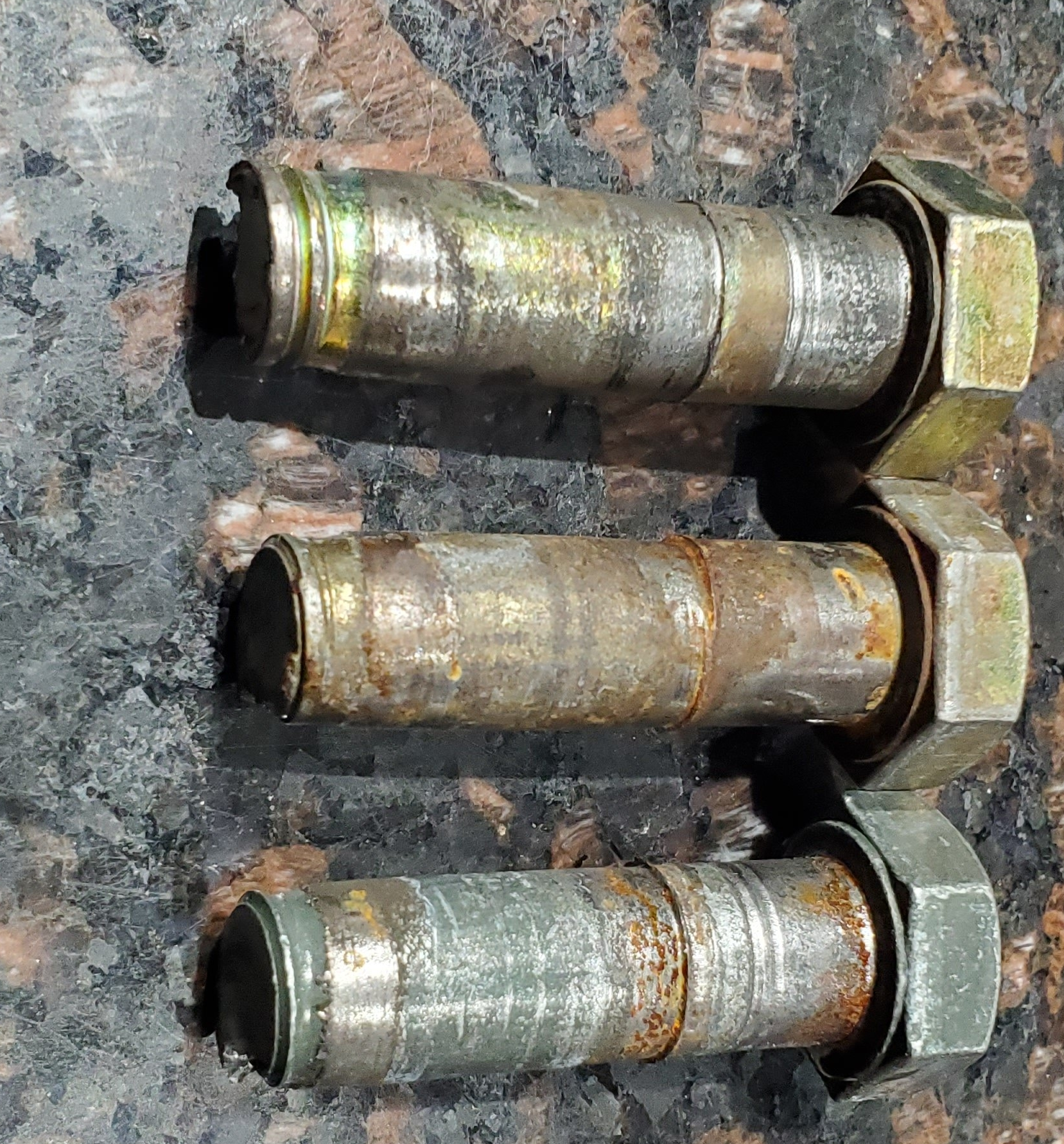

But your other cutters might be SAE, not metric. 13 mm is .512 vs your .500 bolt. .012 clearance/hole is .024 total slop. (Actually, more clearance than that because rolled threads have undersized unthreaded sections.)
If not, and from your pics, Id try the next bolt length up that has a longer unthreaded section, even if have to saw off the extra threads.

Here are the last three that broke. 2 grade 8 and 1 grade 5.
This is a lighter duty cutter and I don't push it hard. I engage and disengage the cutter with engine RPM at about 1500.
I use it mainly for doing fields that are in good shape and just cutting the field grasses.
Most of the time it is areas that I do about once a month to maintain. Next step would be a finish mower or mid mount and mow a little more frequently, but the customers don't need it cut that often.
all 3 bolts show signs of slop hammering especially the one in the middle. You can see the mushroom where the collar meets the shaft. But all three have a wear shoulder at the collar/gearbox shaft junction.
